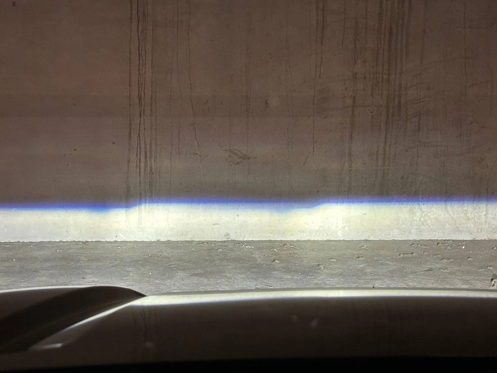

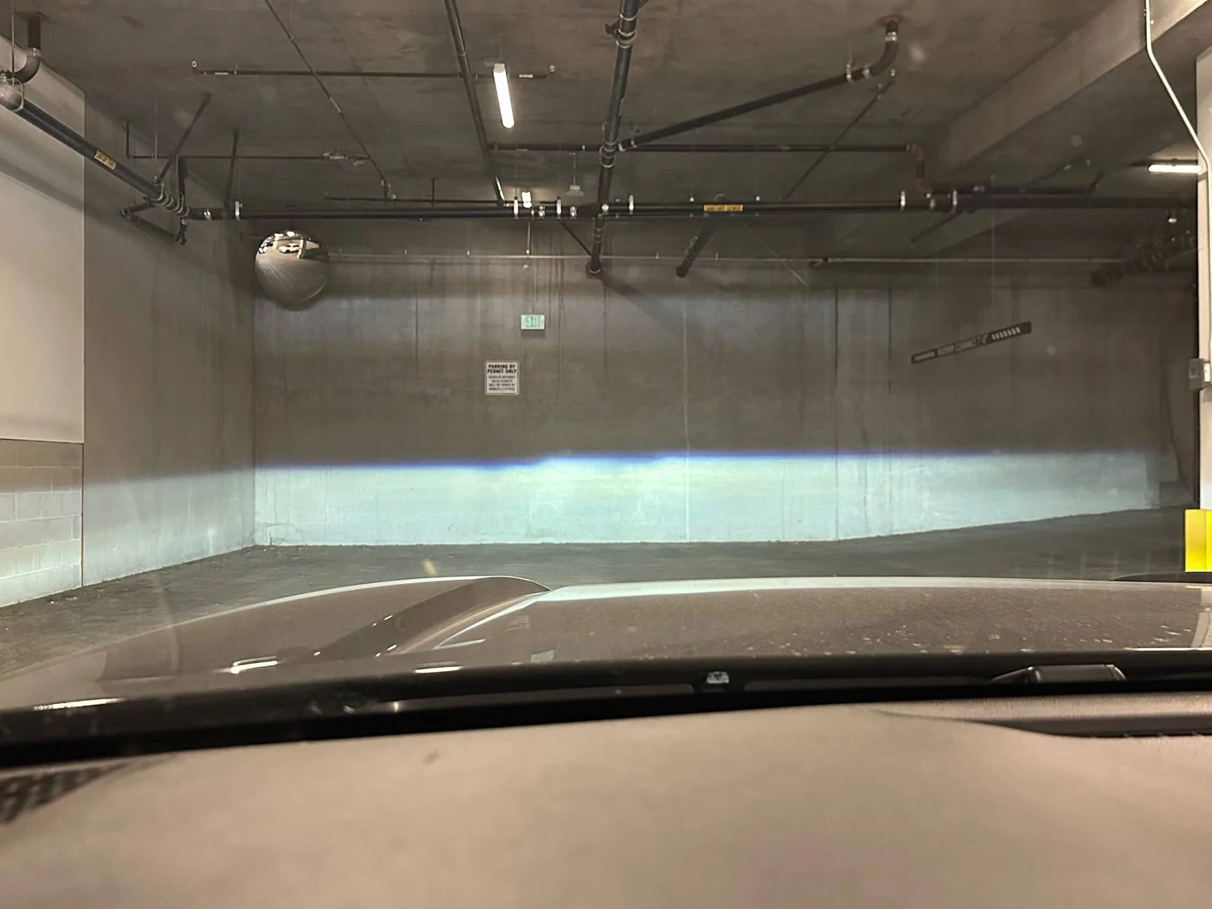

I noticed that the headlight beam does not project in a flat line, but instead has a bit of a jagged appearance. The right side of the beam is clearly higher than the left side, and there's some weird asymmetric ridges slightly left of center.
I’m not sure if this is some design quirk to look like mountains or something, or if the headlights are misaligned.
Do anyone else’s headlights look like this (basic non-TRD Pro headlights)?

My 2021 does the identical light cast
63
2,683
1,523
toyota has stepped the headlights for a while now mostly on led's.
driver side is usually lower than right side but its only a slight step when you are at 25-50 ft from a wall.
our 23 tundra has the same stepping on the headlights.
i even stepped my 14 4runner led headlights when i replaced the oem halogen bulbs with some lasfits drop in replacements
