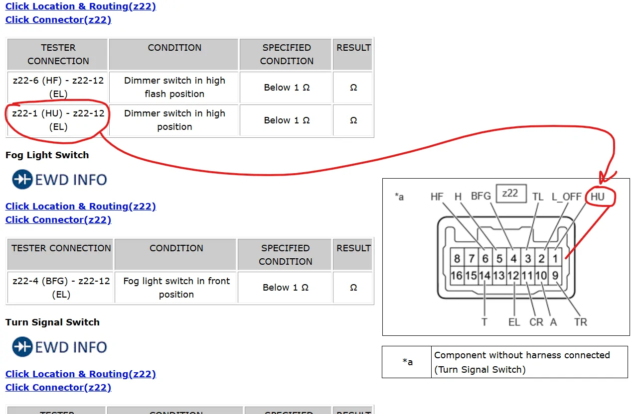

all I got is
the connector in the dash... z22.. (first pic) for the turn/high beam stalk
(first red line from the left side of pic)
and the pin that is activated (1) in that connector (second pic)
when the high beam switch is on (pushed forward)
Just thought I would let everyone know, trying to tap into this wire for either a +12V signal or ground signal to trigger a relay might be doable, but be forewarned....

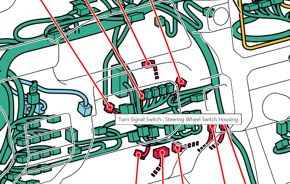

The diagram is misleading. The connectors are actually located far up in the dash behind the main instrument display. Getting reasonable access is going to involve major disassembly of the dash. I'm going to keep it in mind as a LAST resort, while seeking a better way.
Thanks again to 127.0.0.1 though. It should be possible, but I would almost rather pull an engine than tear apart the dash in a brand new car.
