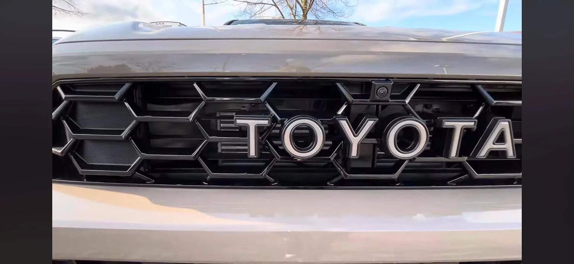

Waiting on my TRD Pro (should be delivering next week) and it has Front TOYOTA Matte Black Overlays. I saw another video that showed Front TOYOTA Mudbath Overlays and I’m not a fan of the look. We’ll see how the Matte Black looks but I’m betting I’ll take these off or if that’s not possible, just get a Pro OEM Grille or paint match on an OEM Grille like the video.
Here are the front TOYOTA Mudbath Overlays
