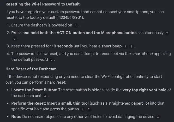

Yesterday, when I started up my Trailhunter, the Toyota Dashcam starting flashing lights and beeping. I tried to connect via the network, but there wasn't one available for the dashcam.
Is there a way to reset the dashcam by pushing a series of buttons? I cannot seem to find anything on line.

You can long press on the wifi icon until the blue light starts flashing rapidly. That should be broadcasting the wifi signal for your phone to see.

Thanks! I connected and was able to reformat the sim card and it now works!
