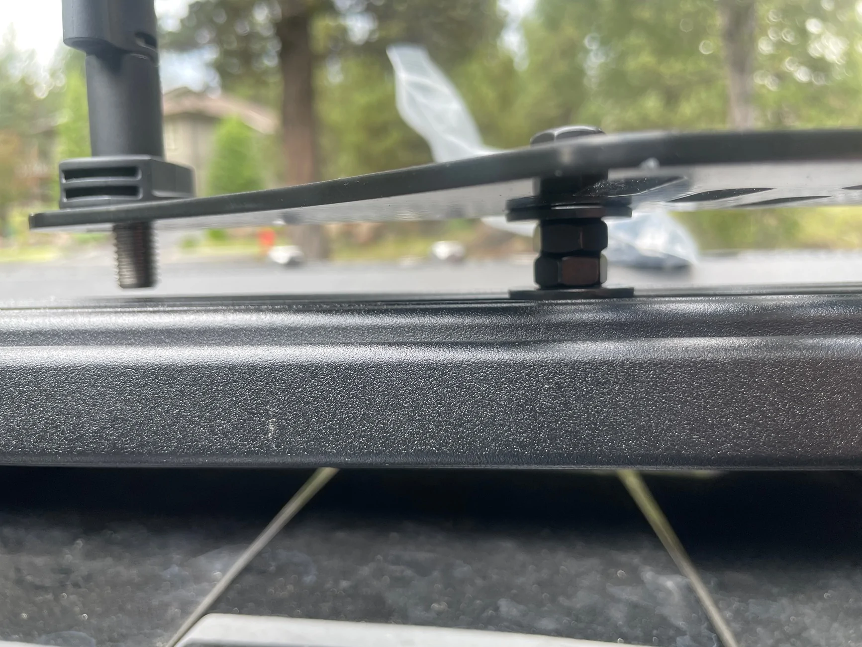

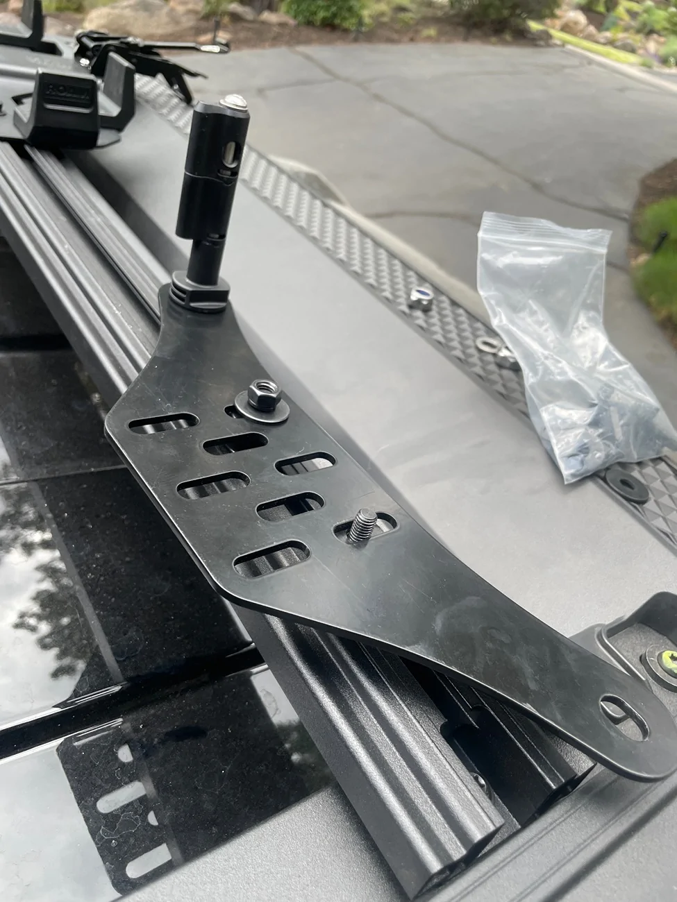

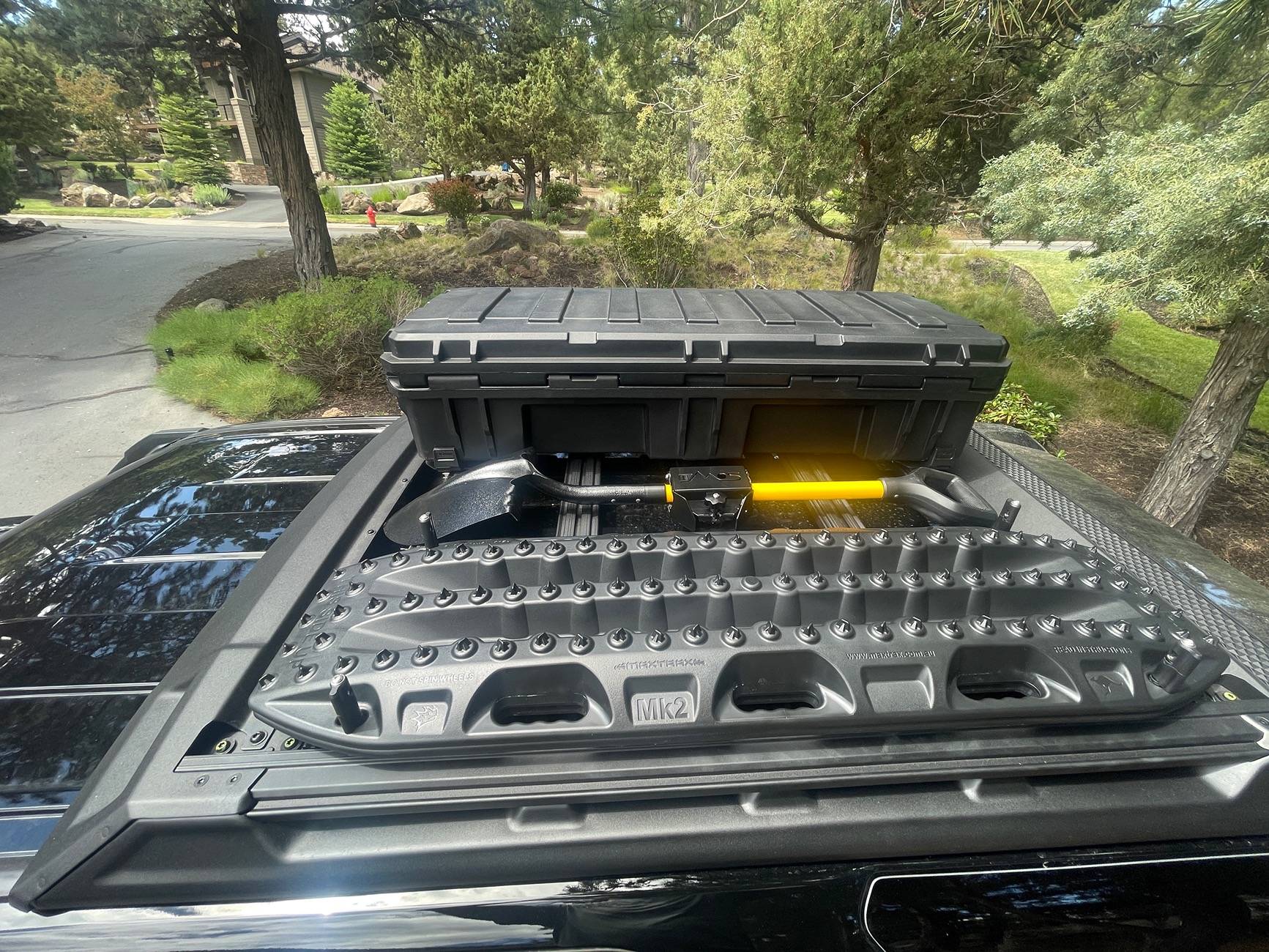

I use these mounting base plates:
https://www.amazon.com/dp/B0CTB9SSBX?ref=ppx_yo2ov_dt_b_fed_asin_title&th=1
I had the same issue with the mounting pins being a bit too far apart and I therefore had to 'float' the base plate a bit higher than the rails so I could get the ideal position. If I didn't 'float' the base plate, the mounting pins bolts just 'collided' with the rails so a flat mount option wasn't going to work.
This worked out great and has held up very well over hundreds of rough miles off road.
It's also worth noting I had to purchase the missing cross bar (there is another thread about this) for it all to work.

Weren’t the m6x35mm too long for the roam mounting bracket? They would rub against the bottom of the box, i went w 1”nuts n bolts from HD
rule5
Rob
Jul 9, 2025
Oregon
I had forgotten about that. Yes, they were too long so I cut them shorter with a Dremel.
I was hoping to find something more solid but that works
