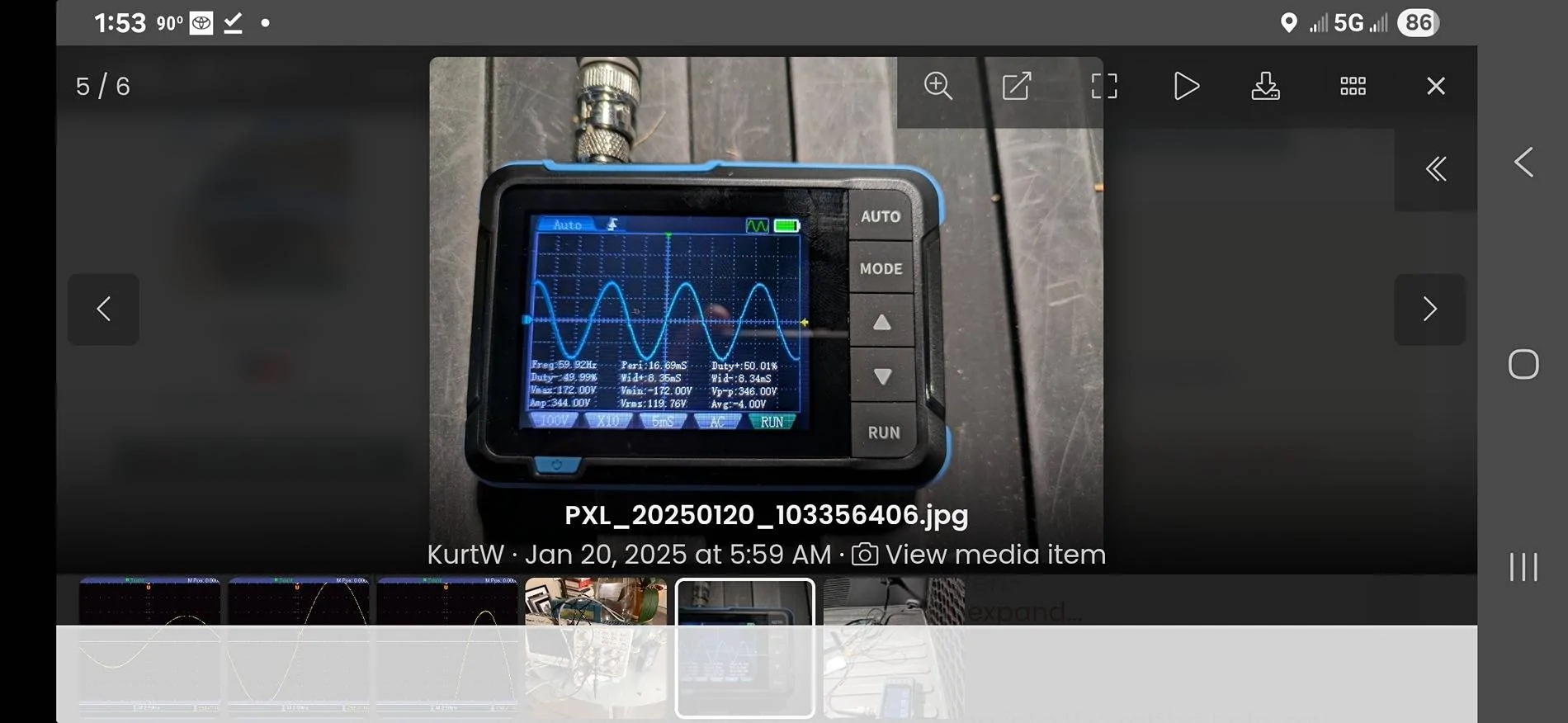

the 2400 watt is pure but the 400 watt base is not. Not my picture but it is the 2400 inverter/converter.
Hmm...when I called Toyota customer service a while ago and posed the question to them I was told that the inverter put out a square wave.
When you say "but the 400W base is not" I don't understand. Either the inverter is producing a sign wave from 1 watt to full load or it isn't.
jimmyzshack
TRD Off-Road
Jimmy
May 1, 2025
25
Houma, LA
2025 4Runner TRD Offroad Iforce Max, 2004 GX470
Non hybrid has a 400 watt. It is not a pure sine wave
kzrman
Apr 13, 2024
23
310
230
Maine
2025 Trailhunter
I understand now. I'm talking about the inverter that is in the hybrid models.
I'd love someone that has a hybrid and a O-Scope to give me a second opinion.

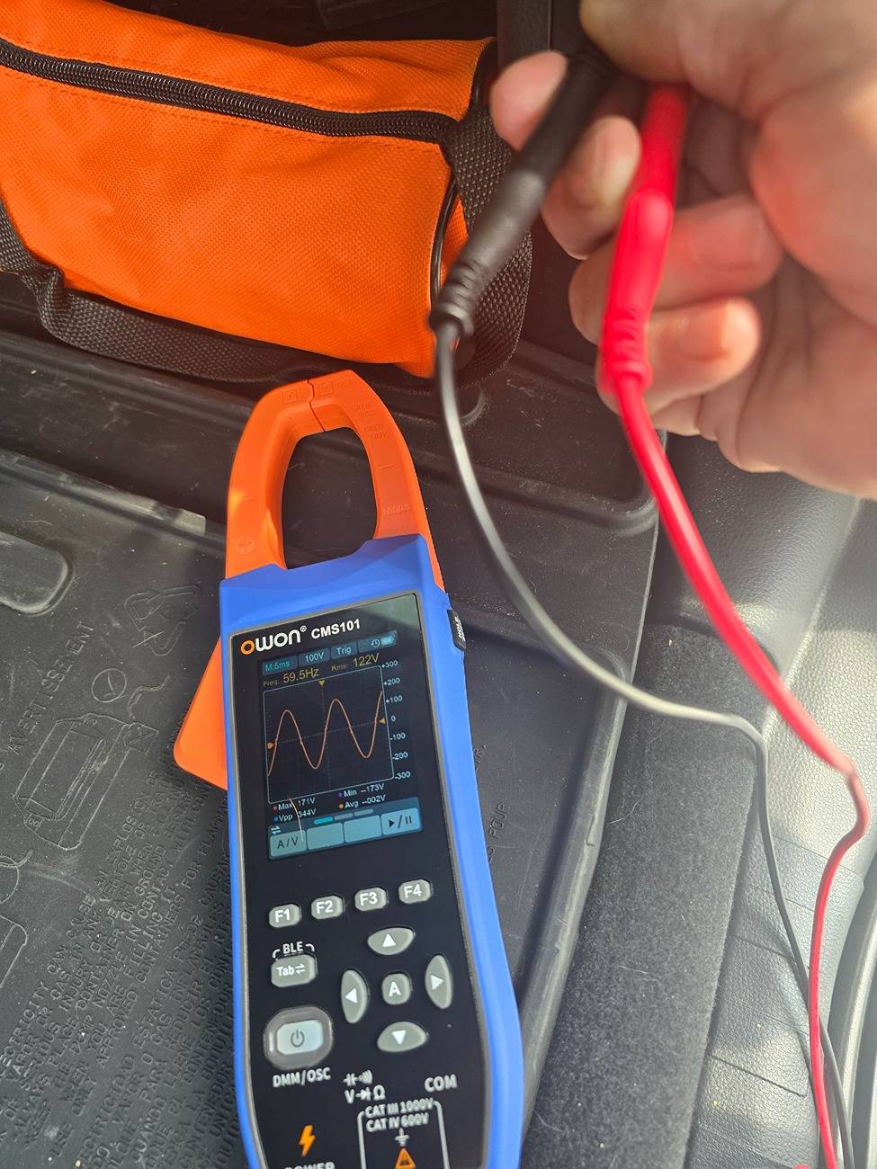

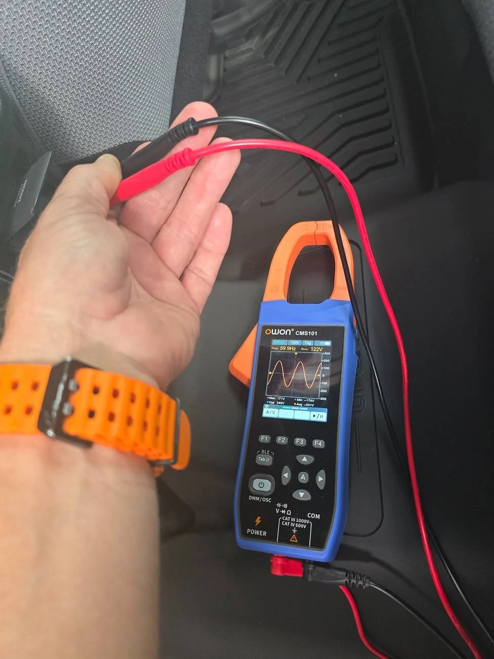

kzrman
Apr 13, 2024
23
310
230
Maine
2025 Trailhunter
Here are pictures from the back seat and rear outlets
I really appreciate you taking the time and trouble to make this measurement. It relieves my mind a lot to know that the inverter is producing clean power. How do you like that instrument compared with others? I'd love to get a O-scope but for my occasional needs I can't justify the cost.
