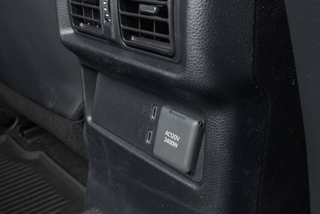

I've got the TRD ORP iForce Max hybrid, which offers 2400W AC power outlets in both the second row center console and in the rear cargo area. This was a really appealing/important feature for me, as I want a way to charge my devices and power my portable electric refrigerator.
2025 2026 4runner 6th gen The 2400W DC-AC Inverter is loud AC Outlet
I'm finding that when there's a significant draw on the AC outlet, a REALLY loud fan noise kicks in — presumably coming from the DC-AC inverter, and it sounds like it's coming from the center console area between the driver and passenger seats. I've included a link to a video which illustrates how the sound clicks on and ramps up. This is happening with a device drawing 500 watts (well below the 2400W rating of the outlet). It doesn't matter whether it's plugged into the second row or cargo area outlet. Same result either way.
Can anyone else test/verify what you're seeing? Wondering if it's a defect, or if that's just how it is....
The manual does say, "while a power outlet is being used, a cooling fan sound may be heard from near a luggage compartment. This does not indicate a malfunction" but this is *REALLY* loud and doesn't seem normal to me.

I can confirm it's normal, I have an Ecoflow Delta Pro and tested the 2400w inverter by charging it and WOW that fan is loud. Both in our Tacoma and 4Runner it was the same, It was charging at 1700w. If it wasn't in the center console I don't think it would be as bad.

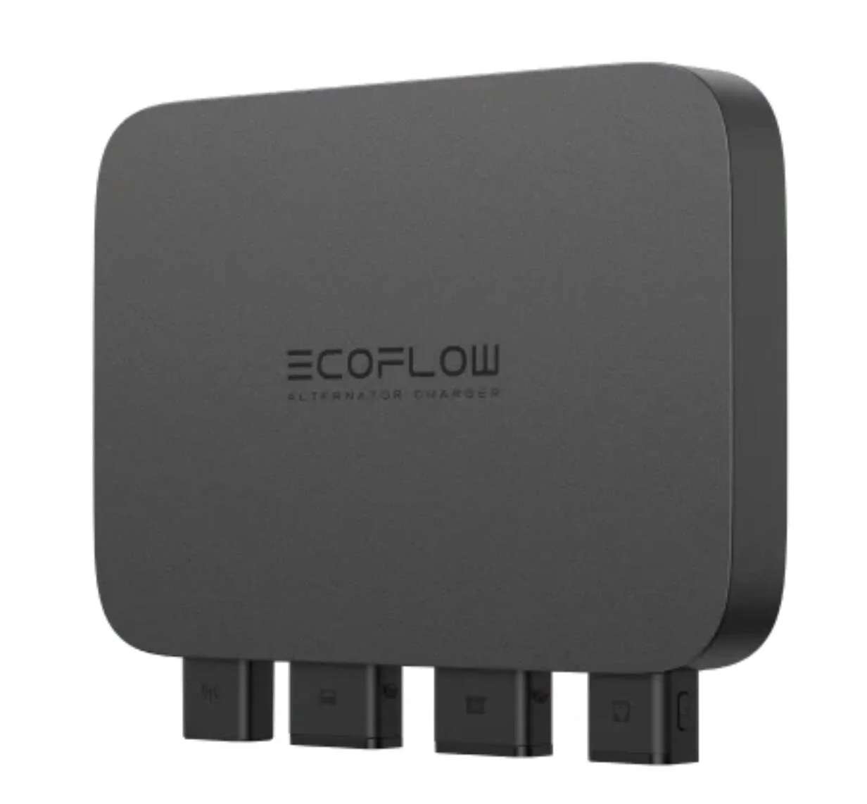

@CMill4Runner - I'm trying to charge an EcoFlow Delta 3 Plus power station, so I have a very similar use case to yours. I am seriously thinking about just installing one of these EcoFlow 800w Alternator Inverters and skipping the Toyota 2400W inverter entirely. They are on sale right now, and I picked one up yesterday. I confirmed with EcoFlow that they don't have a fan and make no noise at all.
