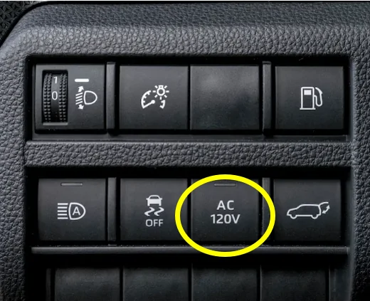

I am looking for a way to get the power outlets to be ON everytime I start the engion WITHOUT pressing the "AC 120V" botton? I stop for gas and other things while I am driving. Then I forget to turn the inverter on again for a hour or so after I am driving again. I want it to say on so it keeps the electric ice chest powered while I am driving. Anyone konw a way of doing this????

Just need to find key on power near the switch and wire it up.

wanting this so bad because currently we have our back dash cam wired into the plug in the cargo and have to remember to press the button every single time and i don’t want the time i forget to be the time that we get rear ended and have no footage 😭

Depending on your fridge, I would just go a different route and make your life easier. I have the Iceco Vl45proS, and it pulls 4.5a when the compressor is running. That's just a little more than 50w, def not something you need a 2400w inverter for. If your fridge has a 12v input option, I would just get a switched power 12v cigarette lighter socket and hook it to the battery and a trigger so your fridge doesn't kill your battery. Cigarette lighter sockets should all be rated for 100w

Alternatively, you can get a 50-100Ah LiFePO battery and an A/C charger for it and run your appliance from the LiFePO. Connect the charger to the 2400W outlet, and if you forget to turn it on when you get back in from a stop the battery will supply power to that and any other appliance you might have.
That is what I do. And I use a Victron A/C D/C charger.
