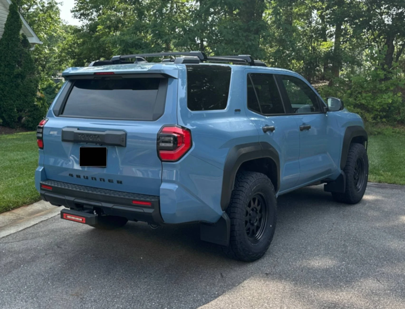

Does everyone's rear spoiler feel like its loose? Mine is not ridged and has lots of flex.

Def have questioned the spoiler quality myself as it gets squeaky whenever i press down on it. Outside of that I haven't worried too much about it since it does feel pretty bolted down.
Went through the carwash once already and didn't have an issue

They don't feel "solid" but definitely doesn't feel like its going to fly off like the front air dam, but there are some people who are having rear spoiler issues (flying off). Also the previous gen is the same so I heard.

This install video for the Westcott Designs rear hatch ladder shows the removal process for the rear spoiler, and gives you a better sense for how it's attached. After installing this ladder on my 6th Gen, the wing feels *much* more solid and doesn't have nearly as much flex and squeak. The ladder adds a lot of structure to it, and feels absolutely solid.

Thank you, I checked the bolts and they are all snug. Not sure why it feels so floppy, maybe it needs some rubber shims.
