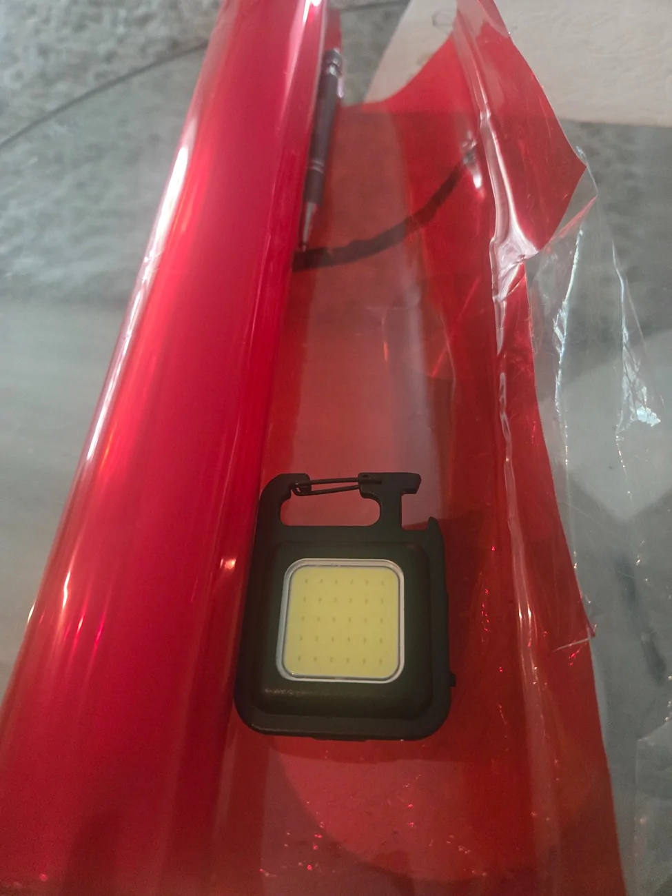

What I did on my 5th gen was take some of this red film and pop the clear lens off and cut a little piece to put behind it.
The red light is better on the eyes and in the dark.
Then to back it up I have these little rechargeable LED lights that are crazy bright; two of them will literally light up the entire back of the hatch area.
5th gen you could change the bulb to red,yellow or bright white. Good luck

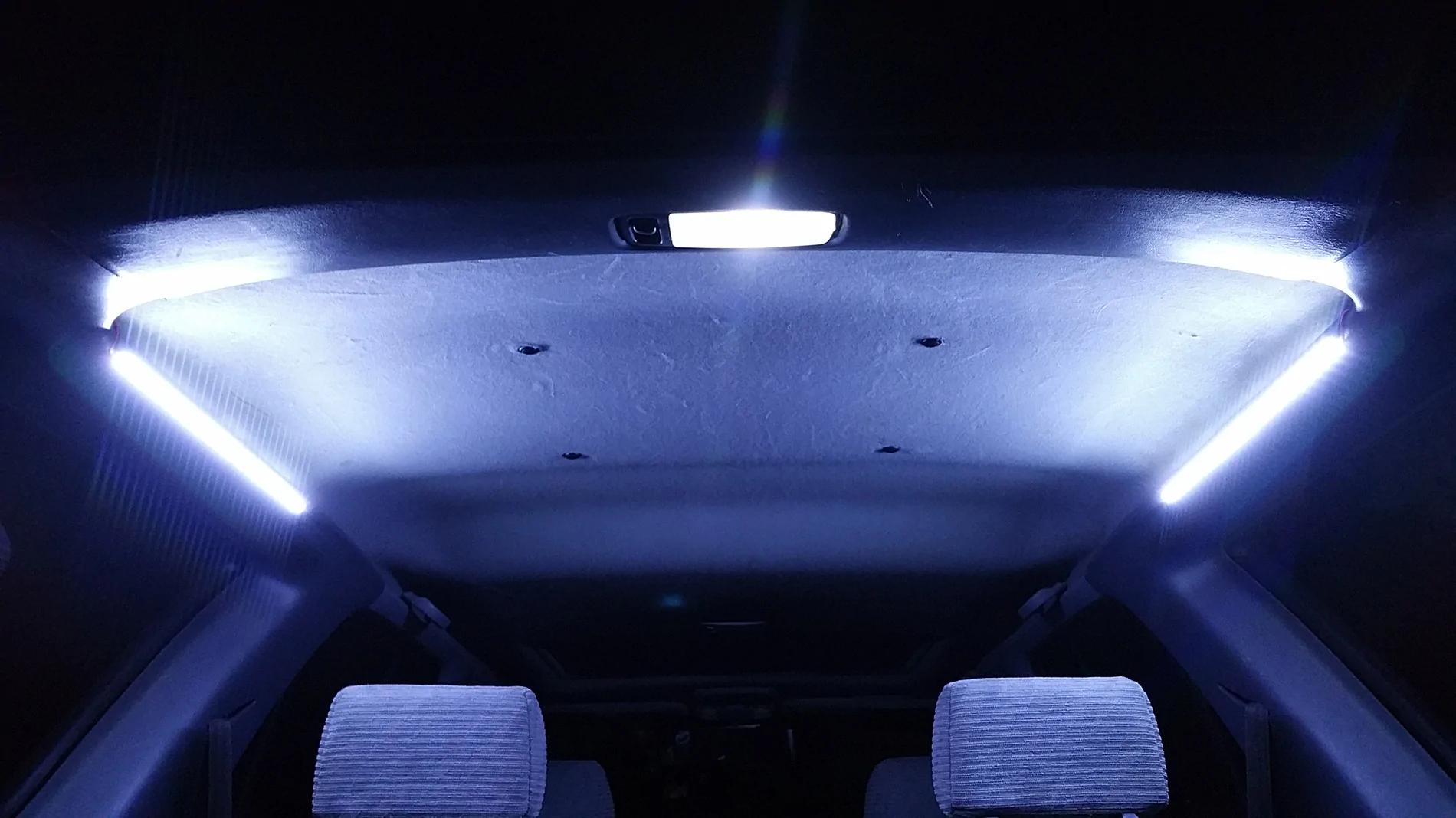

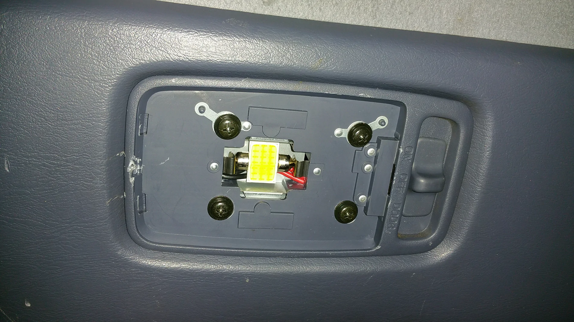

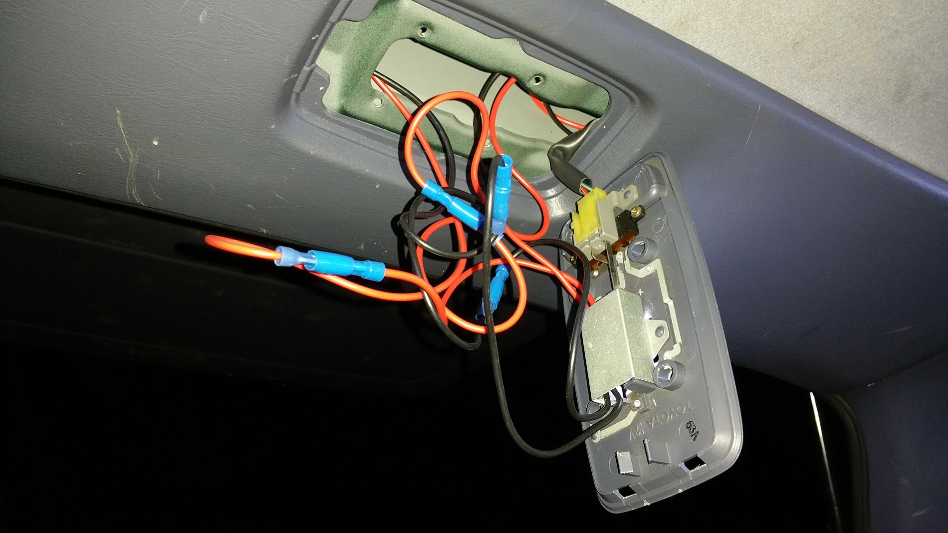

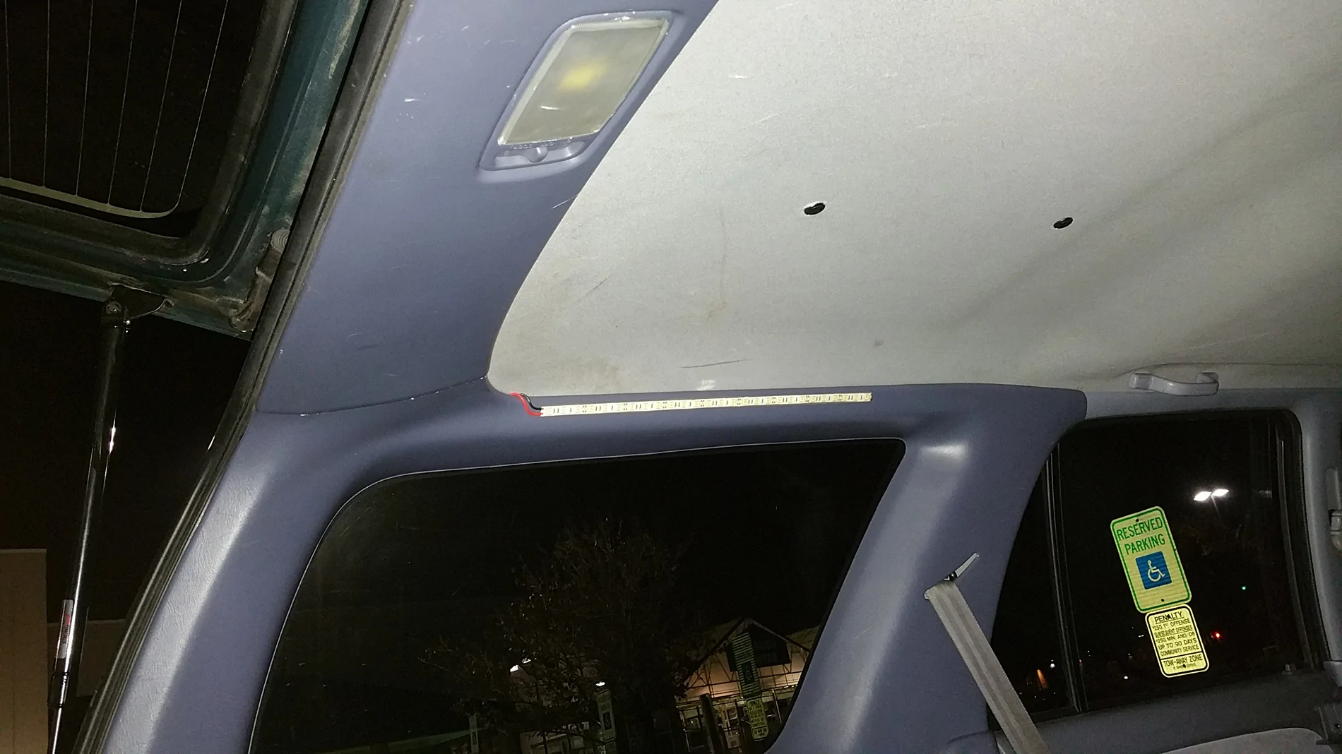

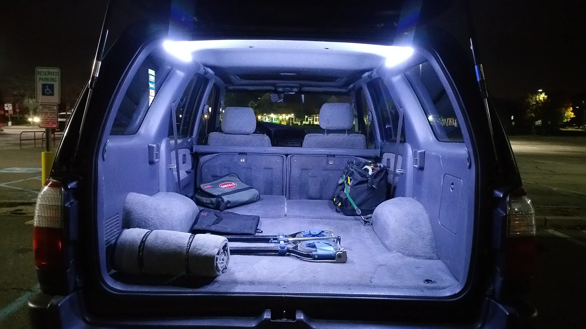

What I did on my 3rd gen:
Bog standard generic ebay led strip that came on a big spool, except I rubbed off thejunk adhesive it came with and used 3/8 vhb.
Wired to a replacement led bulb with banana plugs so it's still removable and didn't touch the trucks wiring, and it has this incredible invention called the on/off/door switch.
I loved this setup every day since I did it. So nice not to have shadows right on what you're trying to work on or dig through. Well I still love it I guess since I still have the truck but the frame is rusted and I've taken it off the road but just haven't disposed of it yet. It's just hard to say good by because it's manual and 4wd and has no turbo and no internet connectivity. I wish I could have a brand new manual 3rd gen.
Well that's nice and bright ! Yeah I probably miss my 3rd gen the most. But technology has moved on..
