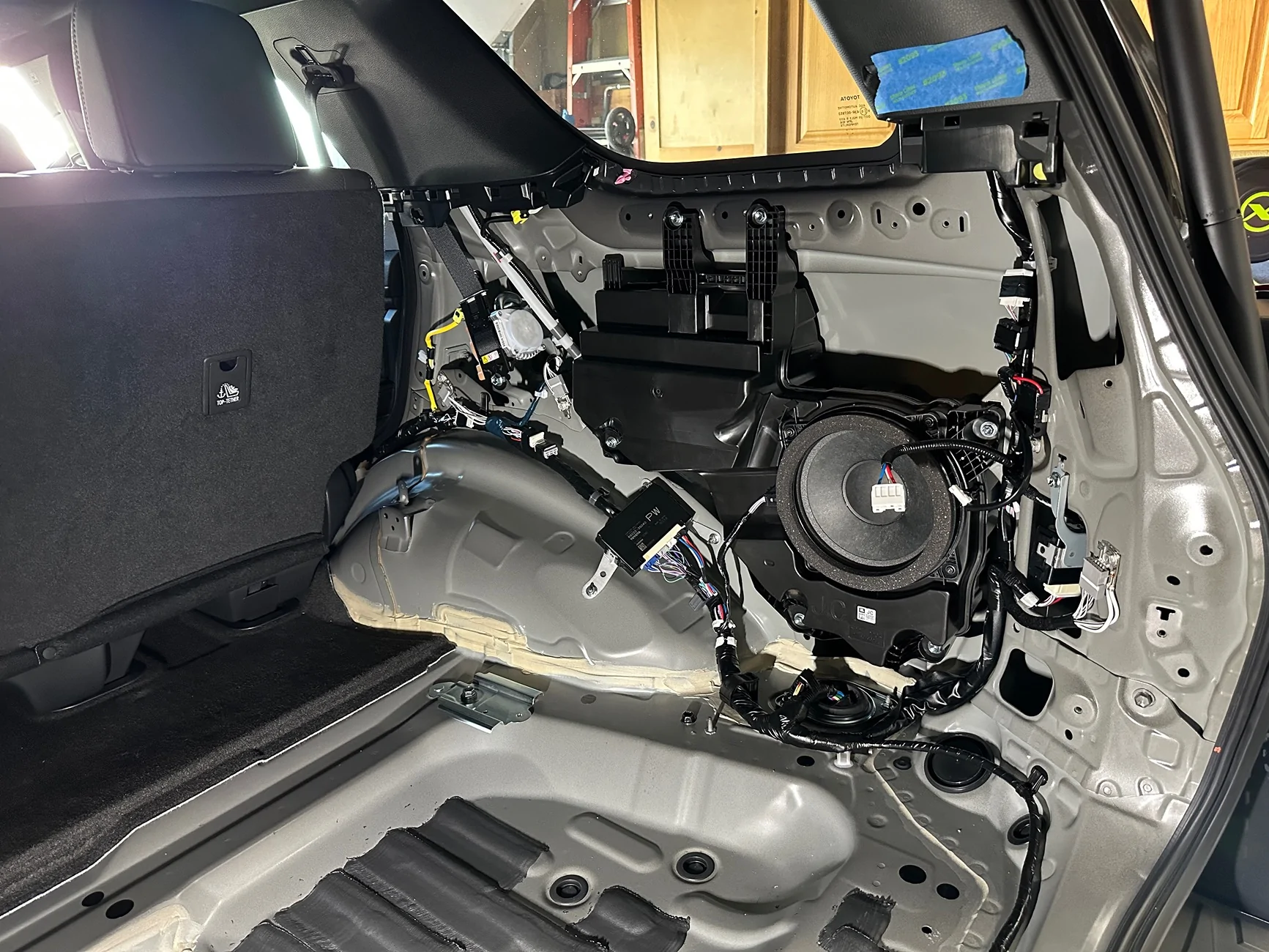

1) Is there a similar workaround to the 5th gen by means of a wire harness?
2) Any YouTube videos for the 6th gen on this topic? I couldn’t find any. On the 6th gen even if there is a harness available, it looks like the entire rear panel needs to be removed to access the inverter.

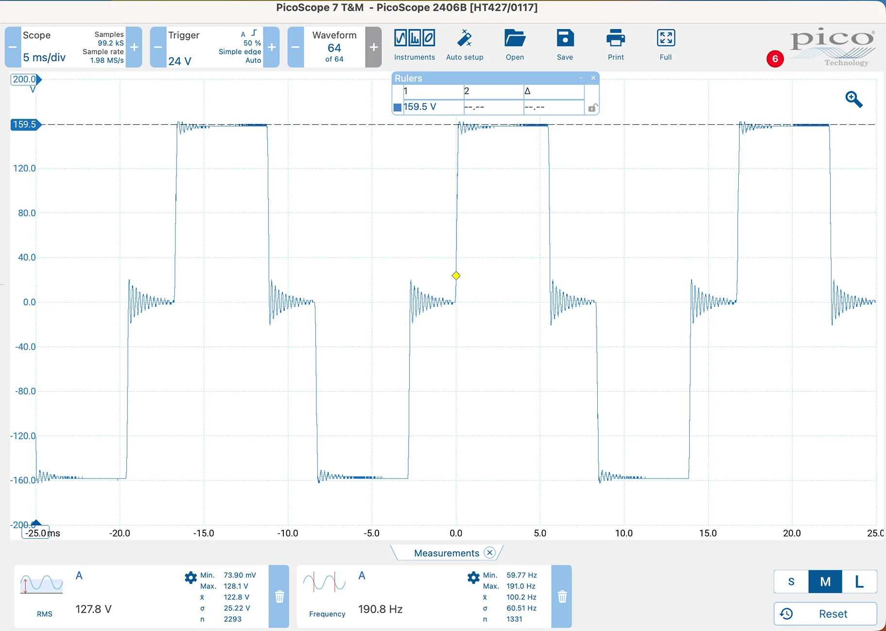

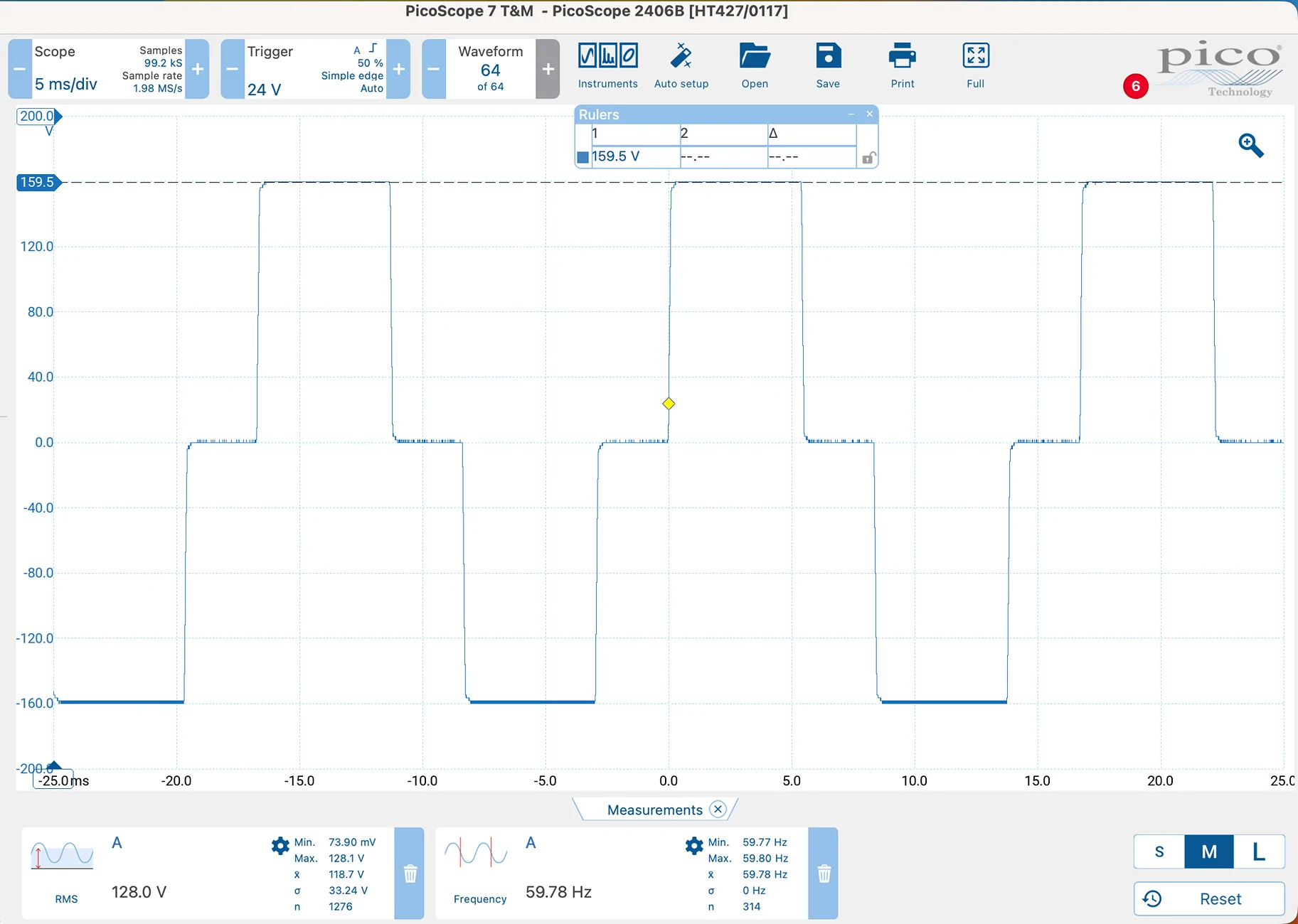

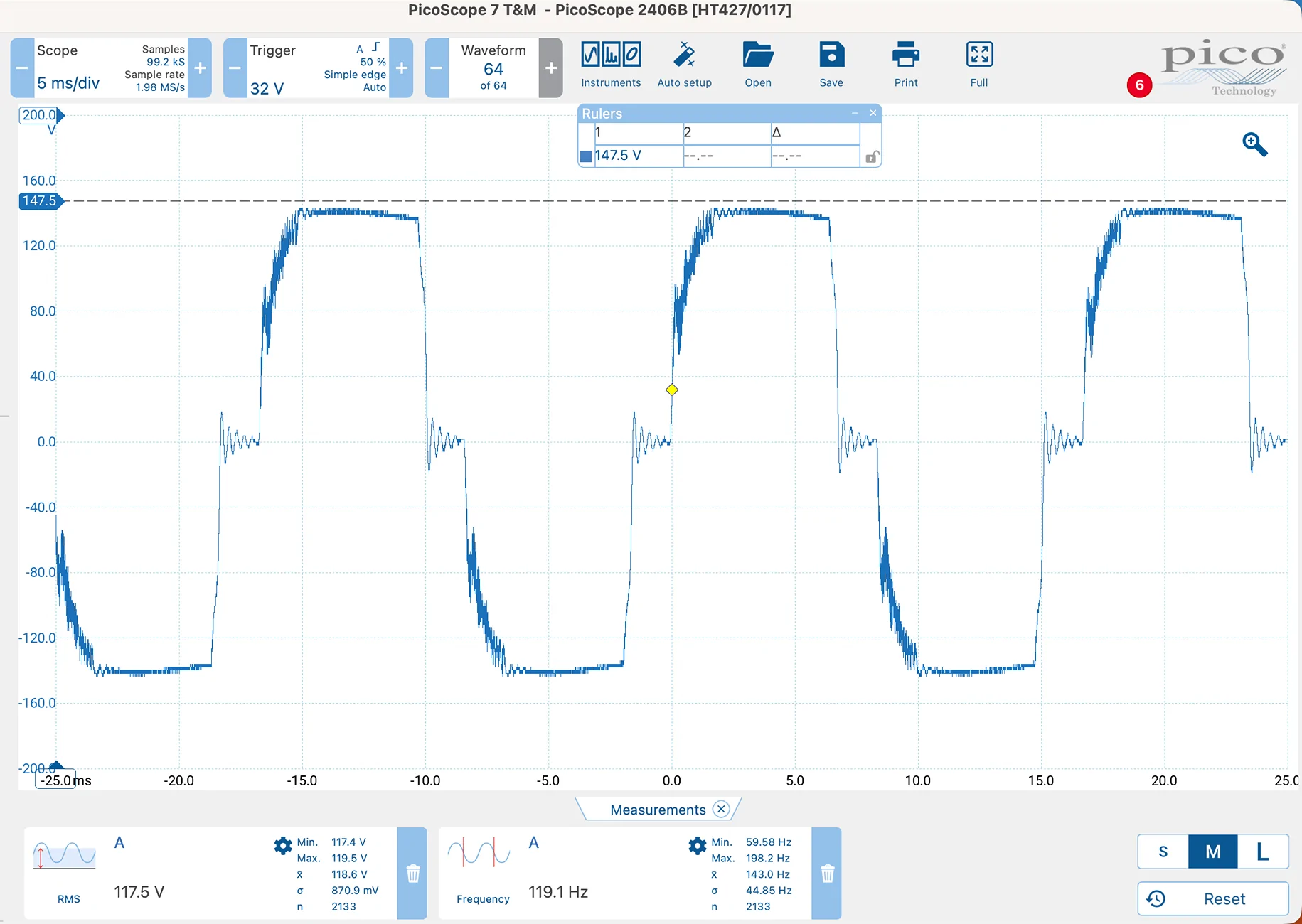

As an FYI see 4 scope pictures below.
1st pic: Outlet floating
2nd pic: EcoFlow Delta 2 max, no load
3rd pic: EcoFlow Delta 2 max, 200W
4th pic: EcoFlow Delta 2 max, 300W
Bad news for EcoFlow, the lowest max charge 200W. So while driving it won’t charge from AC since the outlet is limited to 100W. The only option is to charge from 12V which sucks, since it’s limited to 100W, and no 12V socket in the back.

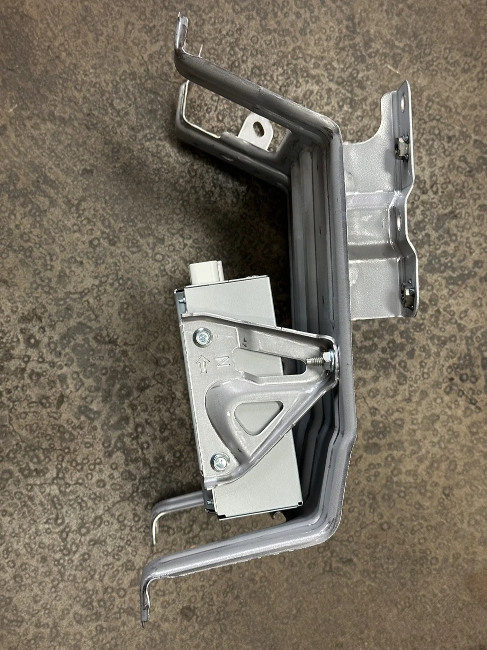

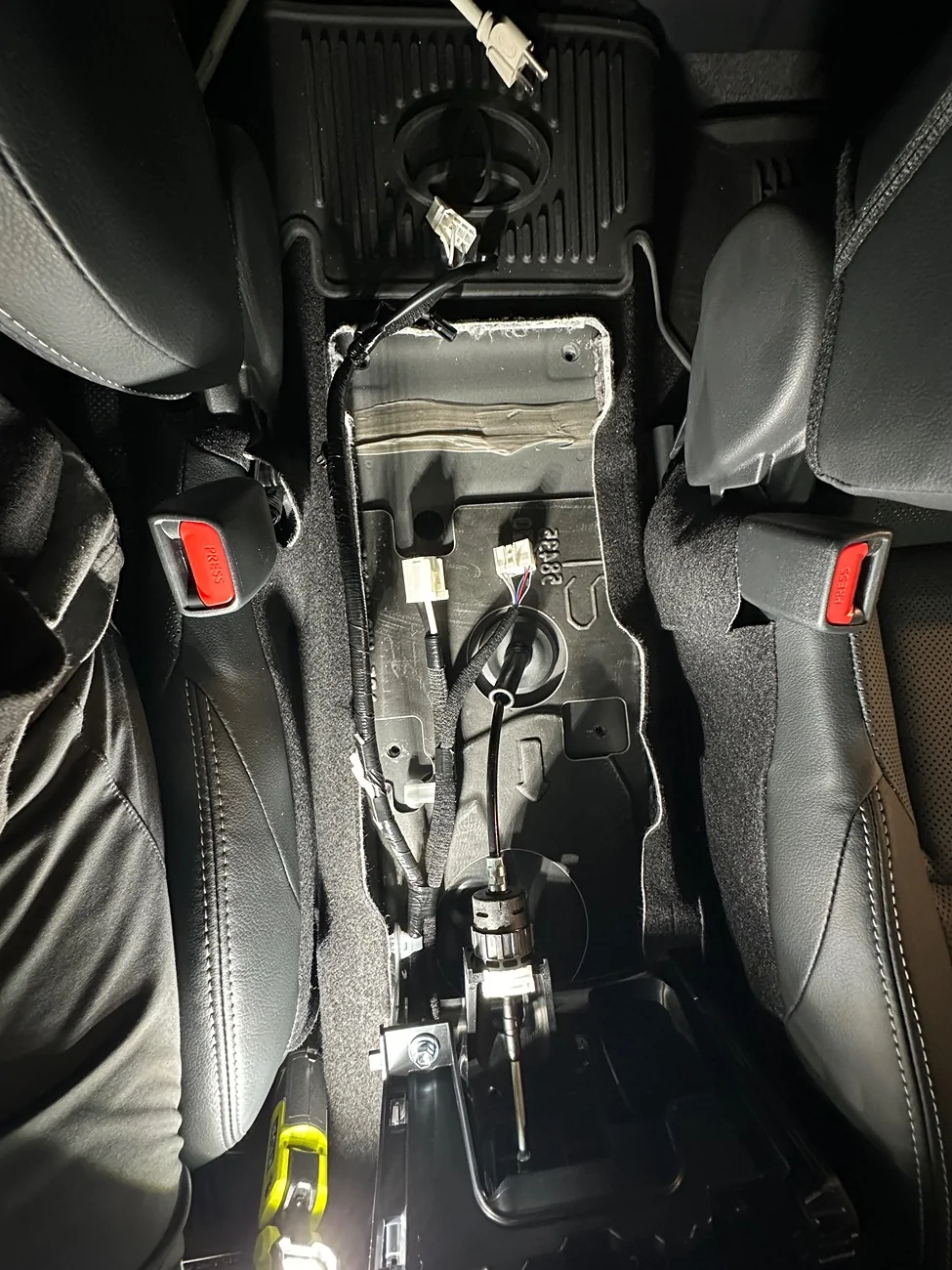

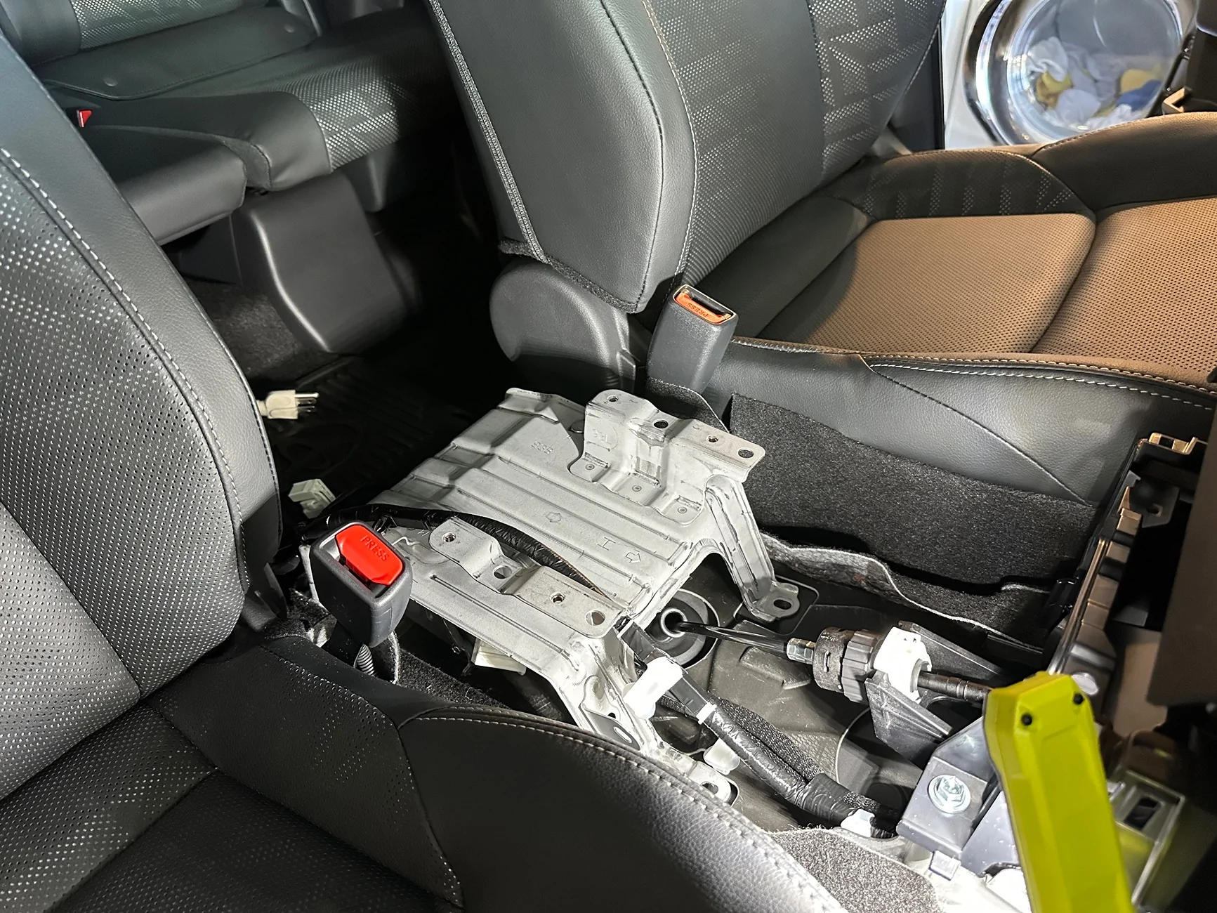

Anyone had any luck with the “400 Anytime Kit” on the 6th gen? Looks like they’re out of stock for now. I’m leaning towards swapping the inverter. I’m looking at the Victron true sine wave 375VA. I used that model on my previous truck. The only concern is the size, they’re fairly bulky (10.25” x 6.5” x 3.4”).
Aug 24, 2026
san jose can
The inverter is located under the center console. Dimensions are 5” x 5.5” x 2”. There isn’t much more room to fit a larger inverter. There is some empty space there, but the shifter cable is in the way.
Under the passenger seat there is hardly any room.
The simplest option is use the 400 Anytime kit, and live with the modified sine wave. You would have to remove the center console to install it. There is a YouTube video showing the process.
The alternative is to run new set of wires to the cargo area and mount the inverter externally. I probably won’t be going this direction.
See pictures for your reference.
