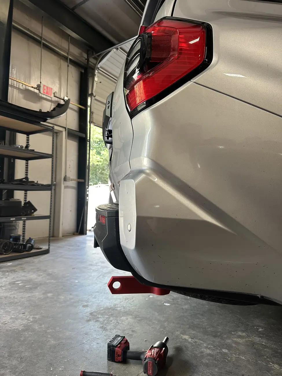

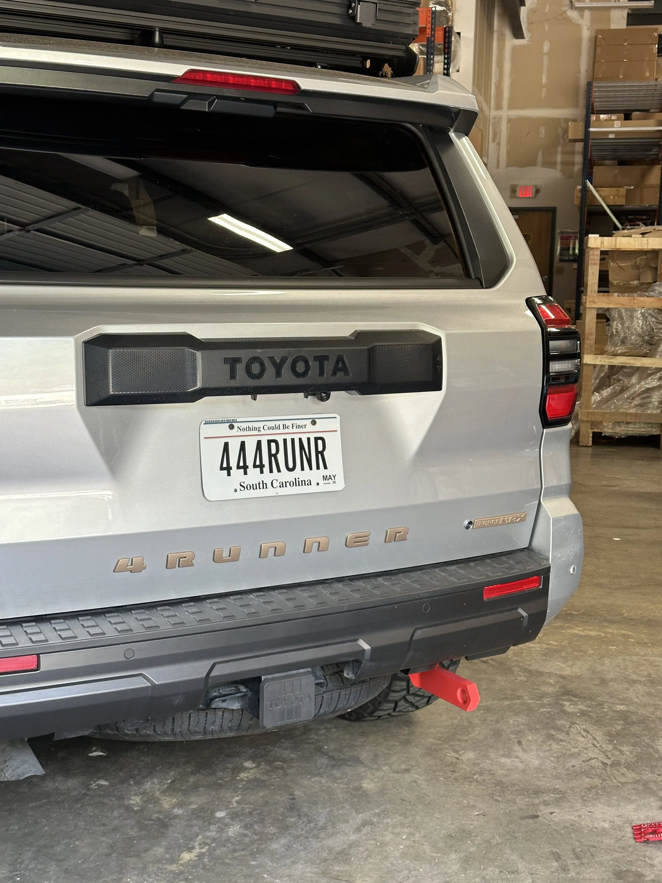

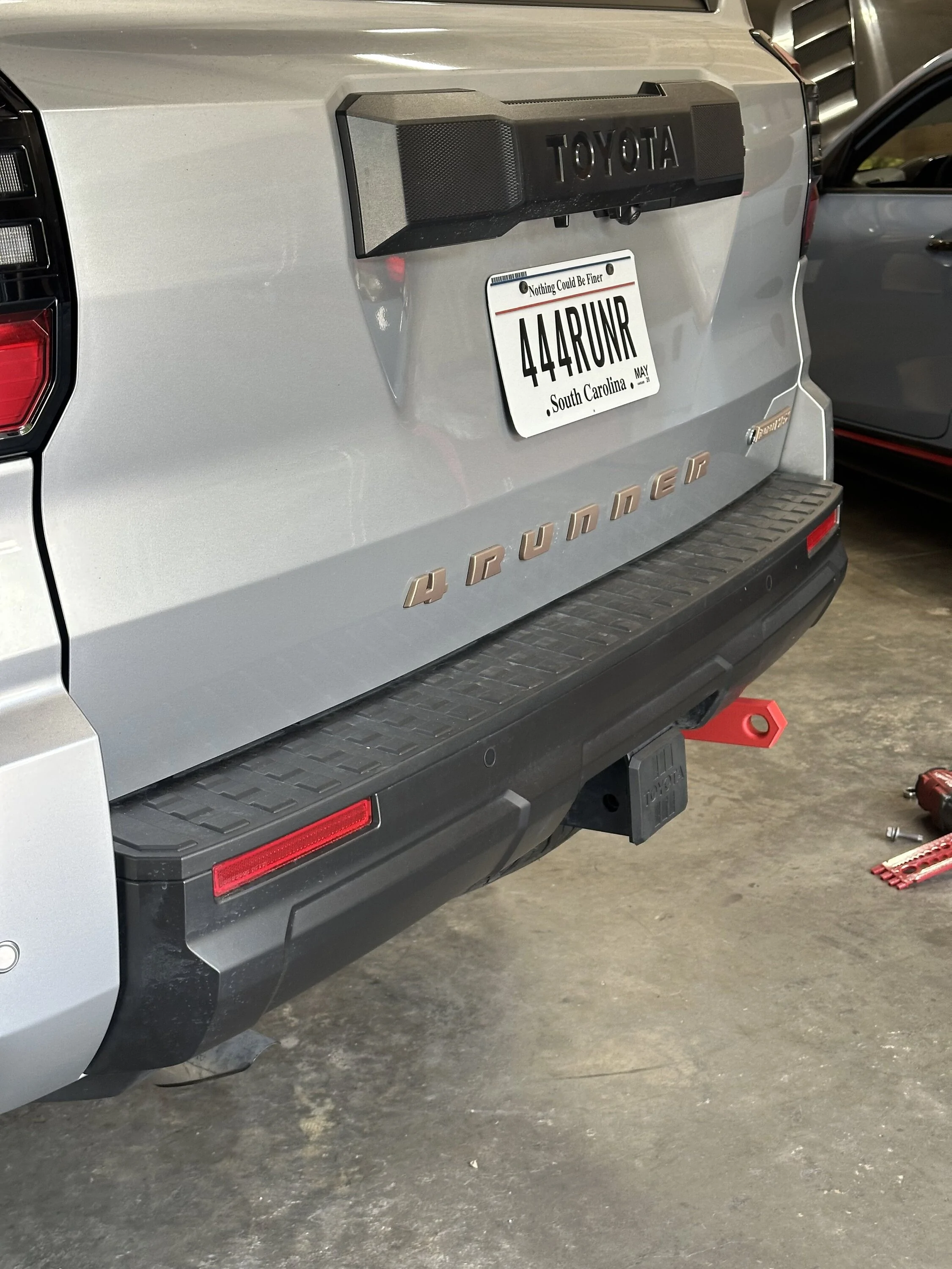

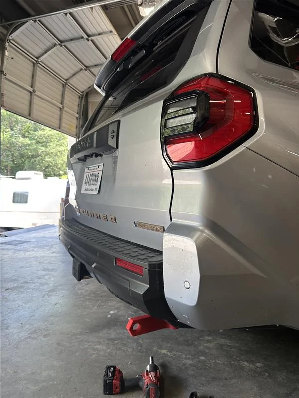

Hey everyone,
We’ve been working on a prototype rear recovery point for the 4Runner and wanted to get some outside perspective before we move further. I’ve attached a few photos below.
A couple of questions we’d love your thoughts on:
  • Do you like the general placement and design?
  • Does the clearance look right to you for off-road use?
  • Anything you’d change about the mounting setup or overall look?
This is still an early prototype so nothing is final. We really value input from people who actually use these trucks the way they’re meant to be used.
Looking forward to hearing your thoughts.
    • Yes, I do. In my instance, if you see in my YT video, I use my tow hook as a recovery point. This placement could complement that or I can now remove my tow hook recovery. I will address the design in your second question below.
    • My suggestion would be to rotate the point to be horizontal vs vertical, in order to gain additional ground clearance. Every inch counts sometimes, and it sits up tighter for a more minimalist look. Rotating it horizontally will also match my front ones from you guys. I have self-proclaimed OCD (LOL) and would prefer all points from the same company match and have the same design. Wraps everything up very nicely.
    • I am obsessed with attention to detail as the smallest things matter, so if it were my company, I would design the look to match your front ones. Horizontal and have a hexogonal (5-side) look you have with your fronts...and I would certainly anodize them red and stamp the specs on them like you do with the front. It will also immediately identify them as Sxth Element vs the competition (not to be named here).
I’d rotate to match the horizontal of the front recovery points.

Horizontal and make the end match your front ones. If not a match, definitely square with dog ear design.
JayTech
Jay
Aug 6, 2025
70
47
Canada
Looks good. Clearance looks like it should be fine as the tire still seems to be the first point of contact coming down. I would rotate them to maximize clearance even further and to match the front. Also make it look identical to the front so they match. Other than that looks great.
