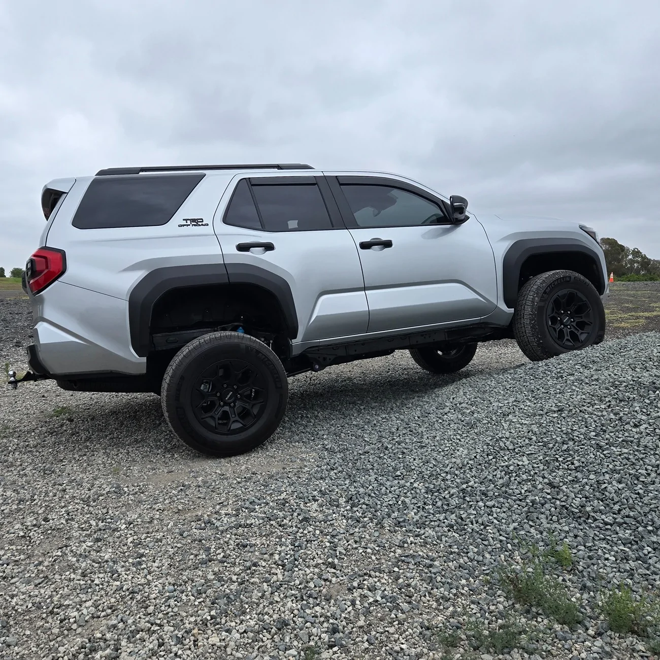

I have an orp which utilizes 18 in wheels and factory tires which are close to 33 inch diameter.
I did not like the stink bug look from the factory. Also seemed very vulnerable for underbody impact in the front.
The bilsteins that came have a lot of controversy from people on this forum but I found them to be very good once you got rid of those coil springs.
The coil springs that come on this 4Runner are very bouncy. Once I changed coil springs to the all dogs spacer eraser, it took that away. Best Improvement that I have made so far.
If you go with a full set of coil springs you will retain a factory rake and get a solid 2-in lift while utilizing your factory upper control arms.
If you go any higher you will have to change those out or you won't be able to align properly.
So long story short I went with the front coils and a 3/4 inch Apache polyurethane spacer for the rear and leveled it out perfectly and retained maximum articulation.
Hope this helps

Looks sweet! Any particular reason you didn’t add them in the front? You didn’t want the rake I assume? Also, are you aware of any downsides/long term damage possible with using the alldogs front and rear springs with the Toyota factory installed bilsteins?
Joe Dirt
Sep 24, 2025
439
206
25 ORP
I only used the all dogs coils in the front. I wanted a level stance but being a 2 inch lift in the front would give my rear Tijuana tilt sag, so I put in a three quarter inch Apache polyurethane spacer in the back. I'll Factory Bilstein shocks. I've gone through a lot of various coil and spring combinations on my previous 4Runners. And I can say with this combination it's a pretty good setup and very low cost. All dogs website has a video on the Tacoma and also the 4Runner. I don't Rock crawl or do anything crazy I mostly cow Trail on dirt roads and sandy beaches. I still have full suspension articulation without any bottoming out.
