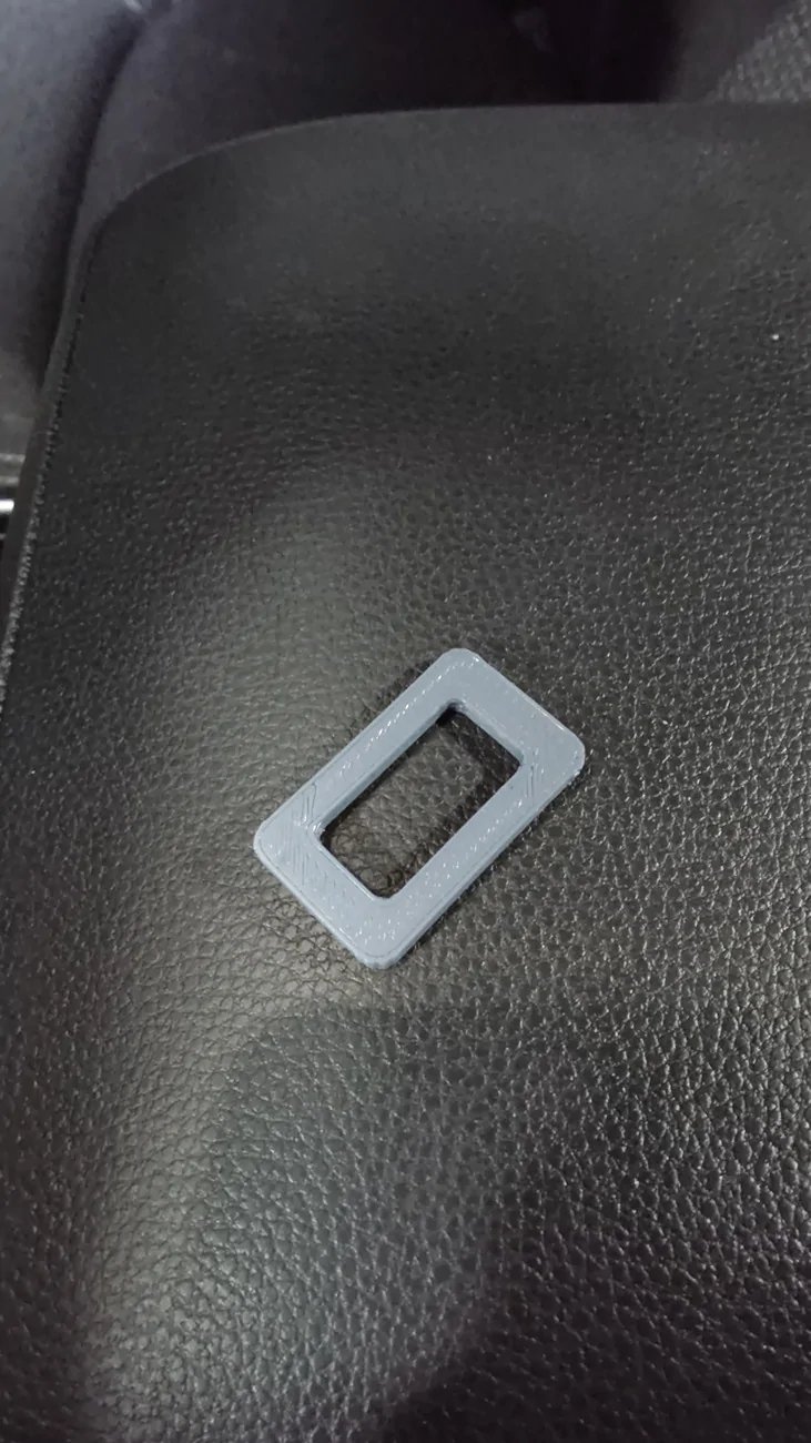

Wow! I had my dog on my passenger seat today and that seat belt noise is sooooo annoying and runs for so long. It was insane. Can the dealership turn that off so it doesn't make noise for the rear and passenger seats when they don't have a seat belt on?

Get a pair of seatbelt extenders off amazon. They are $7 each and work well. It cancels sound if you dont wear it.

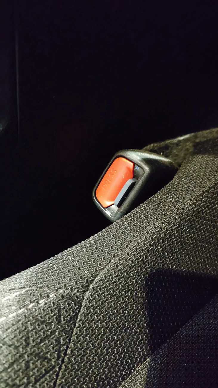

Just got another set for the rear seat warning lights

I also noticed that I have a dog cover on my rear seats, but NOTHING on the actual seats, and it still shows on the dash no seatbelts in the rear. Is it really that sensitive that 2-3lb of cloth would trigger it or is there a sensor that gets blocked and that's triggering it?
