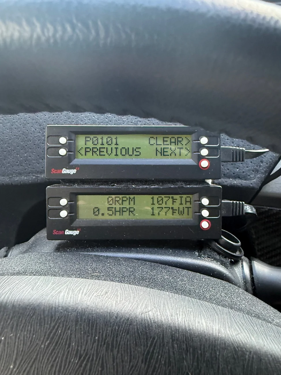

I have 2 Scangauge II , Daisy chained in my 2013 Toyota Prius.
At around. 260k miles, my check engine light came on. 2 codes from the scangauge II lead to the MAF Mass Air Flow Sensor.
I went to my local O'Reilly store and picked up a MAF air flow sensor cleaner. I cleared the codes. Engine light is off after driven for hundreds of miles. All good now.
Scangauge II saved me hundreds of dollars.
It's worth the investment. I will probably purchase for my Runner when it has aged a bit. This Runner has obviously more Tech than my aging Prius.
It's beneficial to program x-gauges and monitor conditions that the vehicle does not otherwise provide.
Sample:
2025 2026 4runner 6th gen Scangauge / Ultragauge Compatibility? IMG_9676
2025 2026 4runner 6th gen Scangauge / Ultragauge Compatibility? IMG_9677
You will not be disappointed. Very reliable equipment. I've had mine on for at least 10 years and no issues.
For anyone in doubt, I hope this helps.
