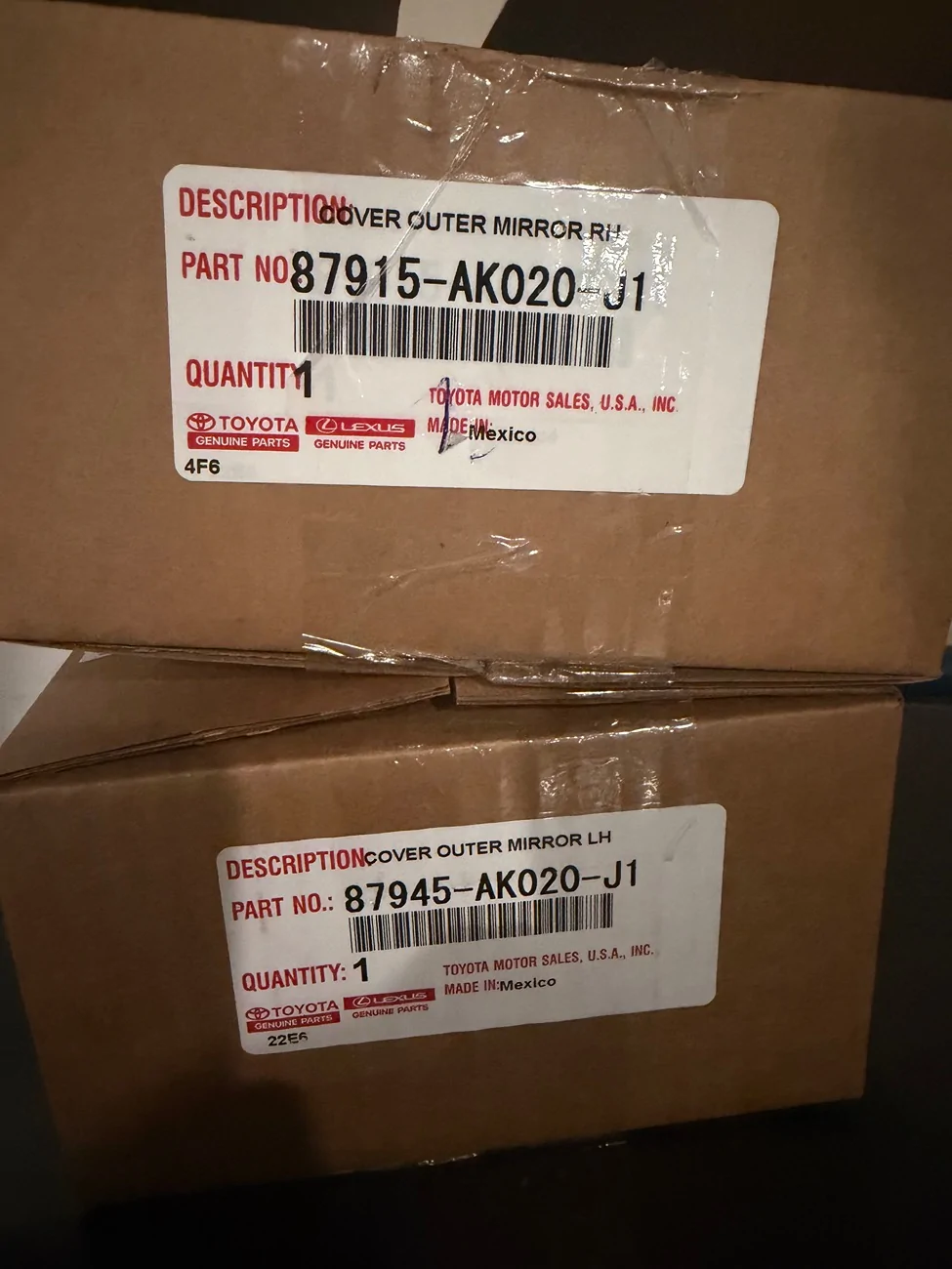

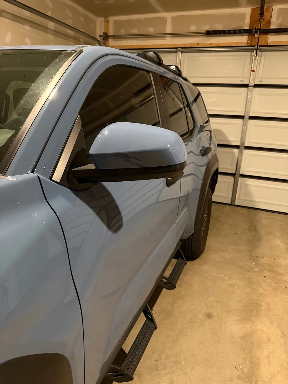

Alright for folks with SR5s - I finally got the part number s needed for the Heritage Blue mirror caps without turn signal indicators. To get these part numbers, I emailed a dealership with a Tacoma VIN that had these on them and they gave the numbers:
87915-AK020-J1
87945-AK020-J1
These are for Tacoma but they are the exact same fit on SR5 4Runners. You should be able to find all the different colors for this same part by looking up AK020-J1 and finding the description with the color for yours. I just installed on mine, posting some pics here.

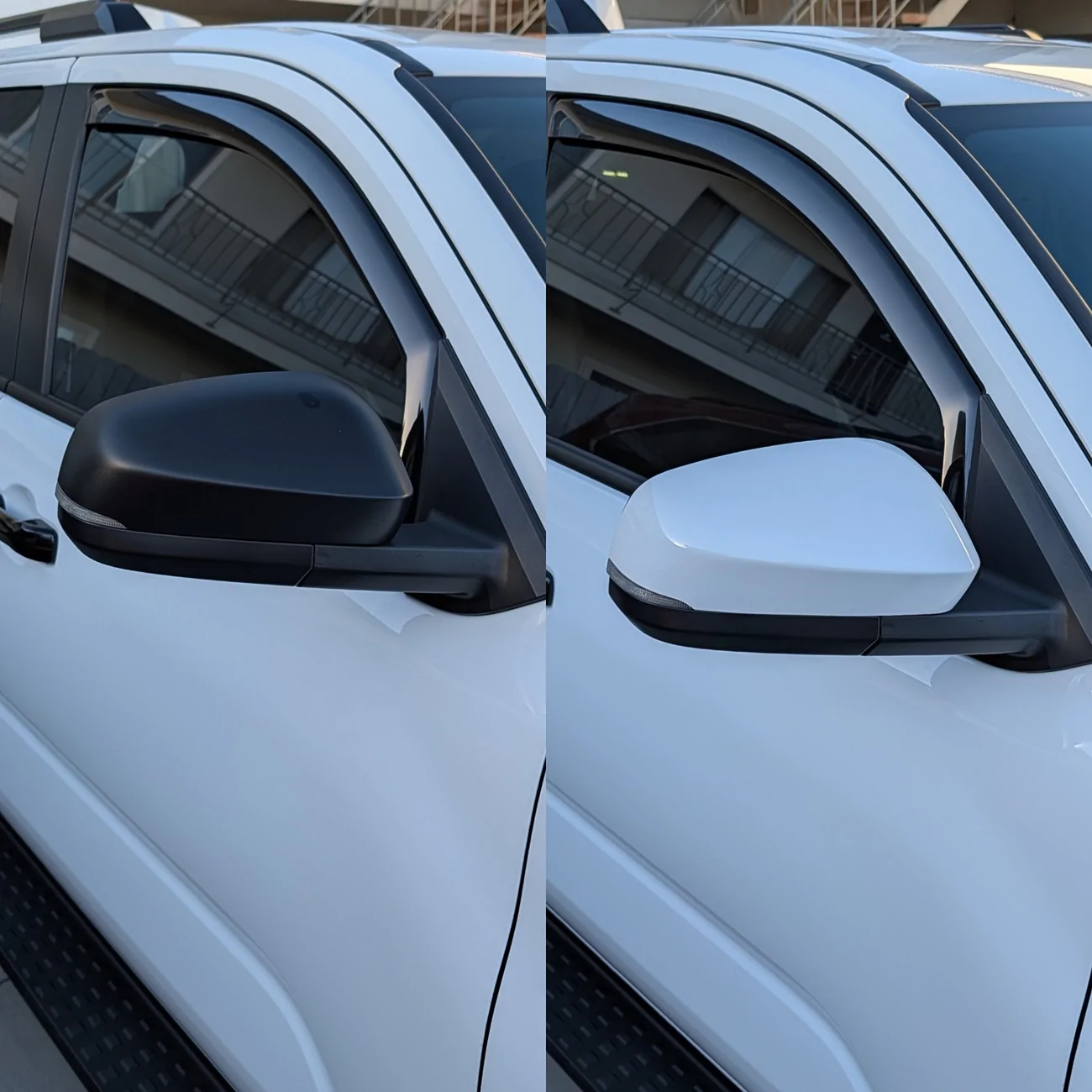

Glad I found this thread. Swapped my covers out today and love the look. I was going to buy the smoked signal lights but now I think I'll pass on those. The OEM light blends fine with the Ice Cap color.
