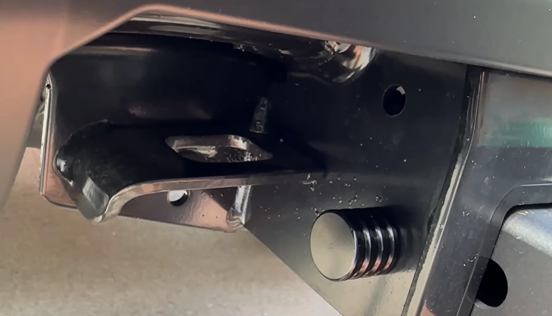

So there are two recovery points in the front and one on the rear right. I noticed two holes, one on each side of the trailer hitch mount. Can these also function as recovery points or are they just for trailer safety chains?

chains only
you'll bend or rip the chain attachment holes with any serious pulling
to recover using the hitch, install a d-ring in the hitch or use a loop around the hitch pin itself
the hitch is strong enough to lift the 4runner vertically

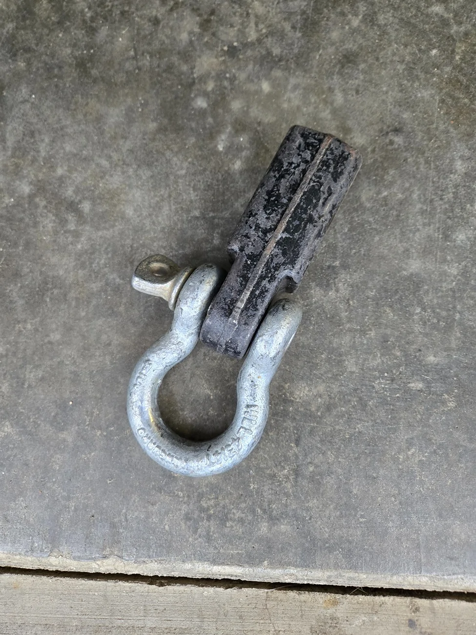

If you need to pull from the rear of the vehicle, you can use the loop of the tow strap (or recovery strap) and the hitch pin.
Remove the rubber cap from the hitch mount, stick the looped end of the strap into the receiver and insert the hitch pin into the loop and secure the pin. Be careful to pull straight back when you do this so you don't damage the strap with the edge of the receiver.
Or even better, pick up something like this: https://a.co/d/3Y9WwjH

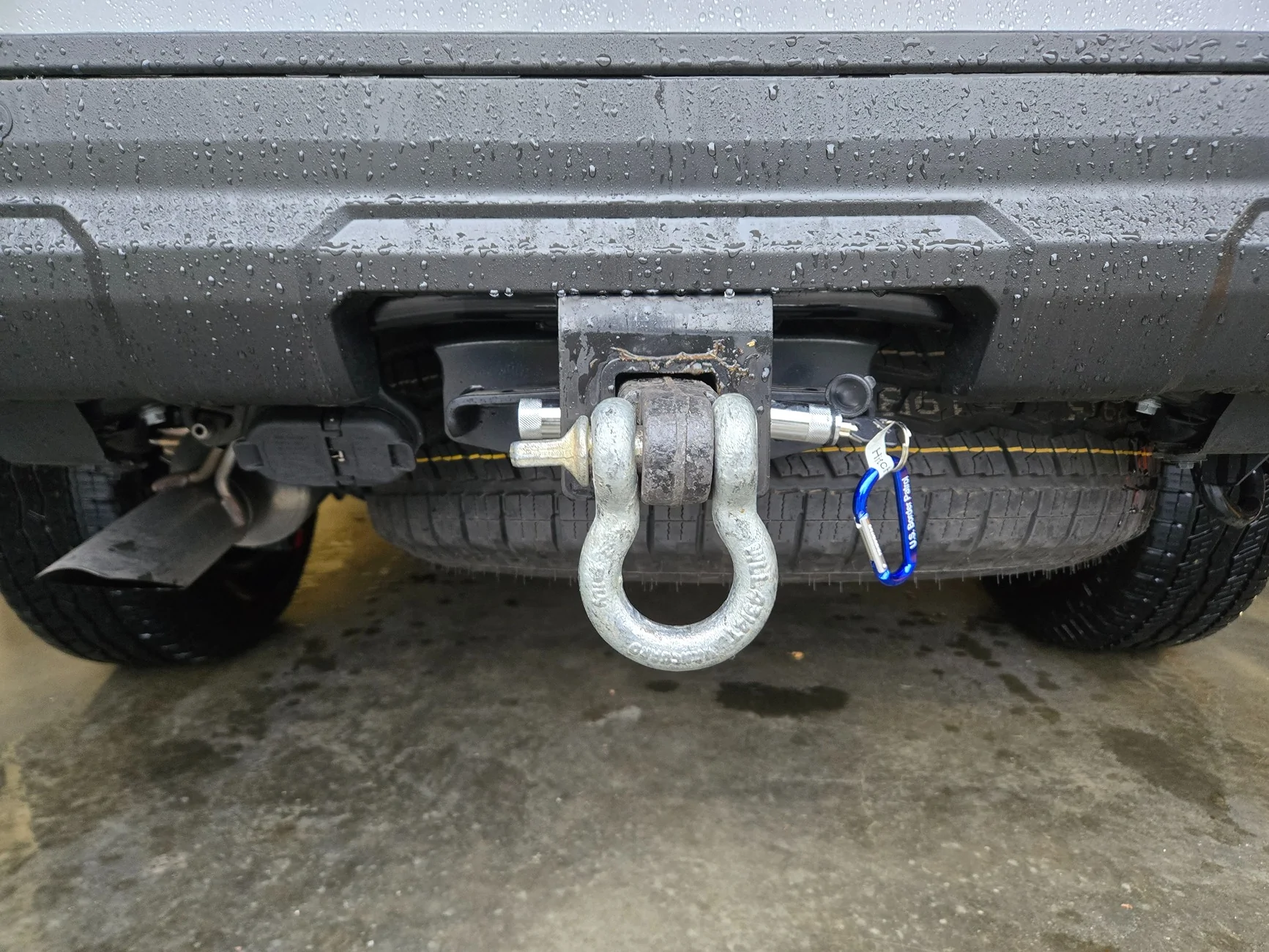

These are the easiest and probably the safest, most versatile way to anchor/attach a tow strap or chain. Purchased this one from Warn Industries years ago and it has seen a lot of use on my 3/4 ton truck. Just ordered another one off Amazon so I can have one in each vehicle. Several different manufacturers now and different colors/options. In addition to using this or my front hooks on the truck to drag someone out of a jam, I have also used it to anchor myself to a tree in order to winch somebody else out in slippery conditions like snow. As soon as I find a mount that I like a winch will be on our 4Runner.

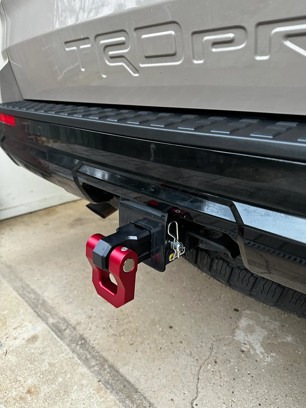

Thanks so much for everyone's thoughts. I wound up going with a Reno product from the link suggested above. It wasn't stupid expensive and delivery came in less than a week. Unfortunately, the nice locking hitch pin they provided isn't long enough to make it through the 4Runner hitch, but I was able to use the non-locking pin that came with my TRD Pro. I had to give up the nice Diode Dynamics hitch reverse/brake light. I do think the new shackle looks way more beefy and the anodized red matches the genuine Toyota recovery points on the front end perfectly.
