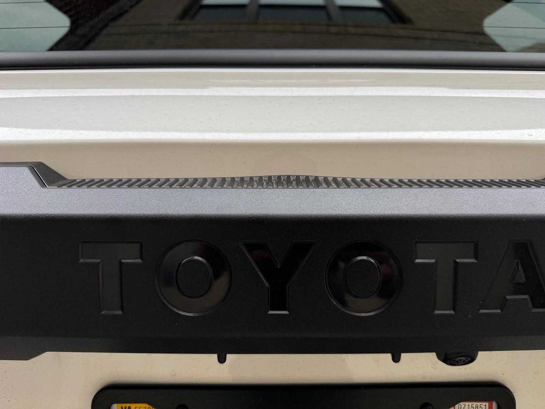

Just noticed my rear trunk plastic has warped this week. I’ll take it to a dealer this week if I can, I also have the slightly non-flush front fender issue. Just wondering if anyone else has experienced this. Maybe a first year annoyance :unsure:

I believe I have the fender issue as well, but not this. This is something I'd take back and ask to fix. It's not a hugely functional issue, but definitely something I'd get irritated by for a new car at these price points

I did finally make it to the dealer today, it is being replaced under warranty as expected. Surprisingly, they're able to source the part next day, which I wasn't expecting. Ironically, another 6th gen was in the service bay right in front of me for the front air dam issue :D

you got that part number by chance?

Not yet, but I'll see if I can grab it when I go back today.
That would be awesome. Removed the black Toyota inlay to put bronze and I was using a rag from a bin. I put iso alcohol on it but there must’ve been brake cleaner or something harsher on that rag still and de colored the plastic a bit.
Learned a lesson there about my rag organization lol

Here we go, per invoice:
P/N 76801-35460 Garnish Sub-Assy
