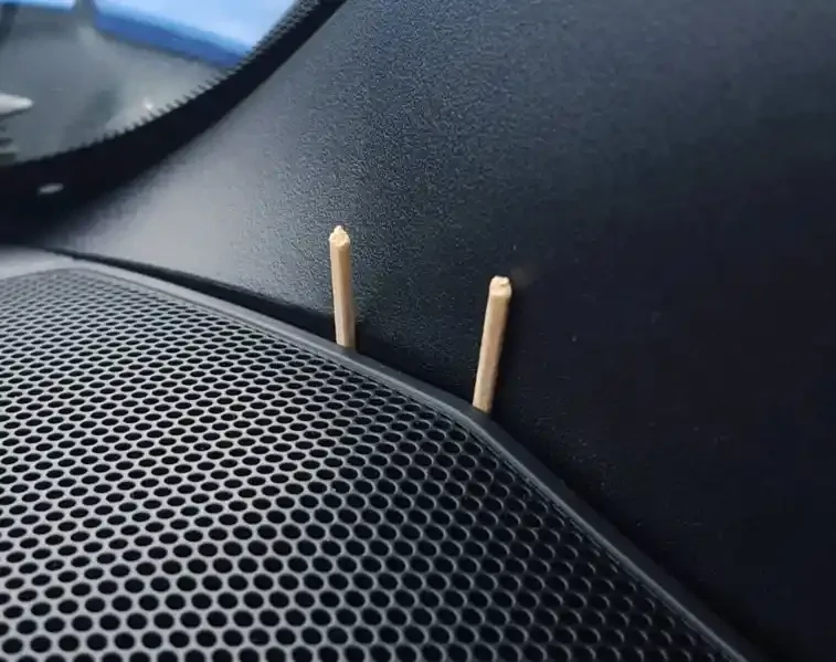

check the speaker grilles. our 2016 taco was notorious for squeaks in the dash area. apparently the clearance between the "A" pillar and the speaker was so tight that it would rub depending on temp.
here is a pic when i was isolating the noise, once i did this the noise went away.
2025 2026 4runner 6th gen Dashboard noise (plastic creak) in dashboard at low speed acceleration 1781524899840-ru
our 2018 tundra had a rear passenger seat that would rub the corner of the cab and squeak when the temp got to much.
