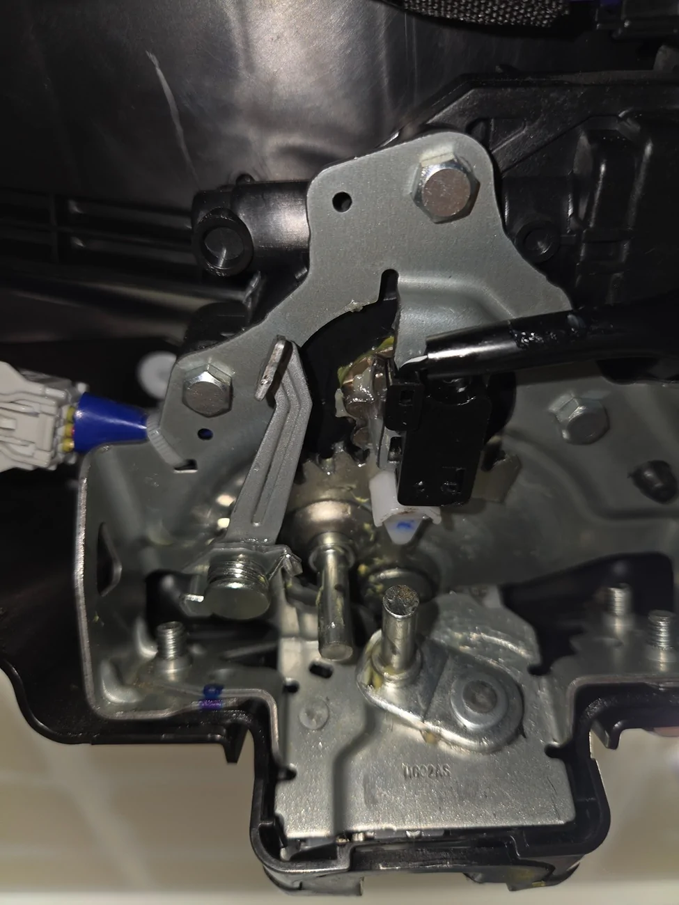

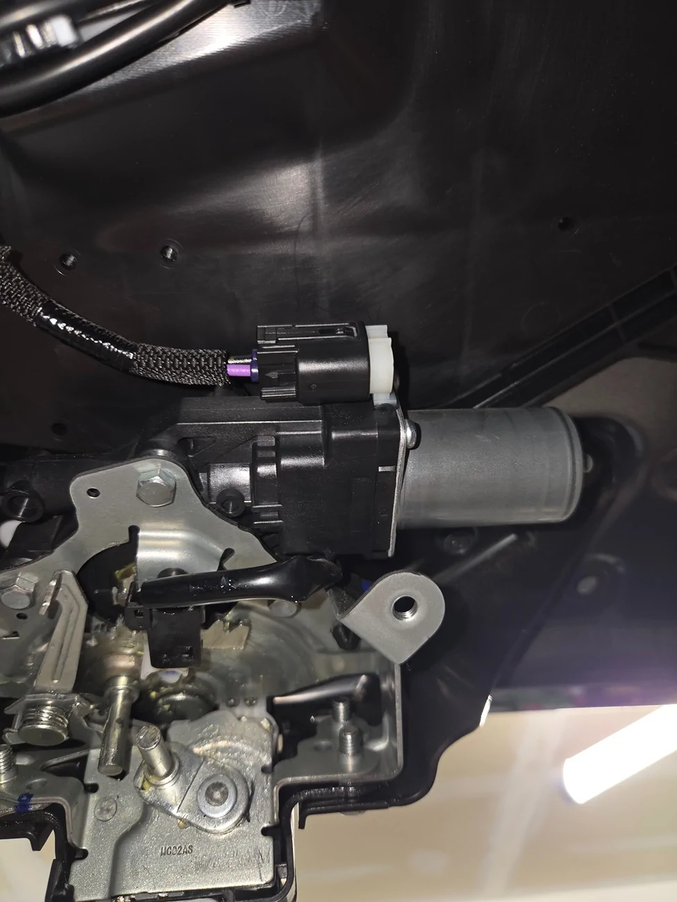

I thought i had it fixed. Found the lever but now the soft close will not release.

Close the hatch, disconnect the negative terminal of the battery for a couple minutes and try opening again.
That did work was able to get it open now find out what disconnect to cause issues

I figured the logic got out of wack when i left the motor unplugged and tryed to operate.
So it was not closing and resetting.
Here a video of it working without panel on so others may not go through my pain.
