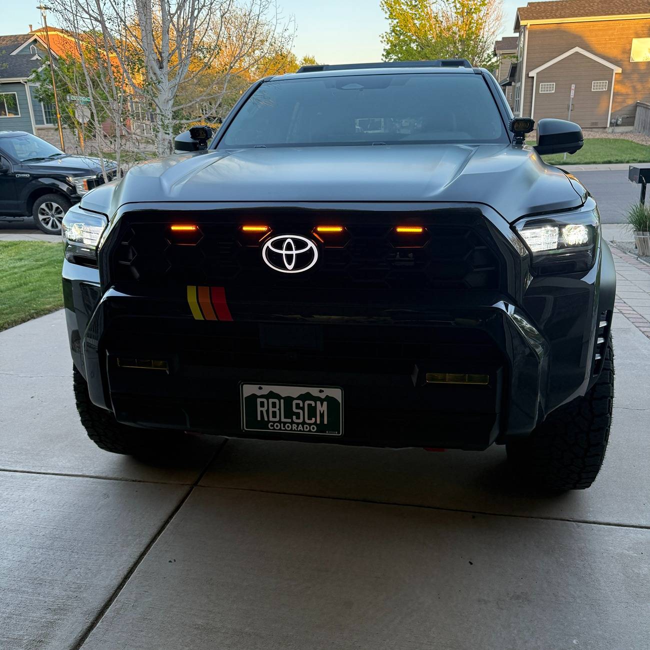

Could I be the first idiot to put Raptor lights on a 6th gen grille? I couldn't find any so I bought some for the Tacoma and designed / 3d printed some brackets to make them work on the grill and this is the result!
I need to take the front bumper off to properly hide the wiring but that will probably be an adventure for the weekend. That pesky shutter really gets in the way.

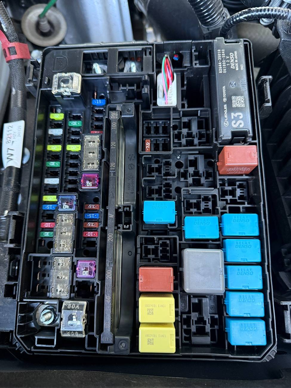

Not around the vehicle atm and of course cannot find a photo of the fuse diagram online lol. If you happen to have a photo of yours (passenger side box under hood) I could mark which one I used.
Thanks!

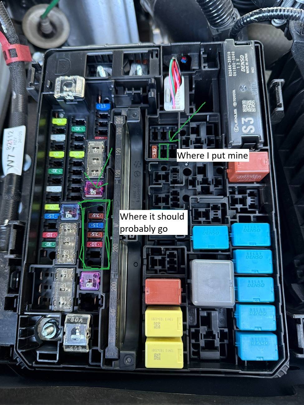

So the ones in the lower row are the actual acc ones but I could not get a fuse tap to fit there because of the orientation and height of everything around it and I am not about to attempt to piggy back off a positive or whatever the correct way to do it is... So I went up to the top part which those 6 blocks all have power and turn on with the "on" position (although mine had another couple fuses installed there also where yours just has the 7.5) I am currently running my ditch lights and the raptor lights from that tap going to the switch and have not had any issues or lights pop up.
Where you put it worked, thanks for the assist @Geofflolz
