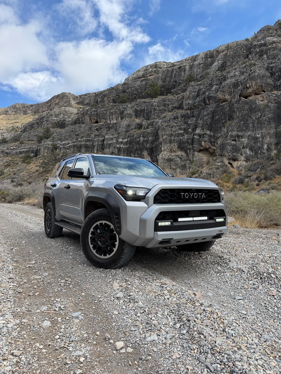

Was looking to get new (bigger) tires.
I kind of like the factory wheels on the car so was wondering what would be the biggest fit no lift.
Currently rocking the default tires (Falken WP A/T 265/70/18)
I kind of like the stock wheels that it came with (I believe they’re 18x7.5?)
I’m thinking of doing 275s or 285s but I understand there’s potential rubbing and spare tire mounting issues. Thoughts?

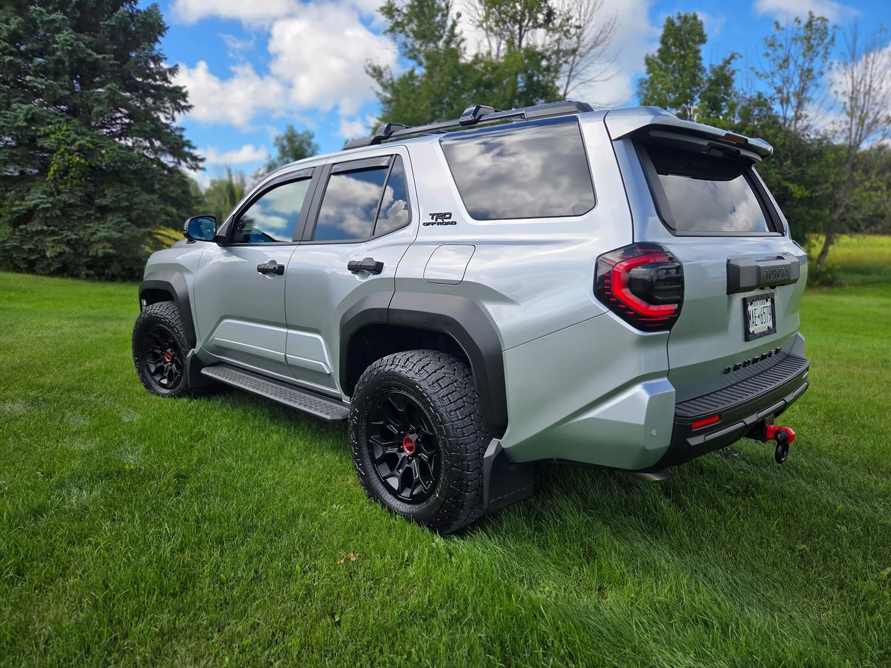

I'm pretty certain you'll have zero rubbing with the stock wheels and those tire options. I had 33.5" tires on the stock suspension with +25 mm 17" wheels and they didn't rub. I've thought about going back to my stock TRD OR 18" wheels. Yes they're 18x7.5 with a +55 mm offset. Silver looks great btw
