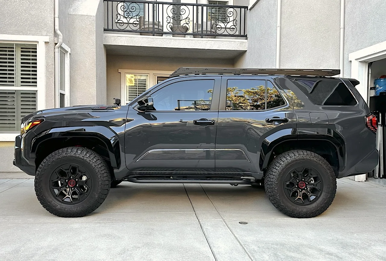

Sure thing. Here's a side shot of how she sits currently.
As you can see, it's almost exactly level, with an approximate .5" front rake, which is absolutely perfect. At least for my truck. That's why I'm saying...adding the 1" top hat which gives you an additional .5-.7" lift in the front would give me an absolute reverse rake.
