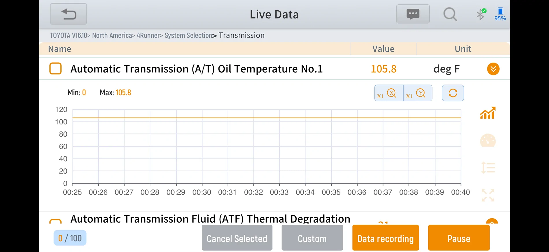

I looked around and didn't see it in the software for the Gearwrench dongle I posted. I'm probably going to buy this VXDIAG https://vxdiag.com/collections/vcx-se-for-multiple-models/products/2024-new-vxdiag-vcx-se-pro-3-in-1 which should go much deeper for Toyota. They have a cheaper one if you only want Toyota. I'll report back if I end up getting it.
So quick question, which one did you actually buy to see that screenshot of the transmission temperature.? Thanks in advance
TheArlenG
Arlen
May 2, 2026
Fort Lauderdale
'26 4Runner TRD Off-Road Premium, '12 Porsche 911s Cab, '03 Kawasaki ZRX120
Hey @Joe Dirt ... The Gearwrench Bidirectional. This one - https://www.amazon.com/dp/B0DBJGKGB7
I'm kinda learning the landscape here, but this one pulls pretty much all available data and you scan and run actuation tests. I wasn't able to find any of the customizations like remote windows down, etc. though.
I finally tried the VXDIAG tool yesterday. It loads an offline version of Techstream and I was able to access the customizations and enable the Key fob window control and turn off that fake engine sound (ESE).
