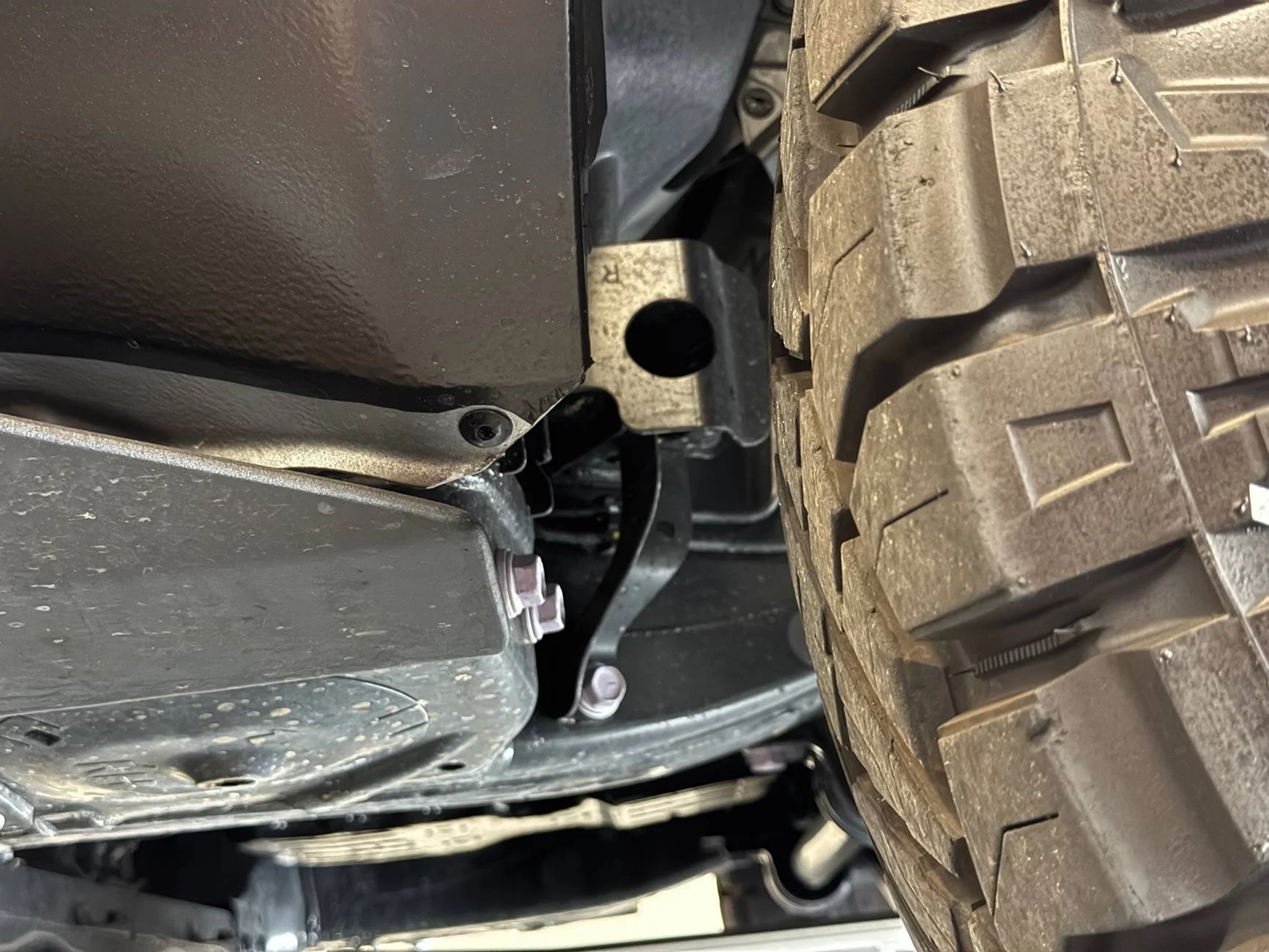

We are running our 17x8.5 +25 wheels, on 35x12.5x17 tires. In order to clear, we had to push the wheel liners forward, trim a tiny bit of plastic and the rocker area, as well as removing the crash bracket in the front wheel well. The trimming is un-noticeable to the untrained eye.
You will ideally need a 2.5 inch lift front and at least a half inch or more lift on the rear to make it sit right with 35’s.

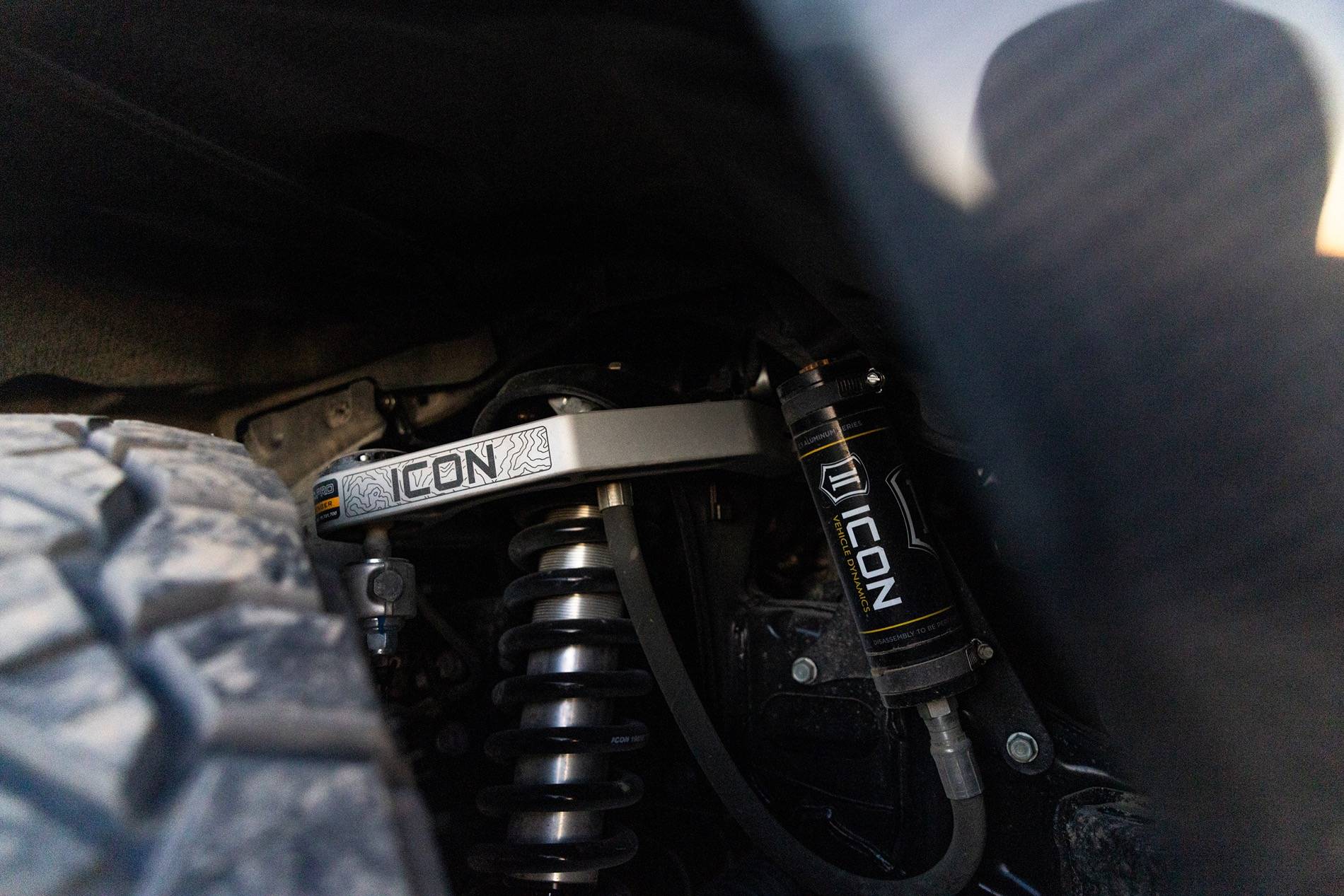

We are running Icon’s prototypes, they were using our 4Runner to test things out. It’s basically the billet stage 7 kit.

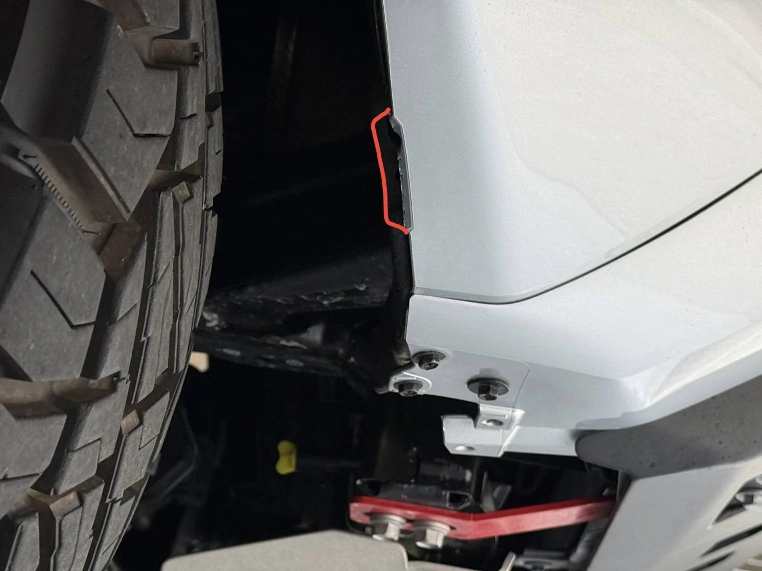

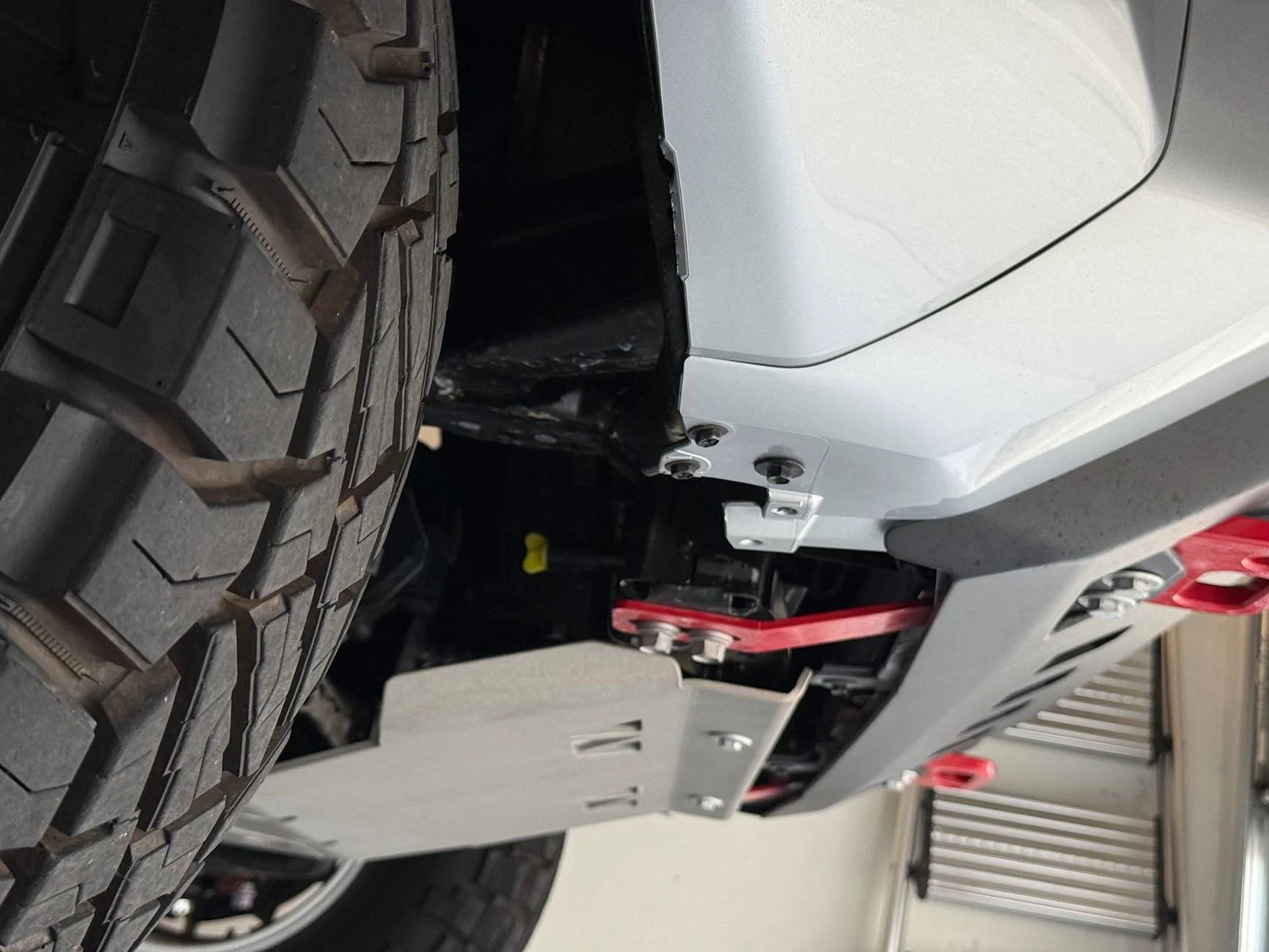

We didn’t have to trim that much, only maybe 1/4 inch on the front where the wheel liner bolts to, in order to push the liner forward a little, and a tiny bit of the sharp area off the rocker, mostly for better clearance when off-roading.
We have seen people get away with no trimming with the same setup. But most likely will rub a little if they take it off-road.
You should be good to go with that setup! 315/70/17 is almost the same as 35.
