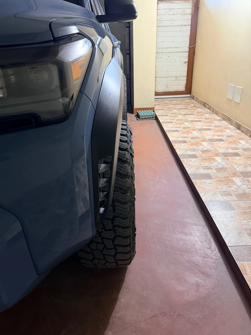

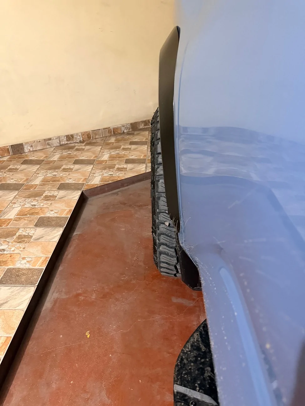

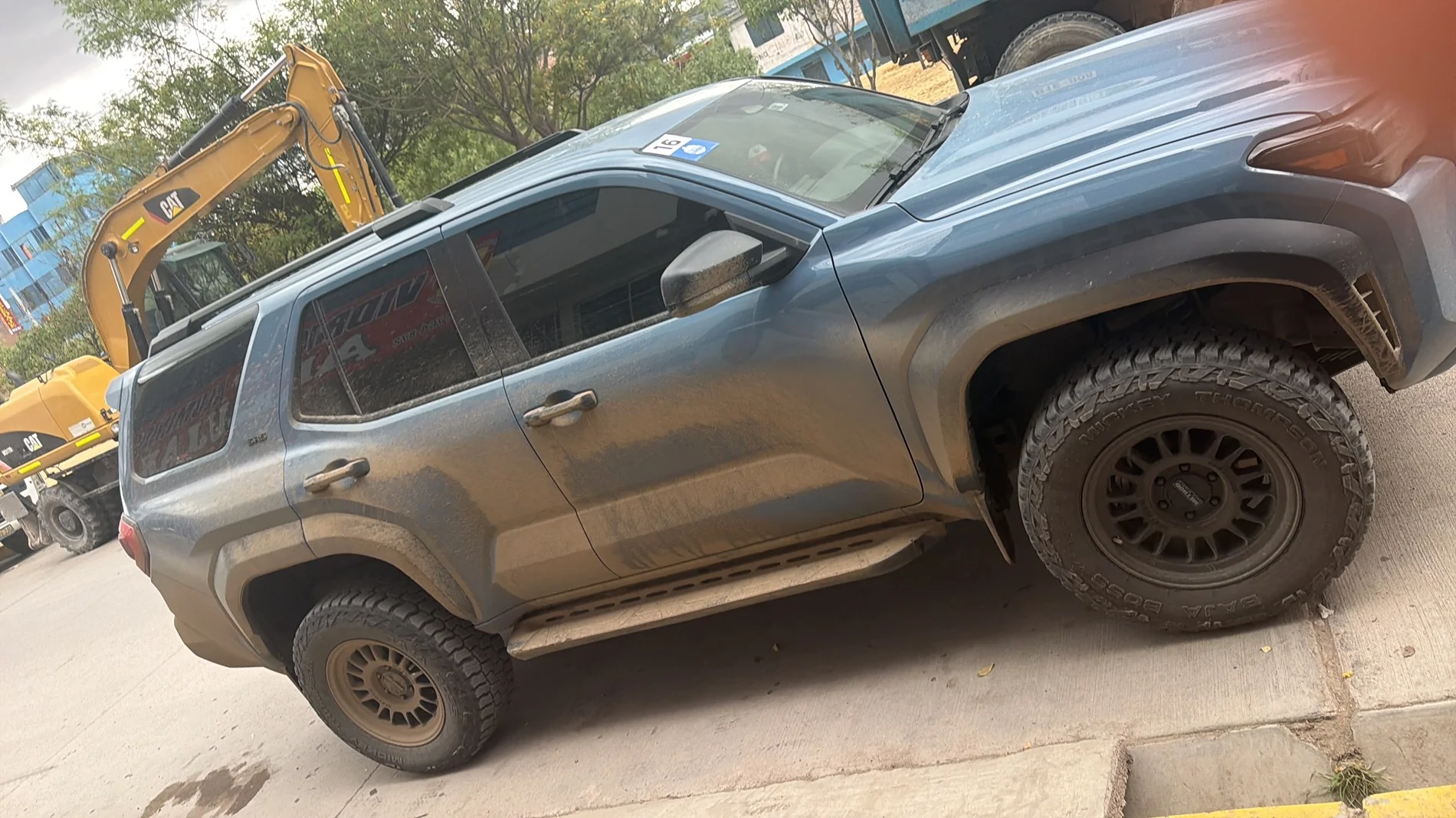

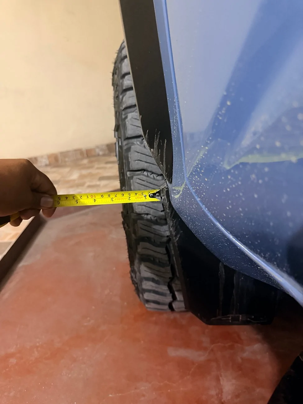

I have a 4Runner SR5 2026. Initially it had stock wheels with +55 offset and stock tires, I changed to +18 offset method wheels and Micky Thompson AT 275/65R18 tires. Now my Car gets dirty frequently (Even in town) Could you please recommend a suitable mudflup to avoid this situation, or any other solution?

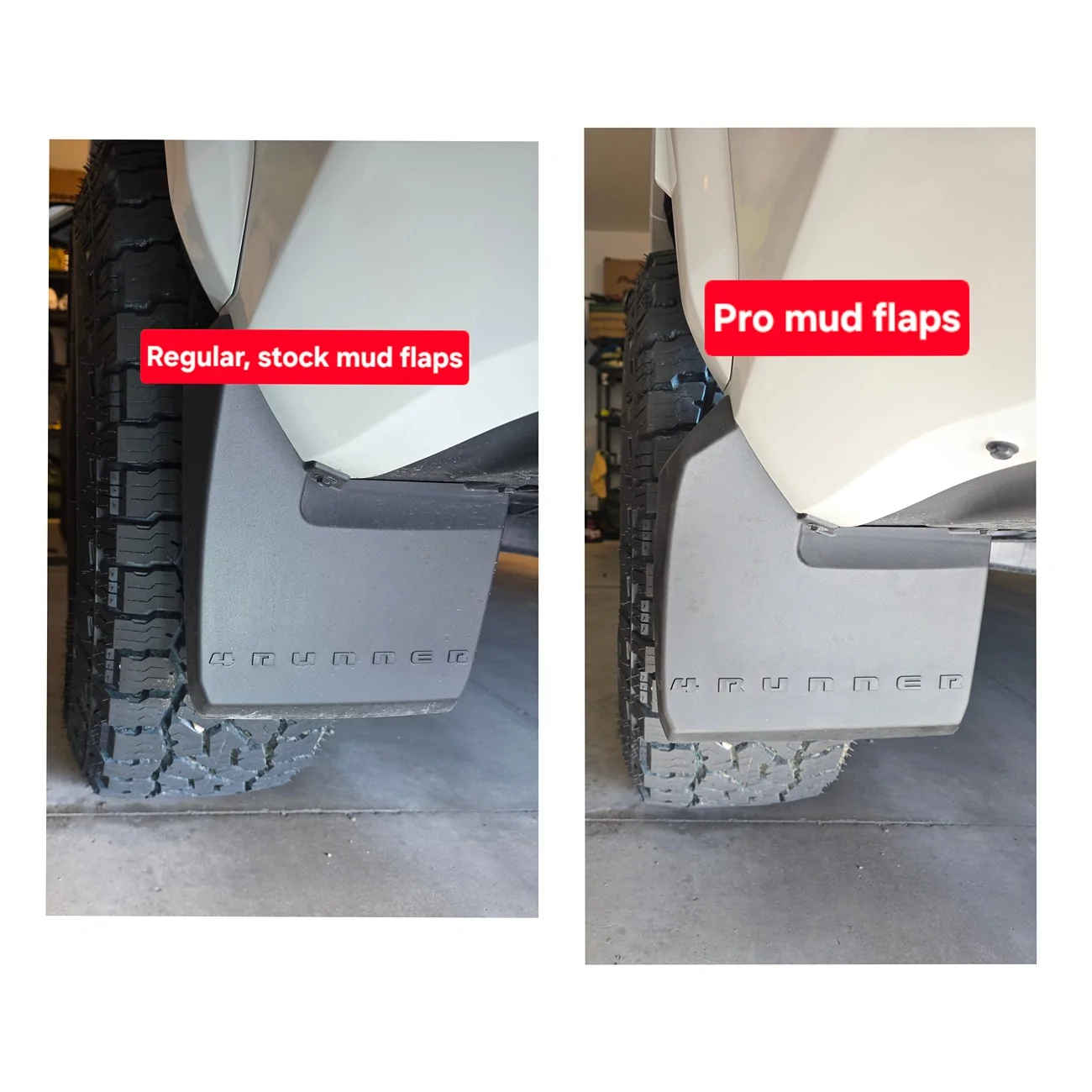

If you have Amazon in Peru, get these generic version of the wider mud flaps that are exactly the same from the Pro trim:
https://amzn.to/4gQiVtI
If not, then just buy the OEM one for the Pro (PN # PK389-35S10-TP). They are wider & cover my 275/70/18 easy. See pic below for comparison.
