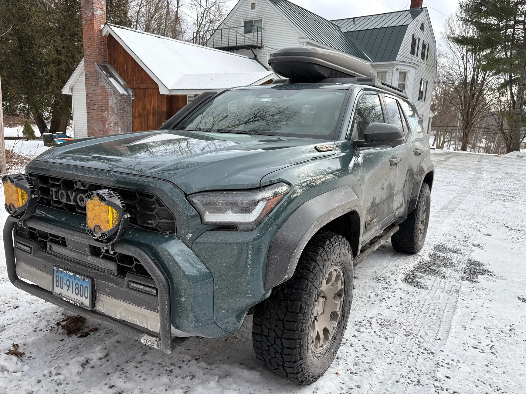

I’ve mounted my Yakima box to my Sherpa rack and it was smooth fit and easy install

That's very interesting thanks!
Sorry to be dense... did you have to drill new holes in the box to line up with the crossbars, or because these aftermarket latches don't fit through the existing holes in the box?
The former - since I was unable to move/adjust the ARB cross bars, mounting was restricted since either the back OR the front holes lined up - but not both at the same location on the roof - to insert and secure the u-bolts to the crossbars. So I simply had to drill (same diameter) 2 new between the existing holes on the box (front or back depending on your own setup) and then mount as normal.
Note - tailgate will hit the box when fully open so I disabled trunk auto feature and affixed some black 3M sponge tape to the rear end of the box just in case.
