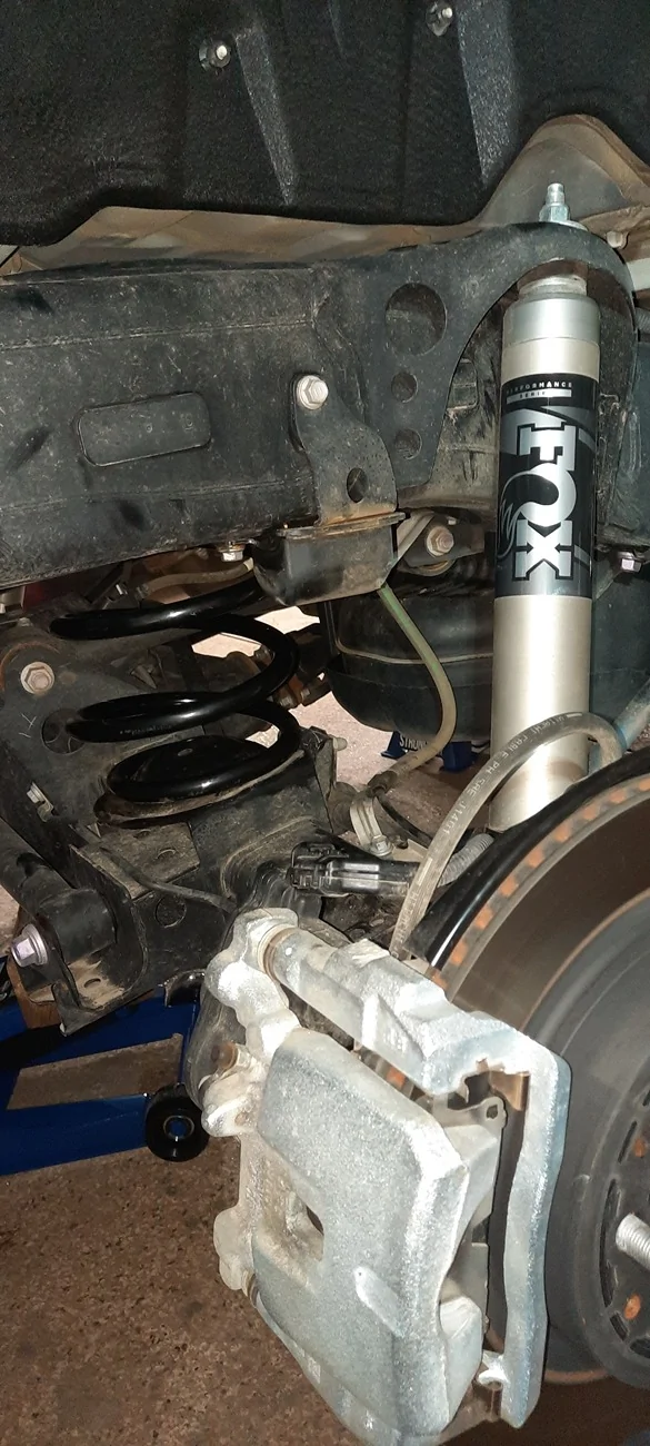

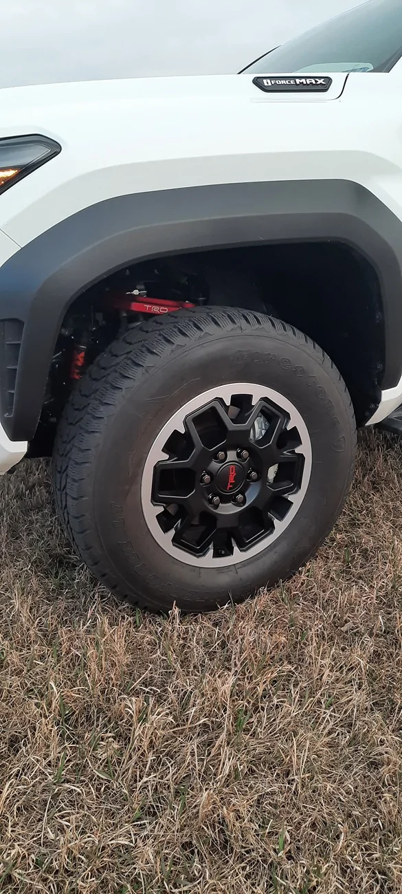

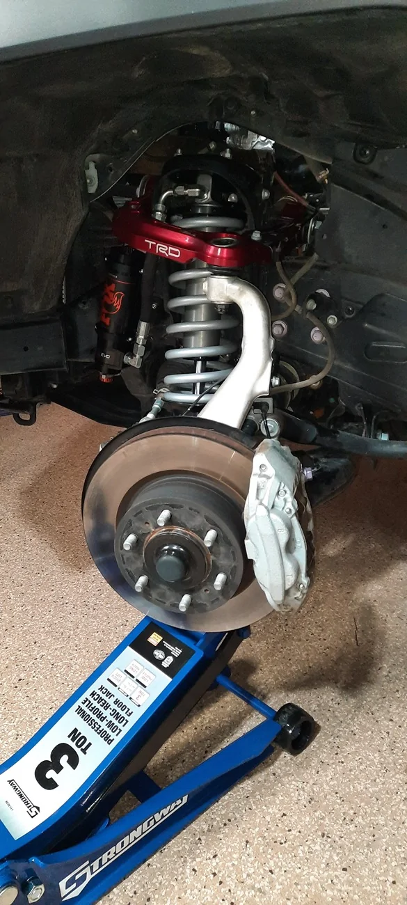

Like many others on this forum with various trims, I was disappointed with the harsh, jittery ride of my OR Hybrid. It started with lowering the tire pressure to 34 psi (it was delivered with them at 45 psi).
Then I put on Fox 2.5 Performance shocks on the rear, which calmed down the rear axle a noticeable amount. Then I put on ICON progressive rear springs. They were intended to be 2" lift springs on a non-hybrid, so on my hybrid, the lift ended up being barely 0.5 inch which was fine since my objective has never been to lift the truck. The softer rear spring rate was also a step in the right direction. I knew that when it came to the front suspension, I wanted to be able to mess around with low and high speed compression since I think the stock suspension has problems in both areas. The jittery, constant vibration on some roads comes from underdamped low speed bumps and the harsh, continuing oscillations of the suspension (especially the rear) after a big high-speed bump seems like underdamped high speed effects. I know most of the talk has been that the red Bilsteins are overdamped (including some of my posts). It gets very hard to determine what the exact problem is because jitteriness can be from both under and over damped systems. Plus, I've only been working on one end of the car at a time.
The Fox EVO DSC system is awesome - I'm so glad I went with it. The coilovers come with Eibach 1600.375.350S springs, which are 3.75" ID 16.00" long, 350 lb/in springs. There are 8 clicks of adjustment for hi and low. I have the hi speed on 6/8 and the low speed at 4/8. I used an 8Milelake spring compressor to so I could adjust the top perch upwards about 3/8" to take some preload off the spring and the lift still ended up being about 2 inches. I also put on TRD UCA's to get more droop clearance for the big springs and the remote reservoir hose. I recommend some aftermarket UCA's other than the TRD set with these coilovers as there is barely a hair's width to the hose at full droop with the TRD set. It will have to work for now.
Anyway the front feels fantastic. It is the plush, supple ride I was hoping for. All due to proper damping and soft(er) springs. Now I just need to get the 2.5 Elites on the rear, then I'll finally be done. I have some private dirt roads I can drive at speed (50mph+) and the Fox suspension makes my 4Runner into a big ATV. I couldn't stop giggling.

An update after several hundred miles on this setup. I now have both the low and high speed compression at 4 on the fronts. That seems to be the best compromise. I still just have the non-adjustable Fox 2.5's on the rear, and frankly, I don't see the need to switch the the Elites in the rear. Over harsh bumps, it is obvious that the fronts handle it better than the rear, but that is about the only time a difference is noticeable. If I do anything, it will be to get a set of 17" wheels and A/T Load Range C tires.

Do you need to adjust the spring with a spring compressor to run these at stock or near-stock height?
PierceVonCloud
Tim
Oct 6, 2025
44
South Dakota
2025 Hybrid OR
The Fox 2.5 Elites have 16" free-length, 350 lb/in springs that are installed at about 13". That is over 1,000 pounds of preload pushing on the spring perch. You definitely need a spring compressor to remove that preload and adjust the upper spring perch position. The lift would have been 3" from the factory had I not moved the perches before I installed them. I have 2-1/4" lift in the front with barely 1/8" of threads left for adjustment towards less preload. That tells me the absolute minimum front lift you could get is 2". Fox says the range for lift is 1.5-3.0 inches with this kit. I would say it's more like 2.0-3.5". I personally would not consider a 2.0 inch lift near stock ride height. I have no rake and it feels like I'm sitting in a Tundra now. That is fine. It is a compromise I can make for a good ride.
