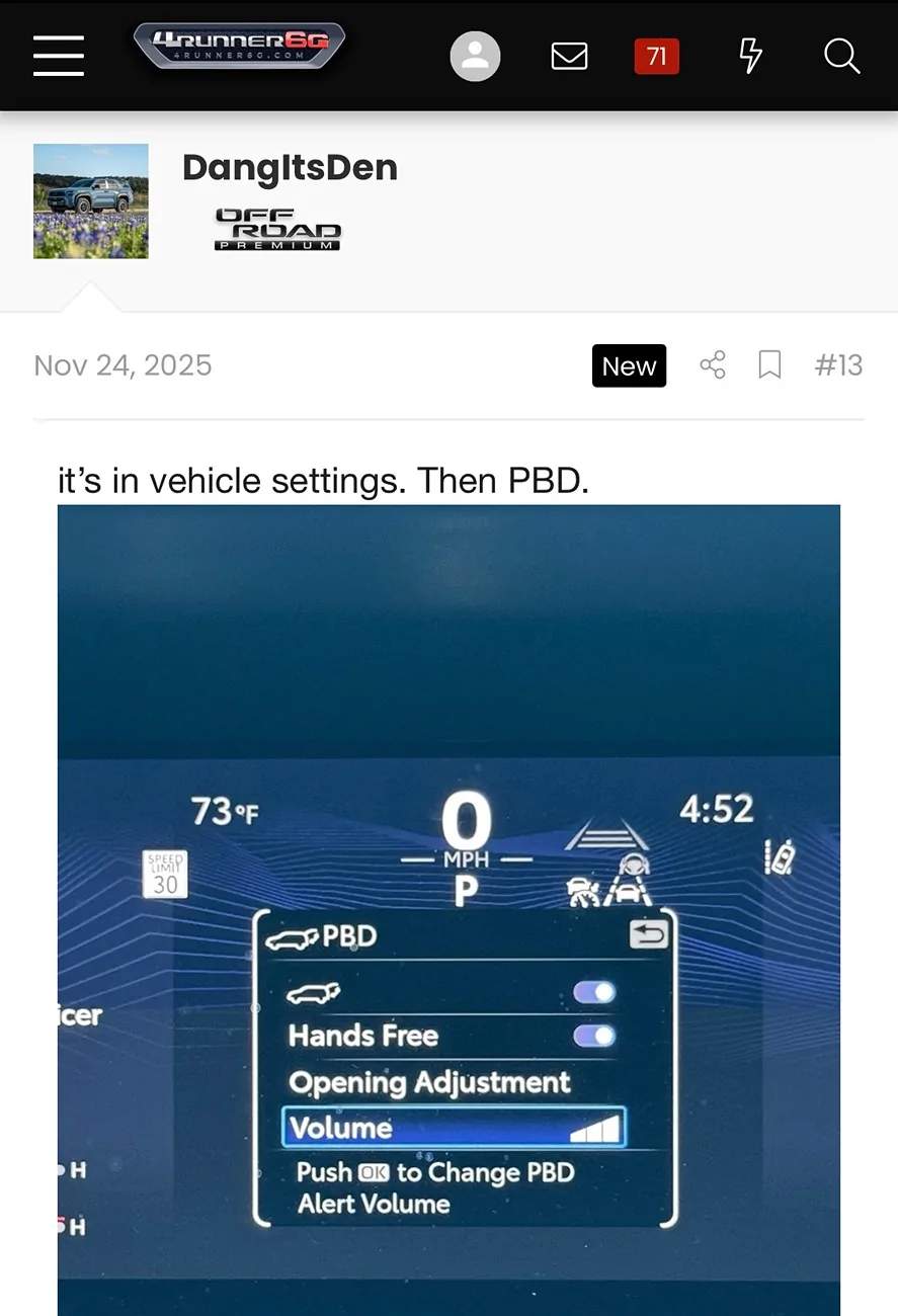

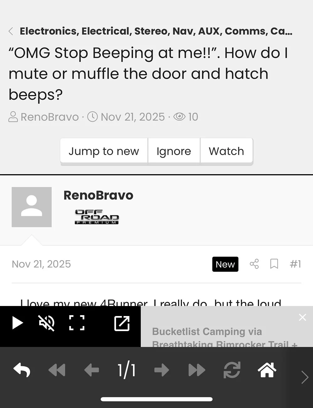

PSA: there’s another thread where some fine person explained how to at least lower the volume on the rear cargo area door beeps (PBD - Power Back Door) ….heres a pic of the thread and the solution to lower volume in case anyone else hadn’t figured it out yet.
