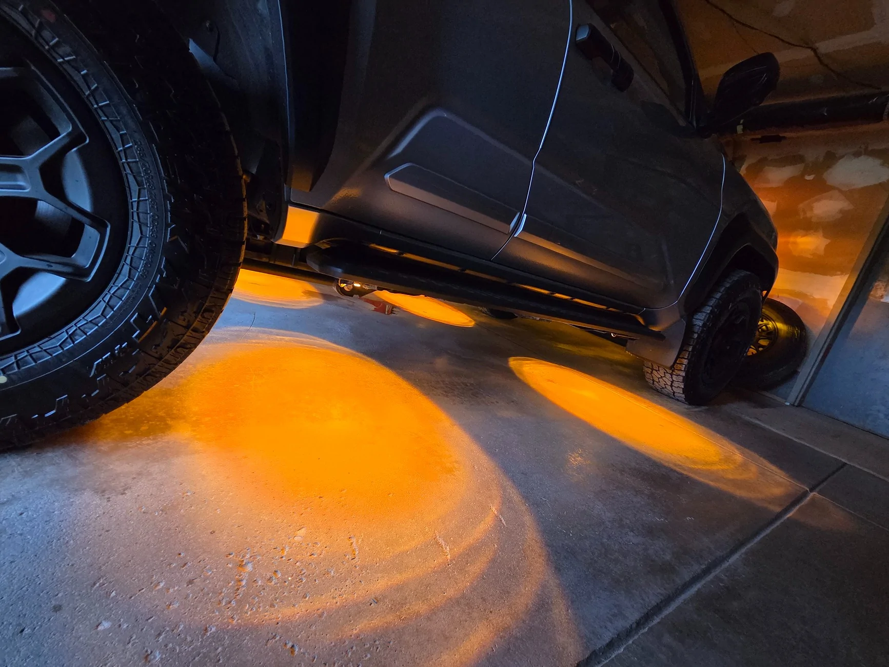

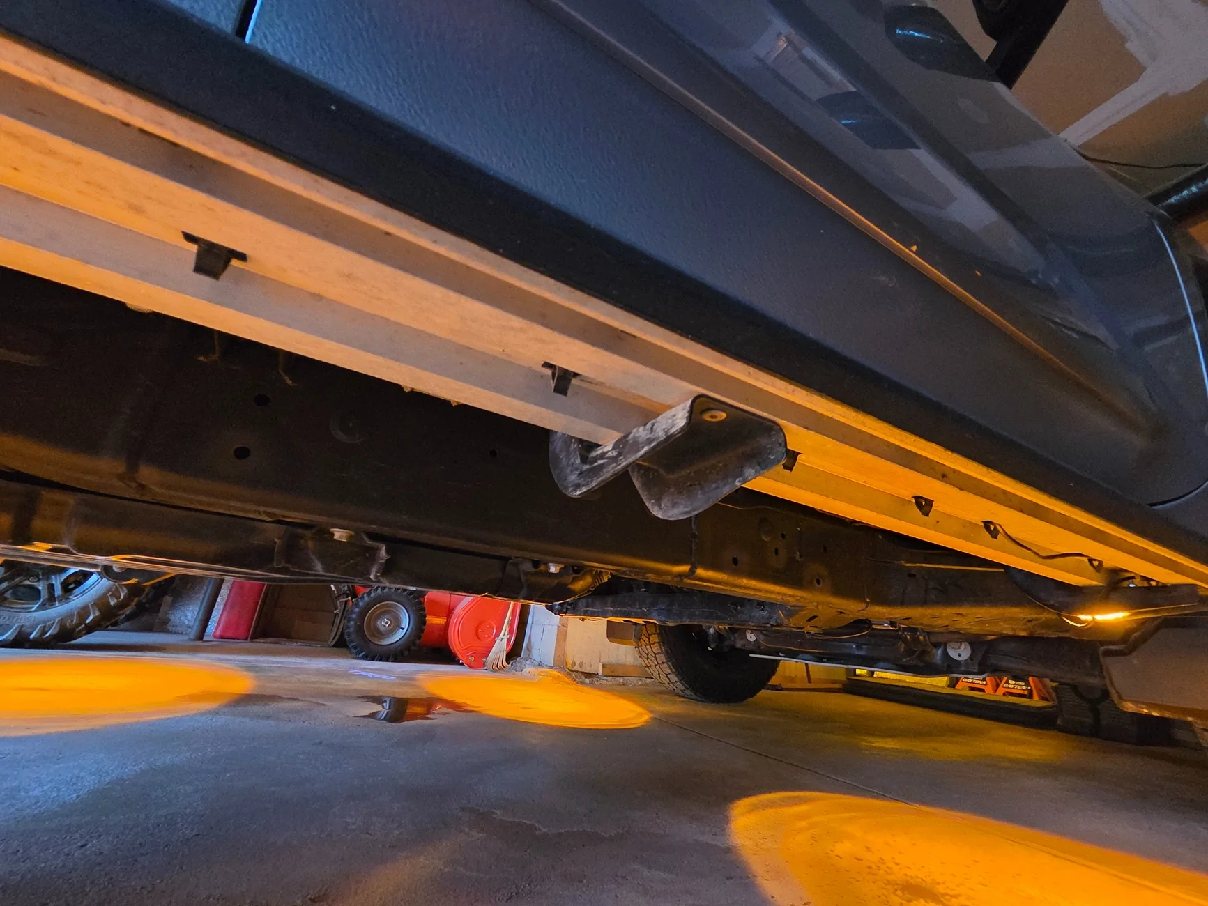

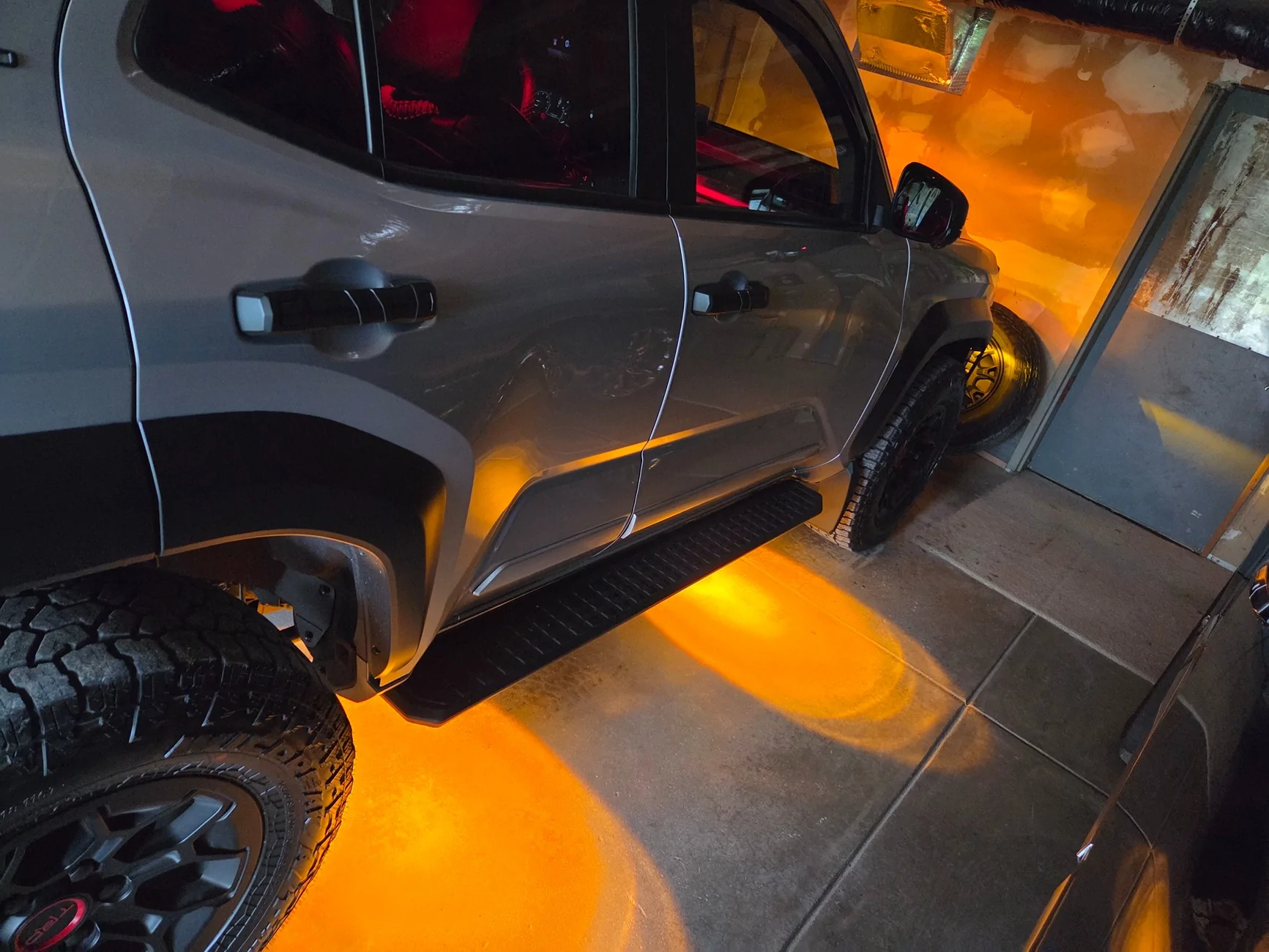

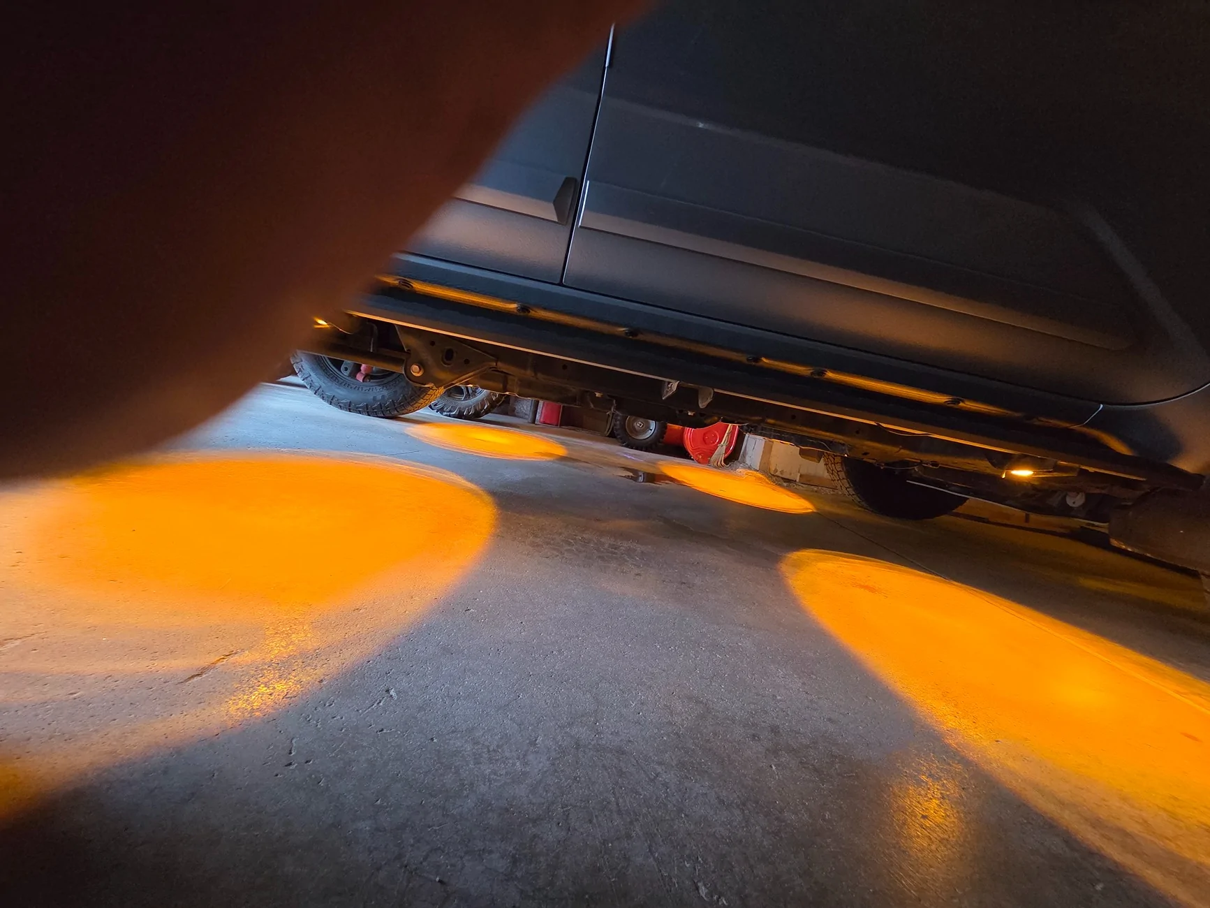

For anyone interested, here is how I installed the Lasfit rock lights on my '25 ORP plus some pictures.
Mounted two pods under each running board inside of the front and rear support brackets. The front ones were tight but the pods fit perfect in the rears. Had to turn them perpendicular but seems to still work well plus they are very well protected by the brackets. Chased the cables along the boards inside channels then to the frame and along the frame cross member (for passenger side cables). Then tied them together and ran up through the driver side engine cavity under the brake master cylinder. Extra cable is coiled and tied in the void between the EUC and driver side fuse box. Cut off the battery connection cable from main cable and ran the remaining three wire cable across in front of radiator and down the passenger side to my switch panel located on a mounting bracket over the battery. Connected the yellow wire (amber light option) and black wire (ground) to one switch and the red wire (white light option) to another switch.
Ordered two more pods to add to the center running board brackets. The cable supplied with the four pod kit has plugs for up to eight pods. May add two more later.
Very happy so far with how it turned out.
