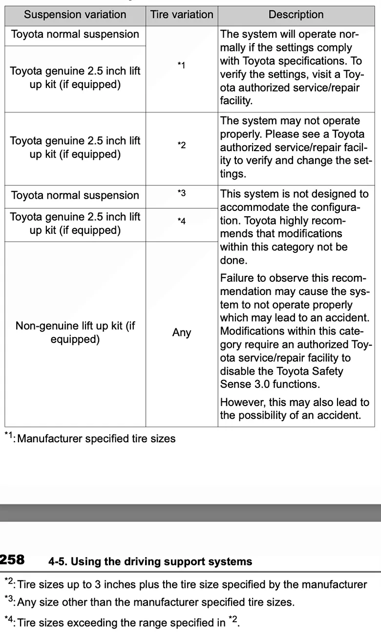

Here is the manual's guidance about tire sizes. Of note:
  • With factory suspension, they do not recommend any tire size other than the manufacturer specified tire sizes
  • With Toyota genuine 2.5" lift kit, they recommend up to 3 inches larger tires than the manufacturer specified tire sizes
  • They don't recommend anything else, including non-Toyota genuine lift kits
It''s not surprising that they would make these recommendations.
I had no second thoughts about running 265/60R20 because they dimensionally match the 265/70R18 on other trims from factory and the Limited wheels have the same 55 offset as those other trims. Still, this violates these recommendations because 265/60R20 is not one of the manufacturer specified tire sizes.
Re: warranty issues, they'd have to prove that you violating these recommendations caused a given issue.
Thanks for posting.
Am curious if anyone has found the "Toyota genuine 2.5" lift up kit" referenced in the manual. I've hunted a bit and cannot find it. Googling that phrase from the manual results mostly in the many after-market lift kits that are available.
I've been toying with the idea of a true lift but not at all committed to it. (I've got 285/70R18s on TRD flat black option wheels (+45 offset) on my TRD ORP with the Peak 1.25" level spacer. Tires just fit without rubbing (with crash plate deleted for now). As I do more and more serious off-roading I seek more ground clearance but so far I've not hit an OnX blue trail (up to 6) that I can't handle with current setup. Might want to try a black trail someday though ....
BTW - my speedometer which is spot on when I'm running the OEM 265/70R18s is low by about 3 MPH at highway speeds around 70-75 MPH. (based on GPS speed readings (Waze, etc.) and radar readings on roadside signs when they appear). This is just about what the math says. I'm baffled by comments above that cite 35" tires with no change and even more by having the speedometer and odometer read HIGH with bigger tires. (makes no sense and is inconsistent with my data - so I'm curious why my experience is different). And to be clear - the speedometer has not adjusted after over 2000 miles with the big tires - and I've swapped back and forth so would have seen any adjustment.
