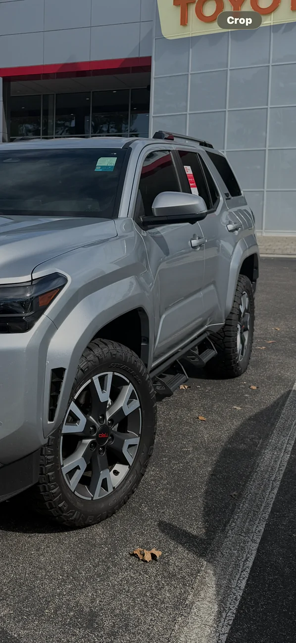

Anyway, I've seen so many mods that are very interesting like downsizing 20" wheels to 17's, and increasing from 33" tires all the way up to 37". Very cool, but for the average 4runner lover out there who doesn't want to mess with steering components and such, can someone share some mild mods to make the truck look a little beefier? I have the standard OEM 20" TRD aluminum wheels that look nice (but only 8' wide) and the dealer threw on some 265/50R 20 Nitto ridge grapplers which really changed to look of the truck much to my liking.
Here's by mod question, and let me first say that I do not want to lift the truck - its tall enough for me to get into it the way it is. I would like some really cool 20x9 wheels, maybe even 20x10's so that I can put on some Nitto Ridge Grappler 285/60R 20's. I may do a cold air intake and exhaust once the warranty is expired, but I need help in determining the widest 20" wheel I can safely put on the stock 4Runner and the largest tire for the recommended wheel. My ride looks pretty good right now, I just want a bit more stance and tire width. Can you help please?

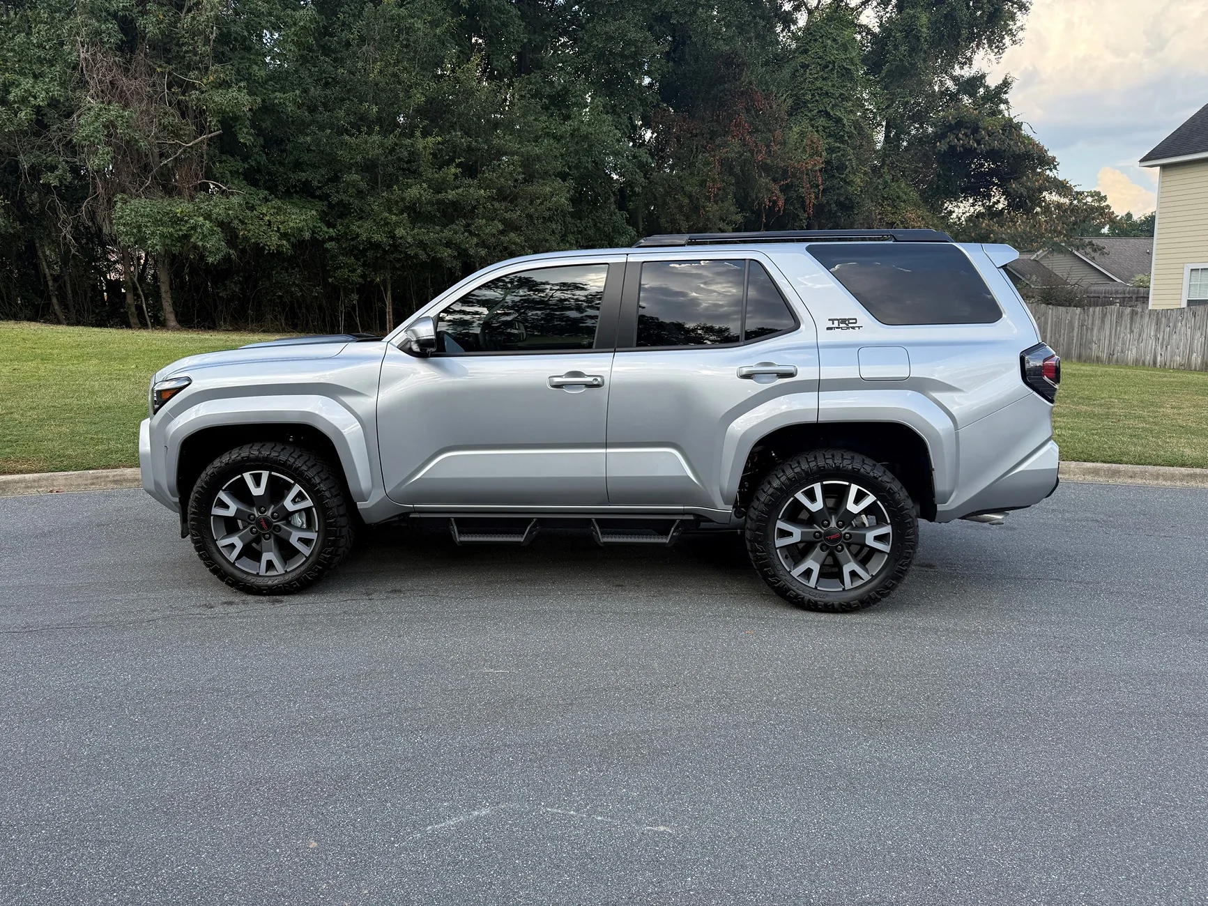

Thanks for the response. I’d say no more than 2-3 inches past the fender flare. I should have taken a picture of the truck from the front or rear to get a better idea of what would be attractive for what most will consider a stock truck. The ridge grapplers look pretty wide as they are but I think the rim width at 8ā€ is a bit too narrow for the tires they put on the truck. This additional picture may give you a better idea of how wide the stance is right now. Thanks.

At 2-3" past the flare, you're going to find yourself cutting to get those to not contact at full lock since you don't want to lift it.

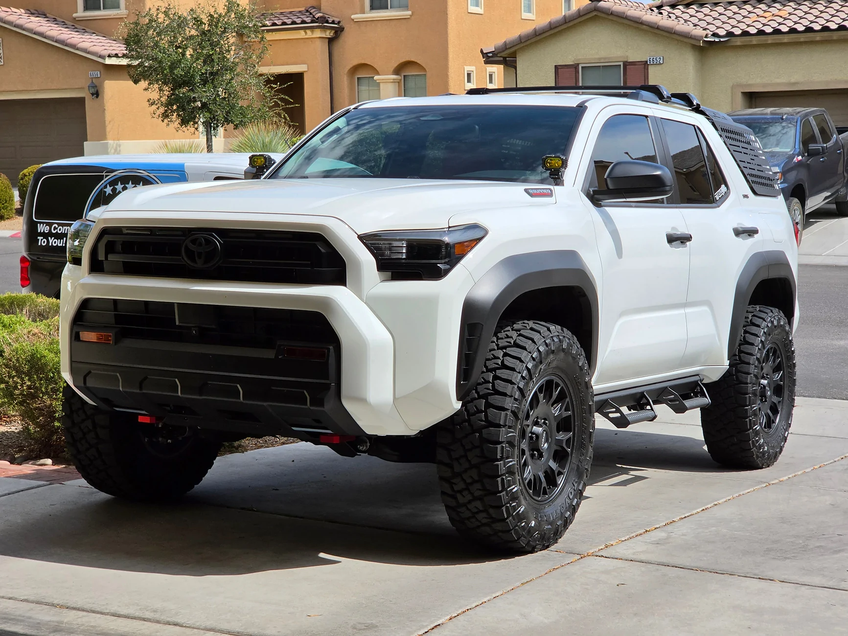

2026 TRD Sport Premium / WCP
I have the Sport Premium as well. Just get the 18" Pro wheels and you'll be set. No lift or mod required.

BonRunner - your truck is SICK!! That's exactly what I am seeing in my mind! A mean looking 4Runner that can do some hard work when needed, but look bad a$$ the rest of the time. I like the micro-squatted look. I'm saving a pic of your ride for inspiration. Thanks!
Thanks! I posted new pics with upgraded headlights for improved visibility & brighter lights output:
https://www.4runner6g.com/forum/threads/alpharex-nova-series-og-style-headlights-installed.12242/
Feel free to save them!
