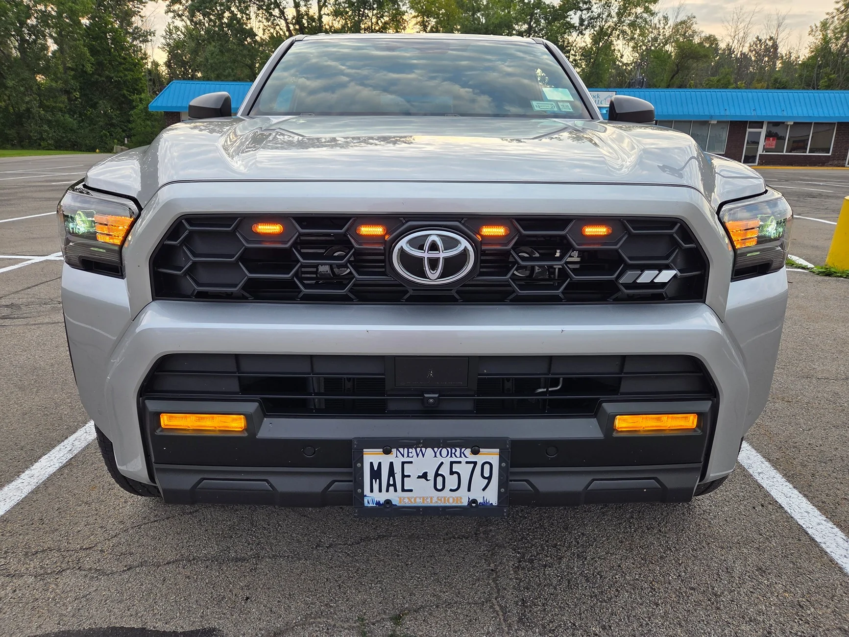

Here is a pic with the fog lights on with DRL's, raptor lights, dark chrome illuminated sombrero emblem, and Lasfit turn signal bulbs (amber). I'm liking the versitility plus it looks cool.
2025 2026 4runner 6th gen Installed: Aspire Wide View Side Mirrors and Brite Box (High Beam, Low Beam, & Fog Light Mod) 20260812_073221
