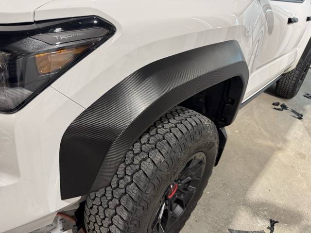

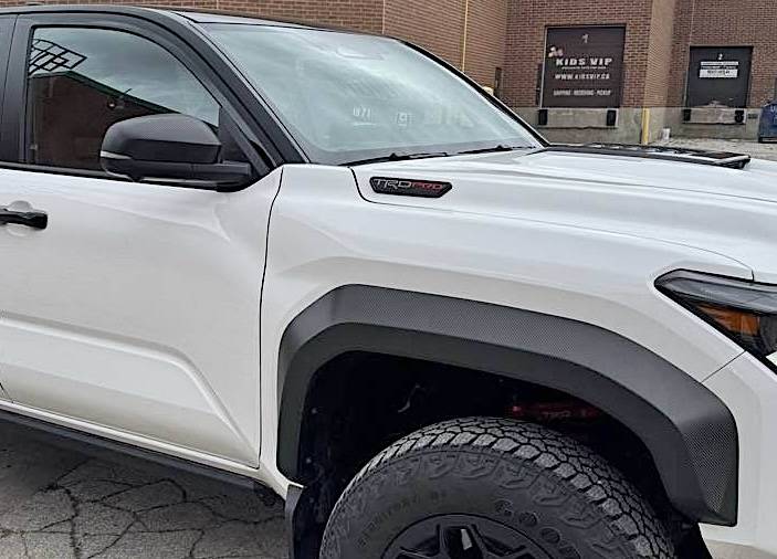

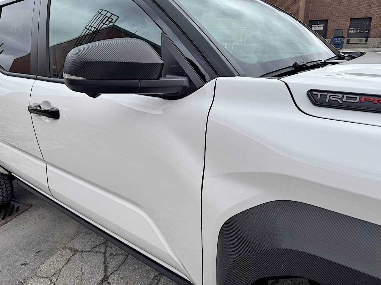

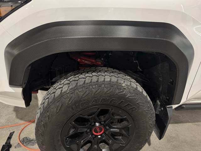

Someone applied 3M carbon fiber vinyl wrap on their Tacoma fender flares and side mirrors (same parts as on the 2025 4Runner). The vinyl wrap protects the flares and mirrors against scratches, pinstripes, rock chips, while also giving a cosmetic upgrade.

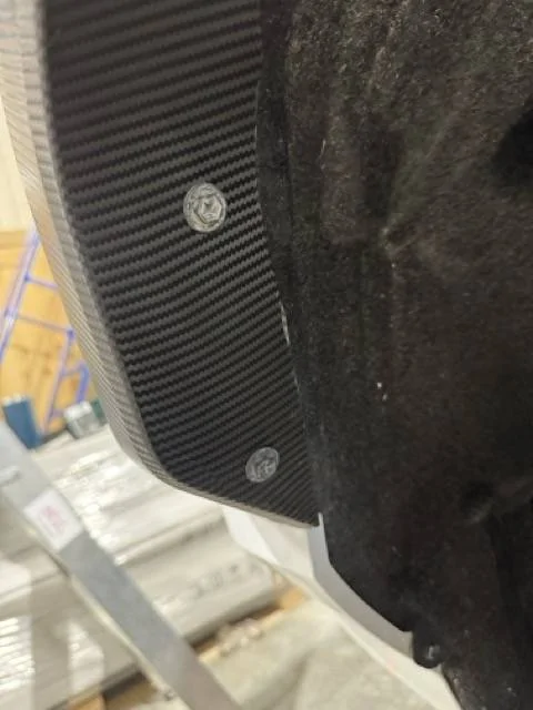

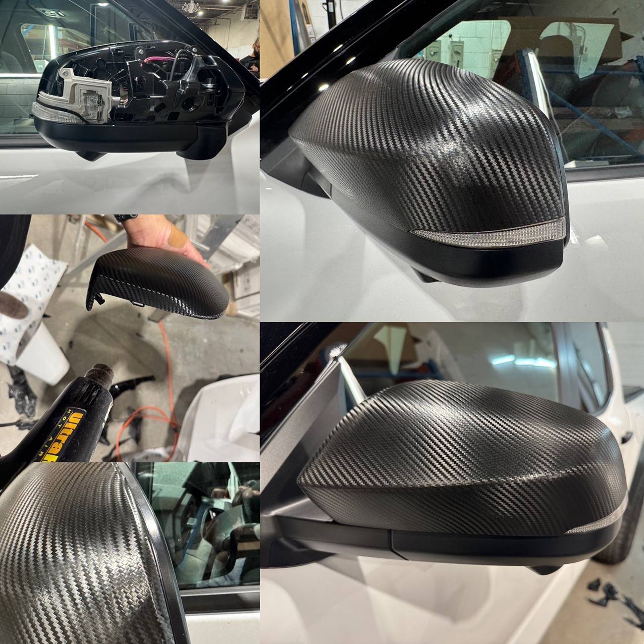

Process: Fender bolts were loosened, fenders pulled out slightly to allow for folded edges behind/underneath and hand tightened when re-secured. Mirror covers also removed.
