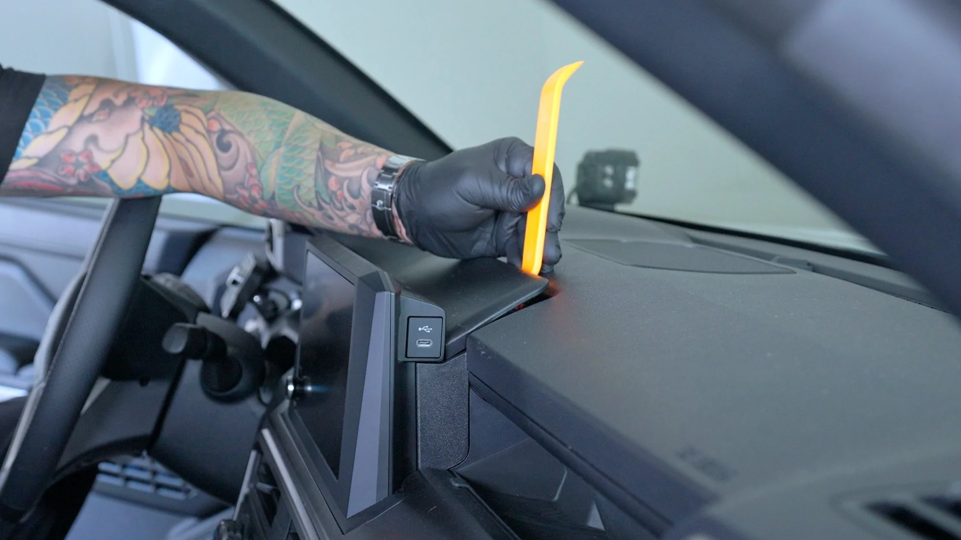

2025 2026 4runner 6th gen Installed Aftermarket 14 Inch Screen Head Unit Upgrade (CarTrimHome C12) Trim Removal
First thing you will want to do is pop off the trim piece right in front of the factory radio. You can use the provided trim tools to wedge and pop off the trim.

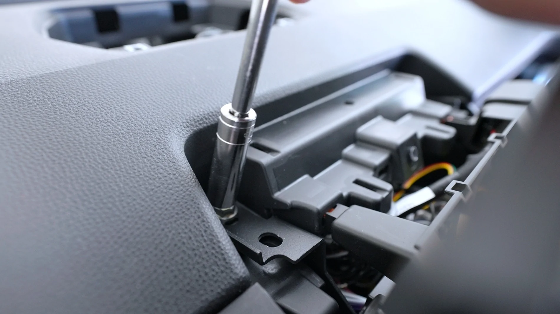

2025 2026 4runner 6th gen Installed Aftermarket 14 Inch Screen Head Unit Upgrade (CarTrimHome C12) 10mm Bolt Removal
Next, remove the (4) 10mm bolts that attach the factory radio to the dash. This is the only step that requires tools, use a 10mm socket for removal.

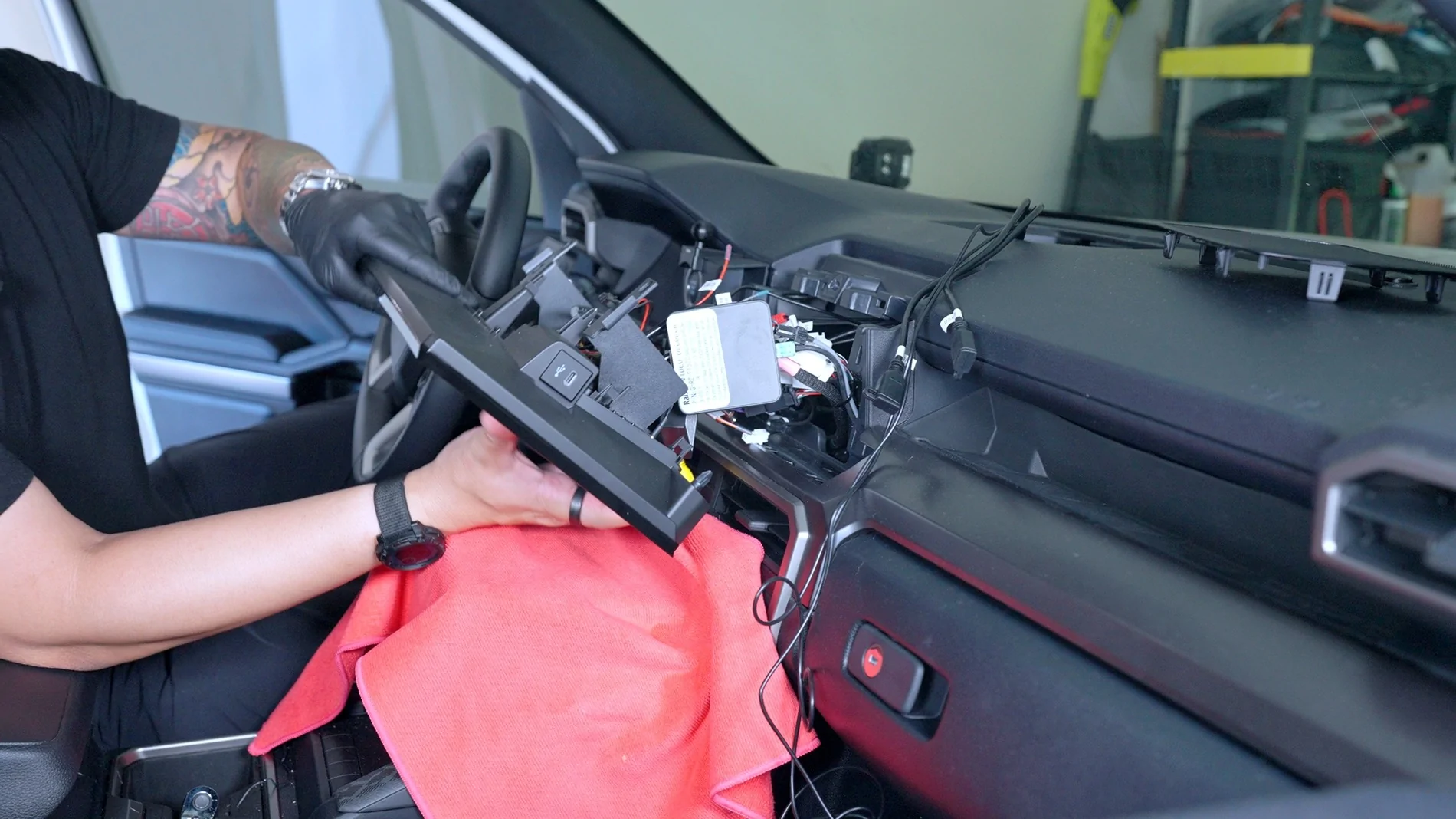

2025 2026 4runner 6th gen Installed Aftermarket 14 Inch Screen Head Unit Upgrade (CarTrimHome C12) Factory Radio Removal

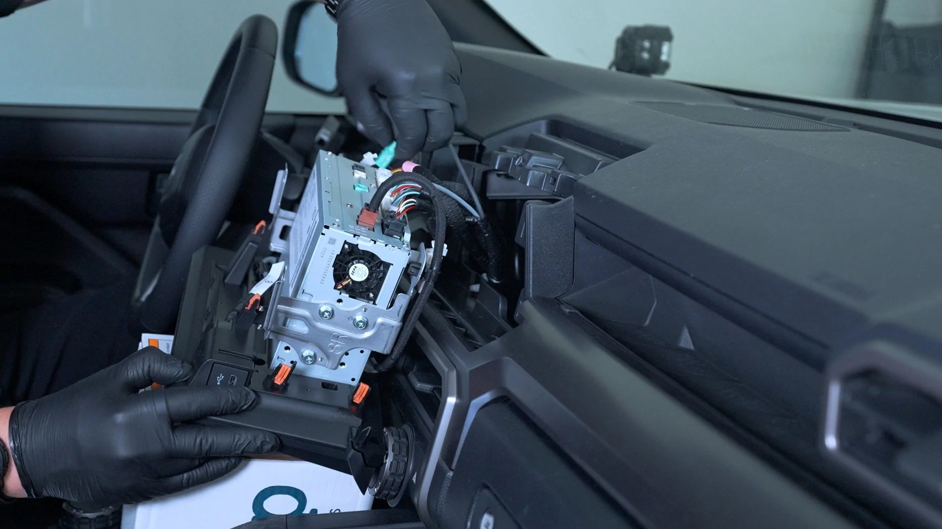

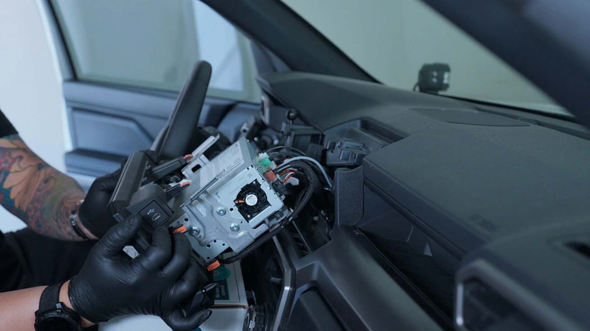

The factory radio will then slide right out. I would suggest placing a small box over the shifter so you have a flat surface to set down the radio without creating an scratches on the radio or your dash.
2025 2026 4runner 6th gen Installed Aftermarket 14 Inch Screen Head Unit Upgrade (CarTrimHome C12) Factory Radio Plugs
You can now remove all plugs and connectors from the factory unit. Again, these connectors are all different so there is no way to plug incorrectly.

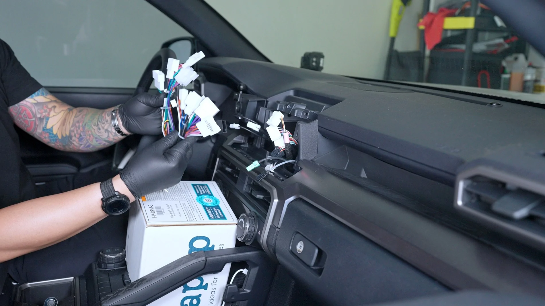

2025 2026 4runner 6th gen Installed Aftermarket 14 Inch Screen Head Unit Upgrade (CarTrimHome C12) Main Power Harness
NOTE:
The CarTrimHome 14" screen comes with 2 MAIN Power Harnesses but you only need to use one. I was able to use the harness labled "Toyota Camry". You can then start connecting the aftermarket harness to the factory wire connectors.
2025 2026 4runner 6th gen Installed Aftermarket 14 Inch Screen Head Unit Upgrade (CarTrimHome C12) Installing CTHome Screen
I go over some of the wiring in my YouTube video but the manual that comes with the head unit also shows you where to connect each plug into the aftermarket head unit. Again, this is hard to mess up since each plug is different.

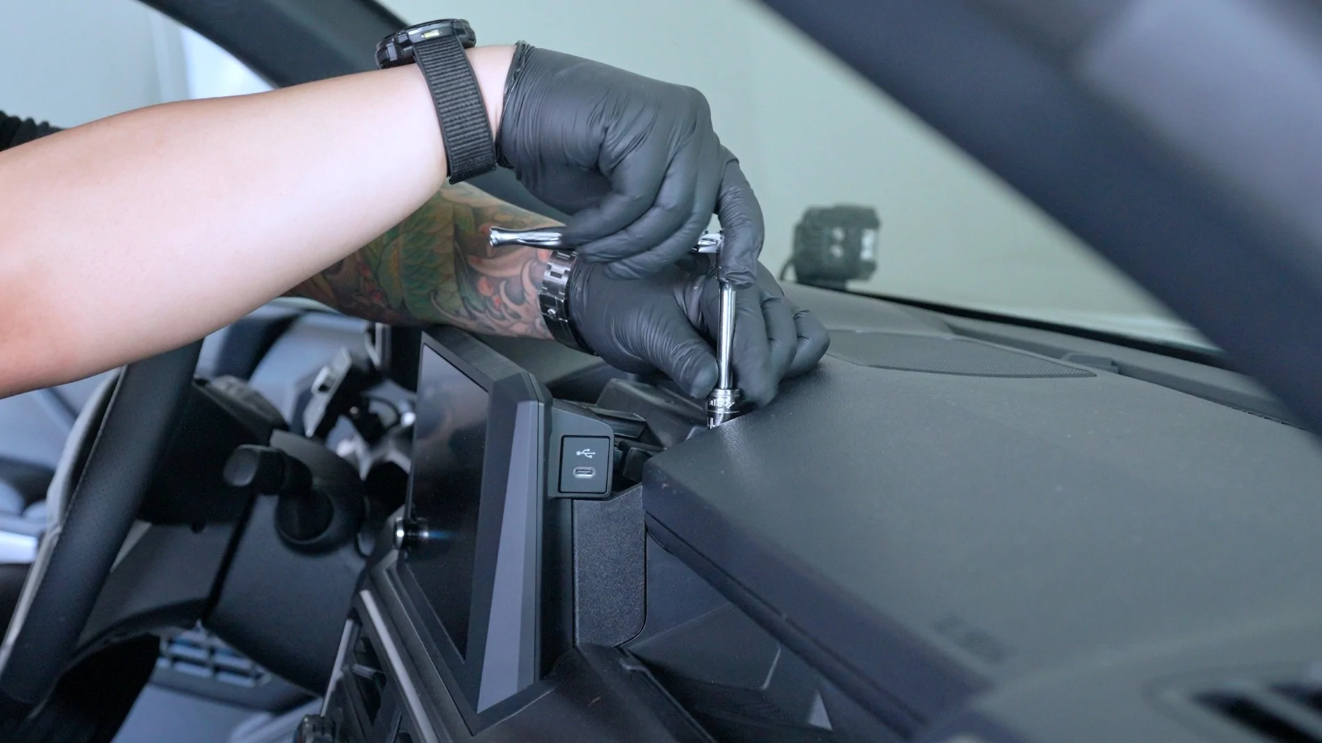

2025 2026 4runner 6th gen Installed Aftermarket 14 Inch Screen Head Unit Upgrade (CarTrimHome C12) Two Mounting Bolt
When bolting the aftermarket head unit back to the dash, you only need to use TWO of the factory bolts instead of FOUR.

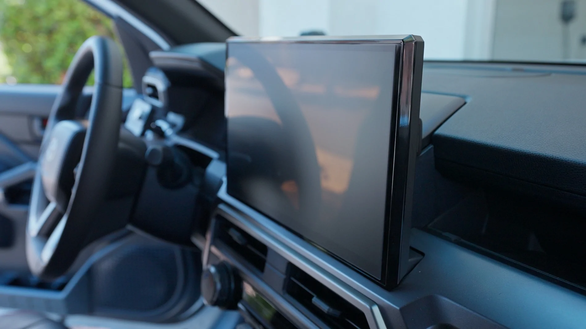

Here are some shots of the UI and Apps:
Everything worked as it should and I haven't had any issues. I did need to make some setting adjustments but I go over that in my video.

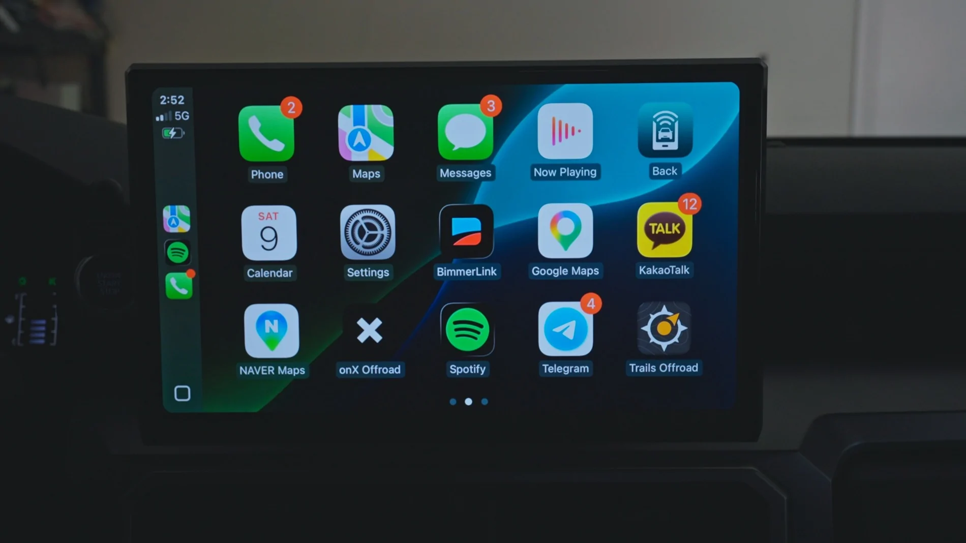

  • Wireless Apple Carplay and Android Auto - âś…

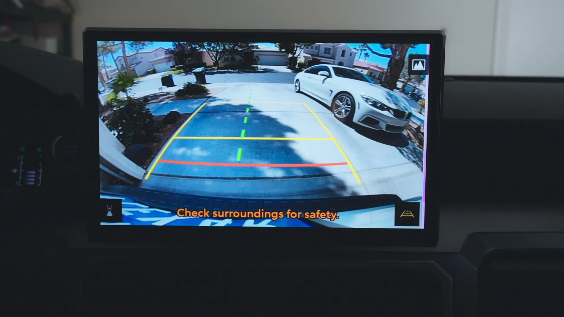

  • Reverse camera display - âś…

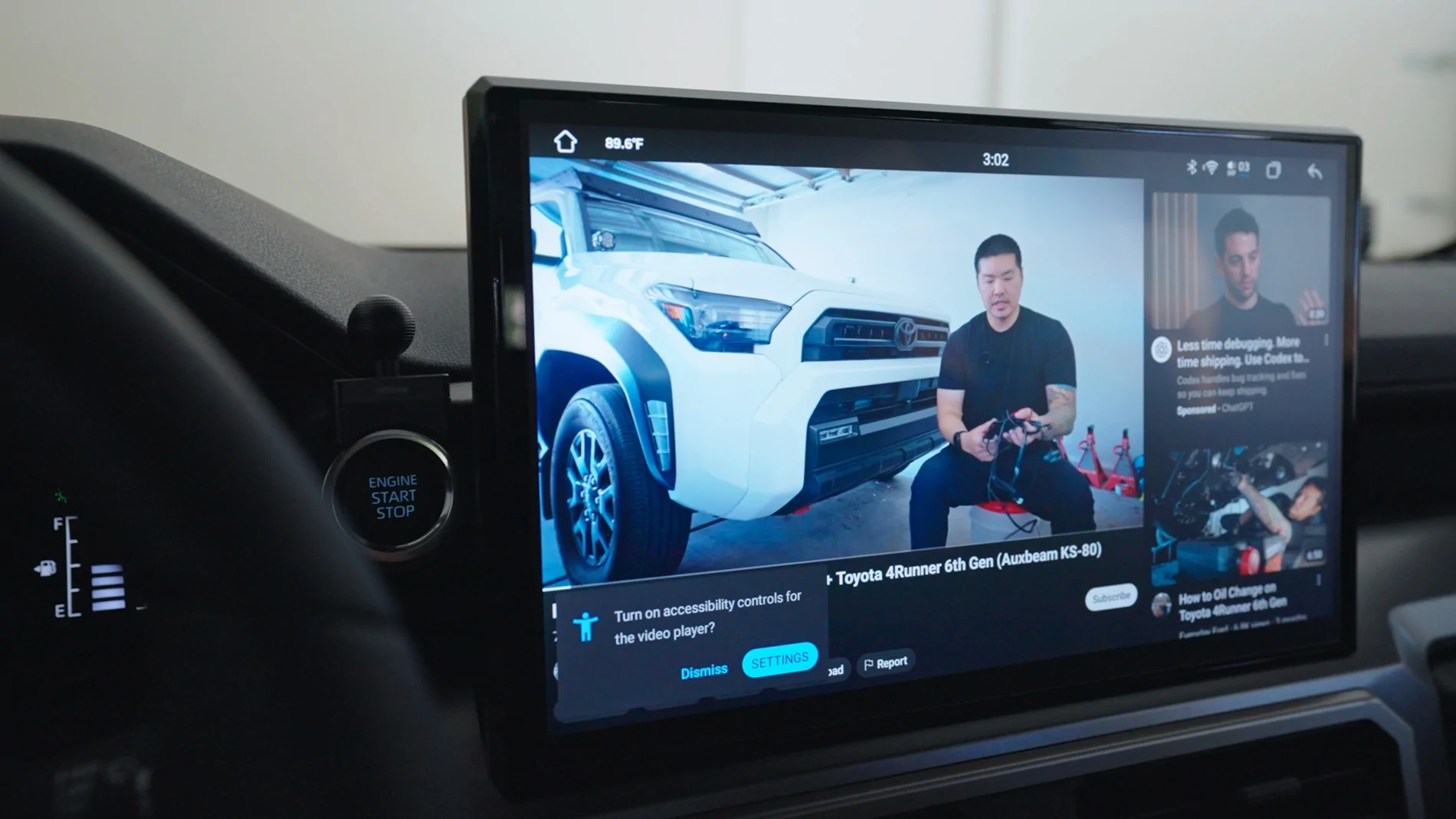

  • Google Playstore (tons of apps) - âś…
  • Watching video (YouTube, Netflix, HBO, ect) - âś…
NOTE:
You may notice there is no volume knob, I did talk to CarTrimHome and they showed me a prototype of the volume module they are working on which would be installed in the same location as the factory 14" screen volume knob. But the knob is not really necessary since the steering wheel controls work and you can also use gestures on the screen. A two-finger swipe up or down will raise/lower the volume
