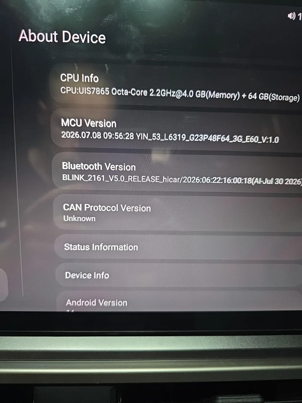

Just installed the c12 in my 2025 4runner and have no audio steering wheel controls. I hooked up everything correct amd even triple checked my plugs and made sure the canbus was good as well. I did everything that cthome said to do on the sight for troubleshooting but no luck. Anyone run into this issue? Also in the pic is it supposed to say unknown for CAN protocol version?

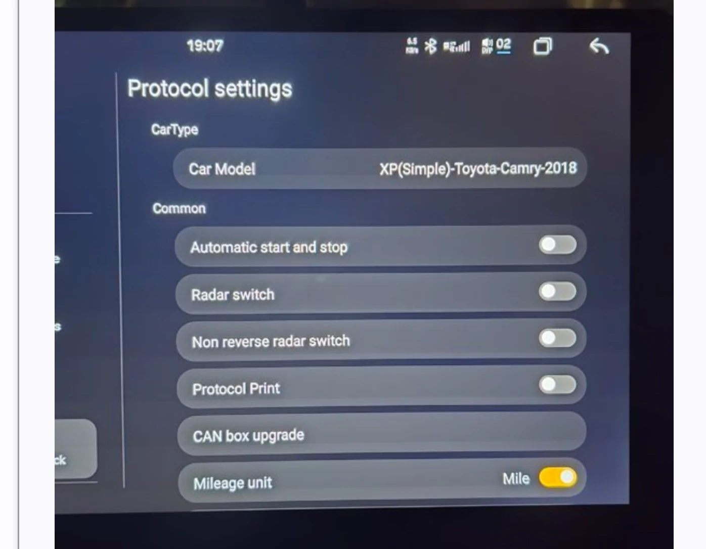

Hi may I ask you if you have connected the small can box in the harness and if yes what do you have in Protocol settings - Car Model ?
See picture
Also in the Applications there is a AppStore icon , not the Play Store. In there you will see some applications from CTH, see if there are any updates . If there are update them
