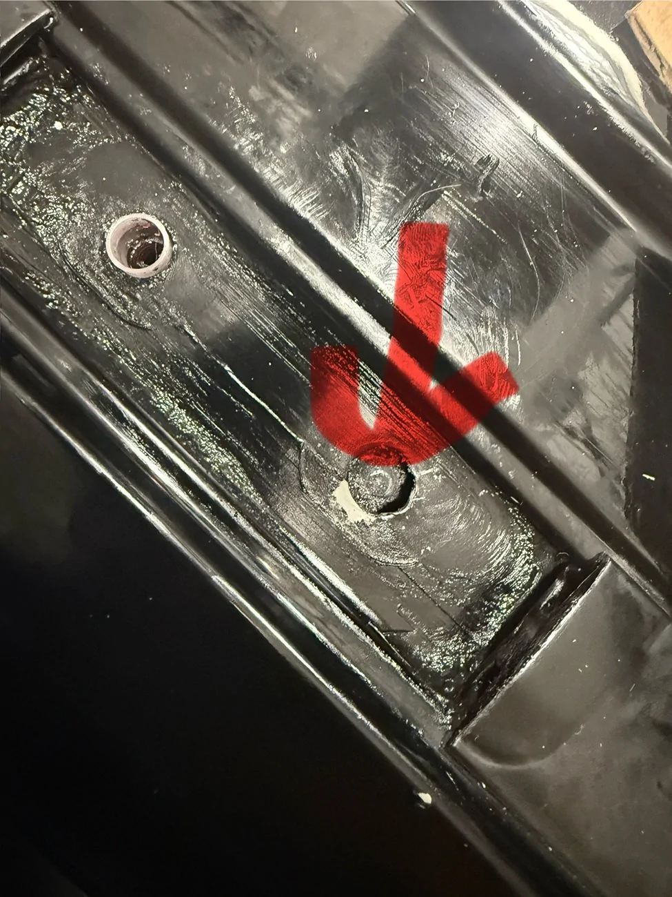

I was replacing the roof rails on my sr5, to the arb roof rack. Very simple I know. But I got to the last bolt and I broke it off inside the housing. I tried using an extractor kit, but no luck because the housing seems to glide up and down. Anyone know what I can do? I think I need to get into the ceiling of the interior and replace that whole thing. Any have a part number for it? Any help would be thankful.

Not sure how this works on the 6th gen, but on my 4th gen these two bolts would be screwed on to a common backing plate. In other words, if you put a bolt in the other hole you might be able to stabilize the broken bolt enough to start getting it out.
If that doesn't work, $30 on techinfo.toyota.com will show you how to remove the roof headlining assembly in 80 easy steps!
Wish you the best of luck.

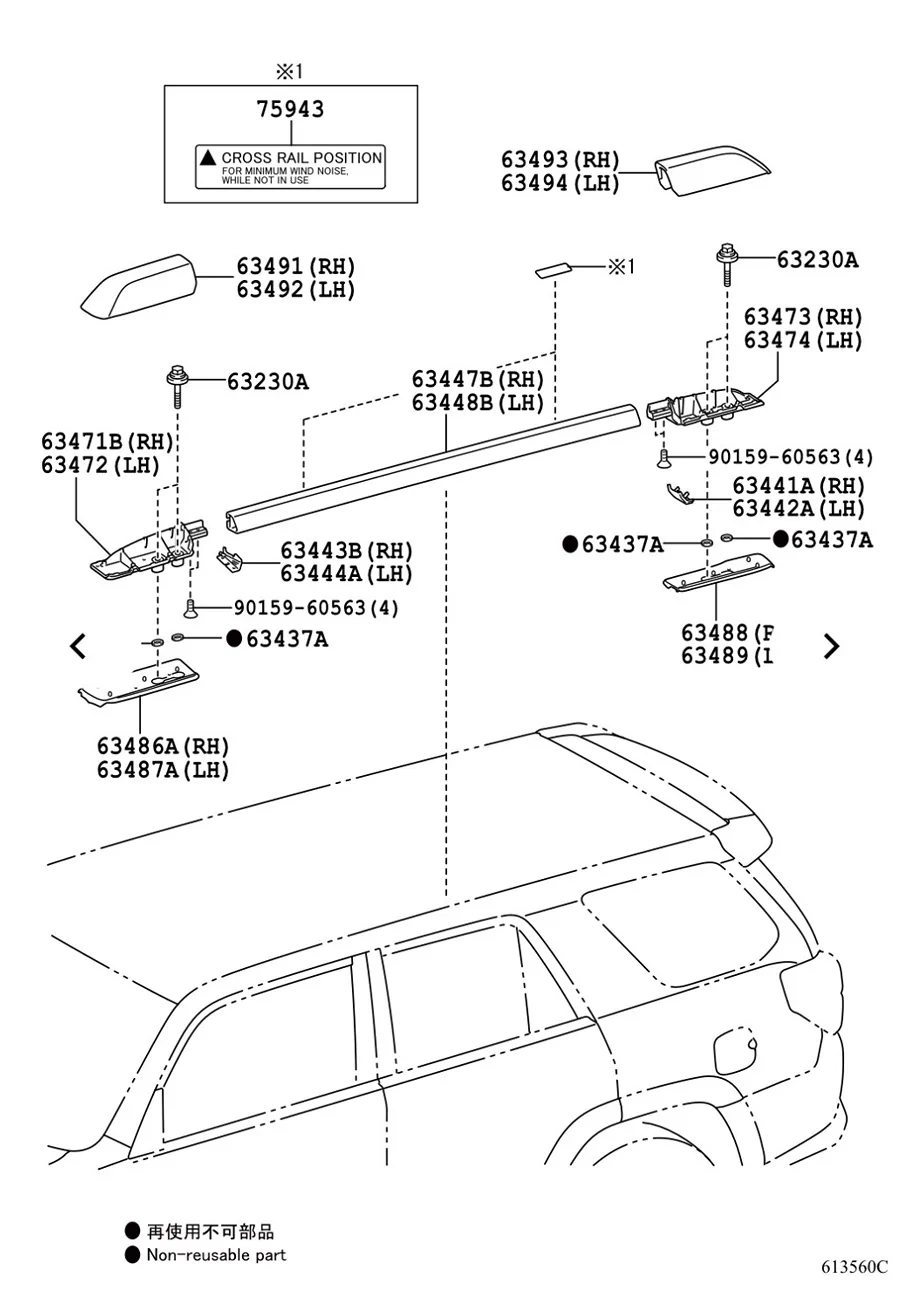

2025 2026 4runner 6th gen Help!! Roof rack bolt snapped inside socket housing. IMG_8607
