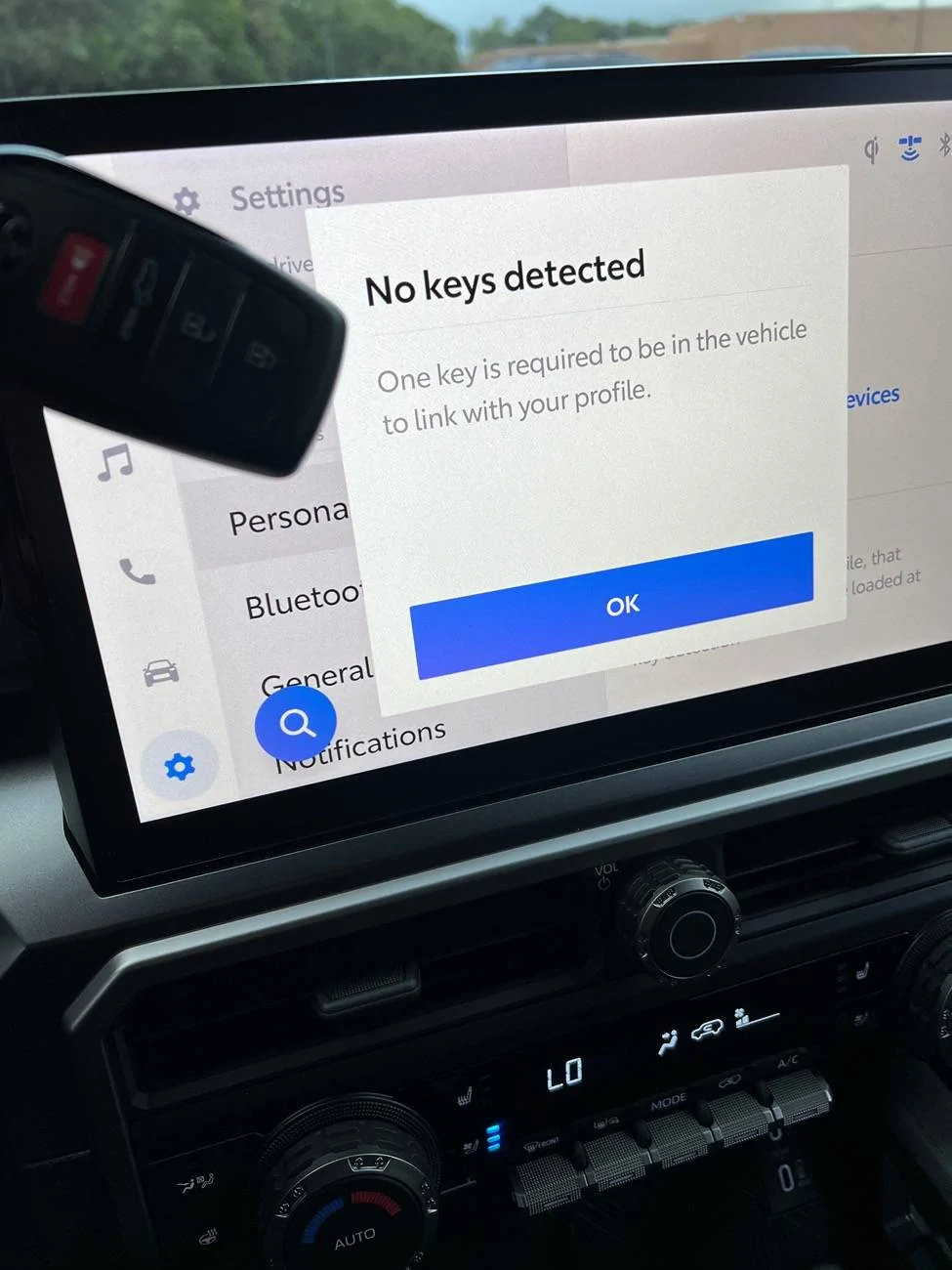

I also noticed my key isn't linked for some reason. When I press to link it tells me no key is detected even though its in my hand. Cant figure out how to get it to read the key and link it

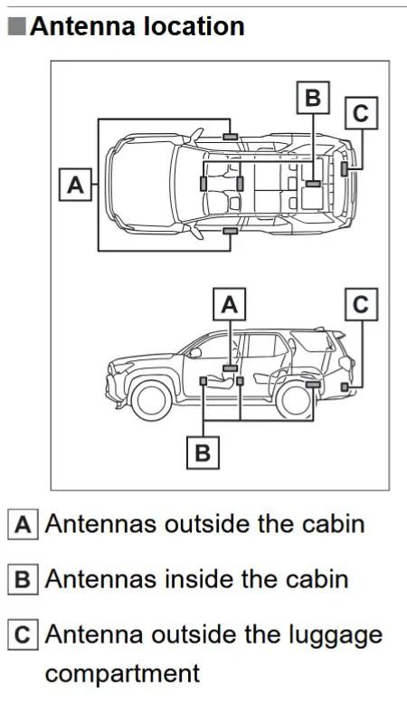

there are 6 sensors for the fob.

well the "B" antenna is located near the bottom of the center console, its not behind the multimedia screen (since people like to leave the fob in the cup holders by the driver and in the rear cupholders attached to the rear center console sometimes)

pic was to show its not reading it. its going to the dealer today because the tint installer messed something up.

sorry to hear that, but for the life of me i cant see how installing tint would when get close to door antenna. that is the only thing i could think would cause an issue unless he accidently cut a door sensor wire.
but then again why would he be that far down the windows to even get close to a door sensor wire.
its a stretch to maybe cut a wire to short the whole door sensor network.

can you hold the fob and touch the start button with the fob to start the vehicle ???
thats is the emergency procedure to start a vehicle if a fob is dead
