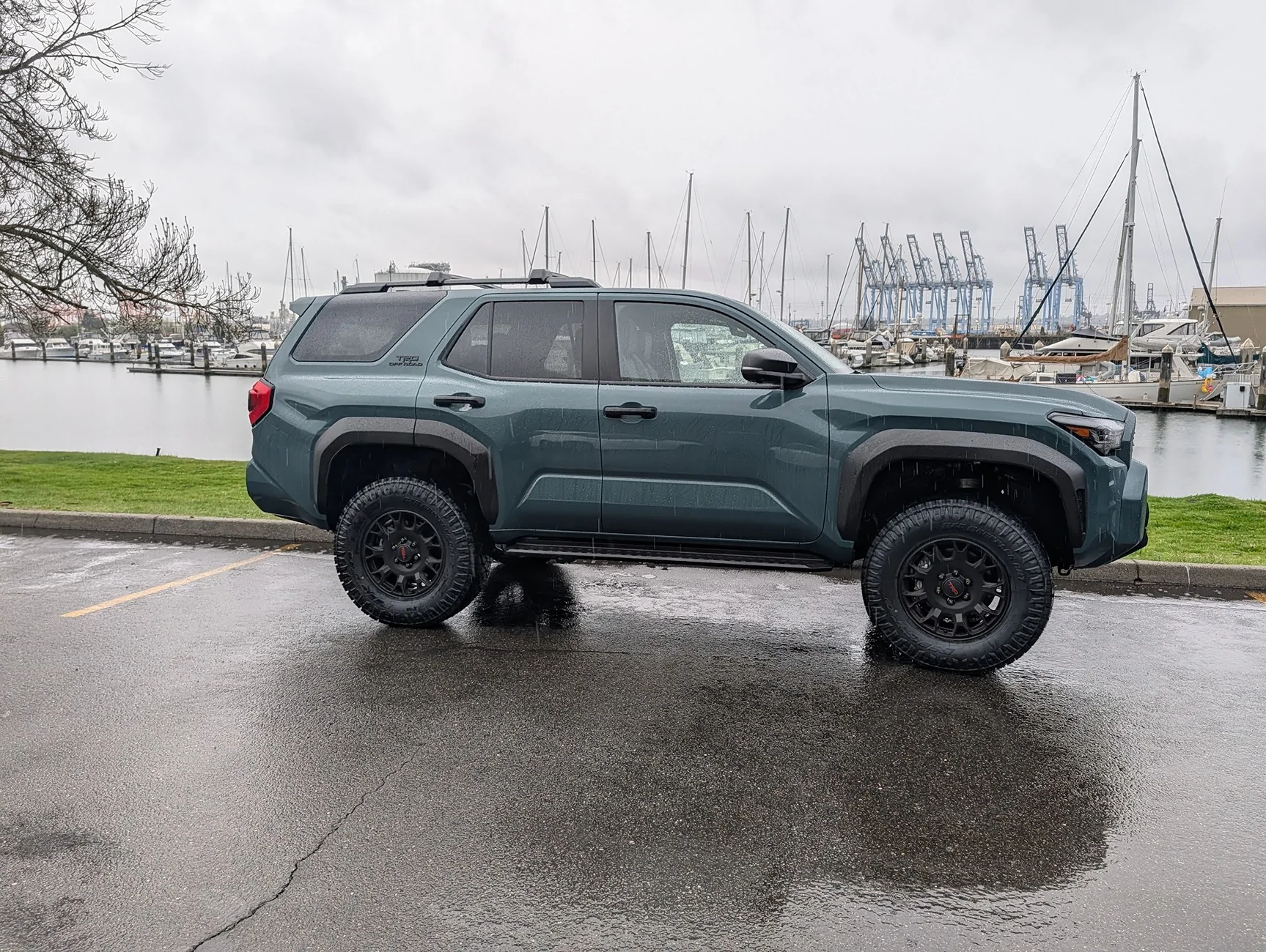

Here are Nitto Exo Grappler LT285/70R18 (33.98") on the factory 18" wheel upgrade with +45 offset.
ReadyLift 2.5" also installed.
This is an awesome setup!!! How is the tire poke? Must be minimal?
