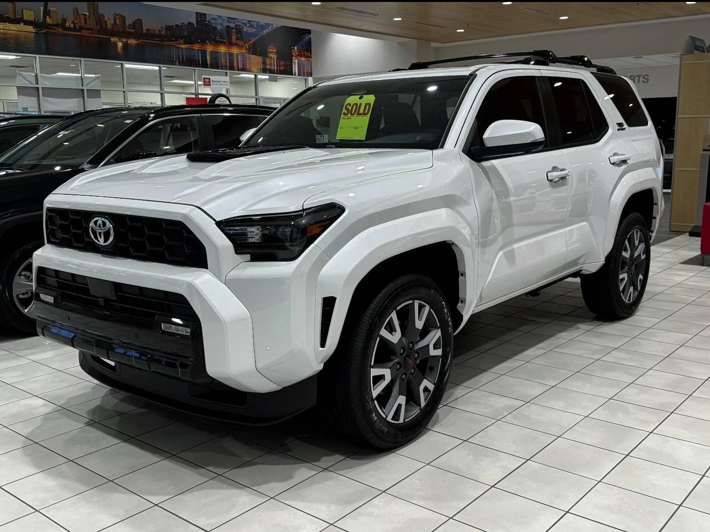

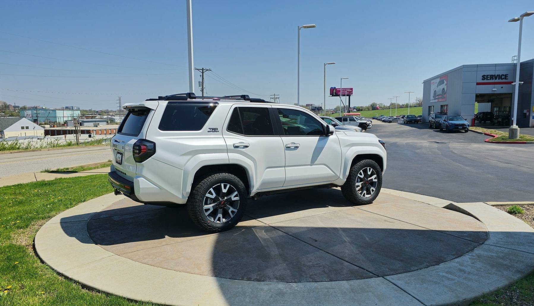

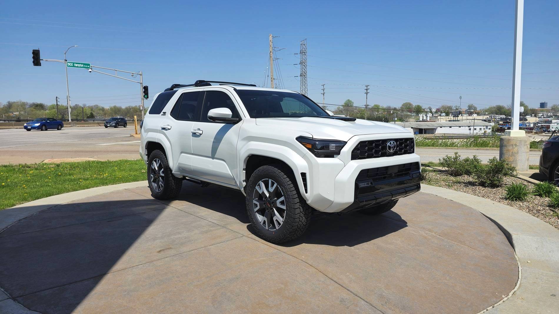

TRD Sport Premium. 275/60R20 Falken Wildpeak AT4Ws going on tomorrow. Taking possession Friday. Have only seen one other 6th gen so far around the STL region, and it belongs to a local aftermarket company (Diode Dynamics). They've been slow to hit the midwest, glad to finally get mine!
2025 Toyota 4runner TRD Sport 20" wheels on bigger tires: 275/60/20 Falken Wildpeak AT4W Tires (275/60R20) 1000016357
2025 Toyota 4runner TRD Sport 20" wheels on bigger tires: 275/60/20 Falken Wildpeak AT4W Tires (275/60R20) 1000016355

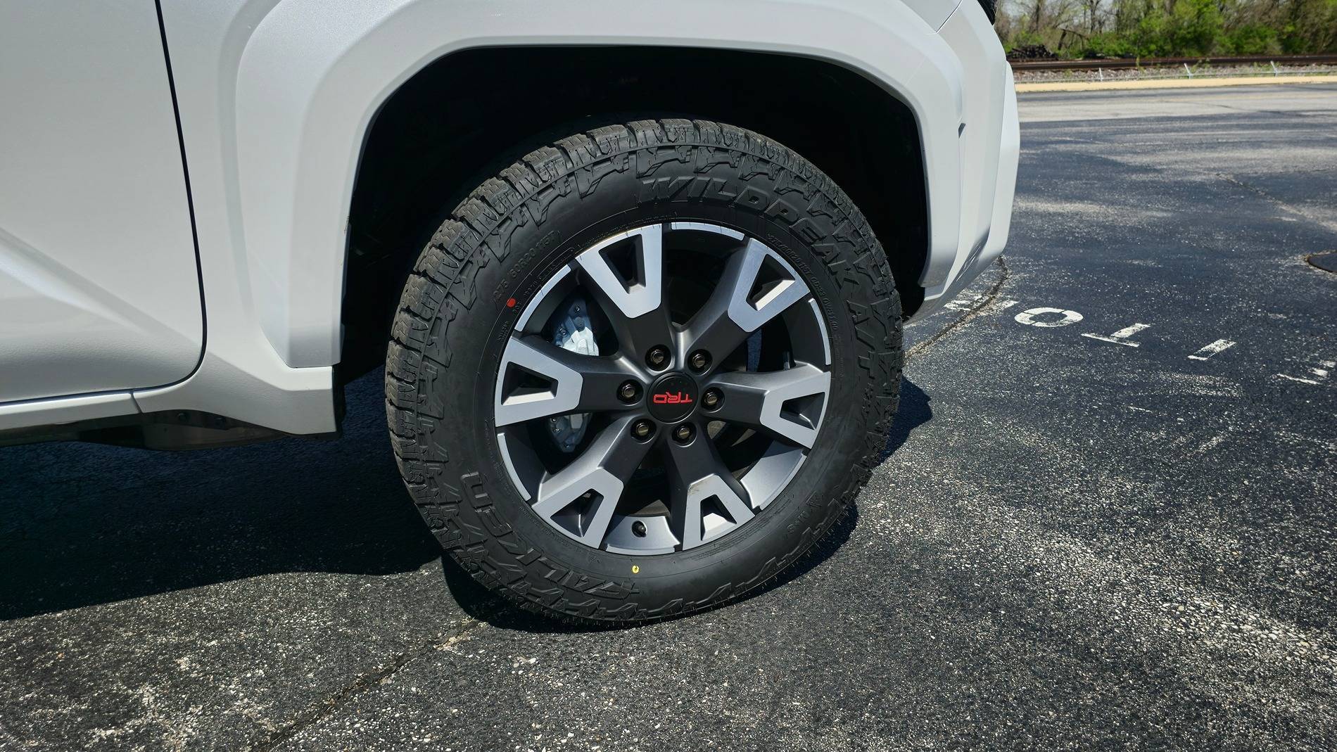

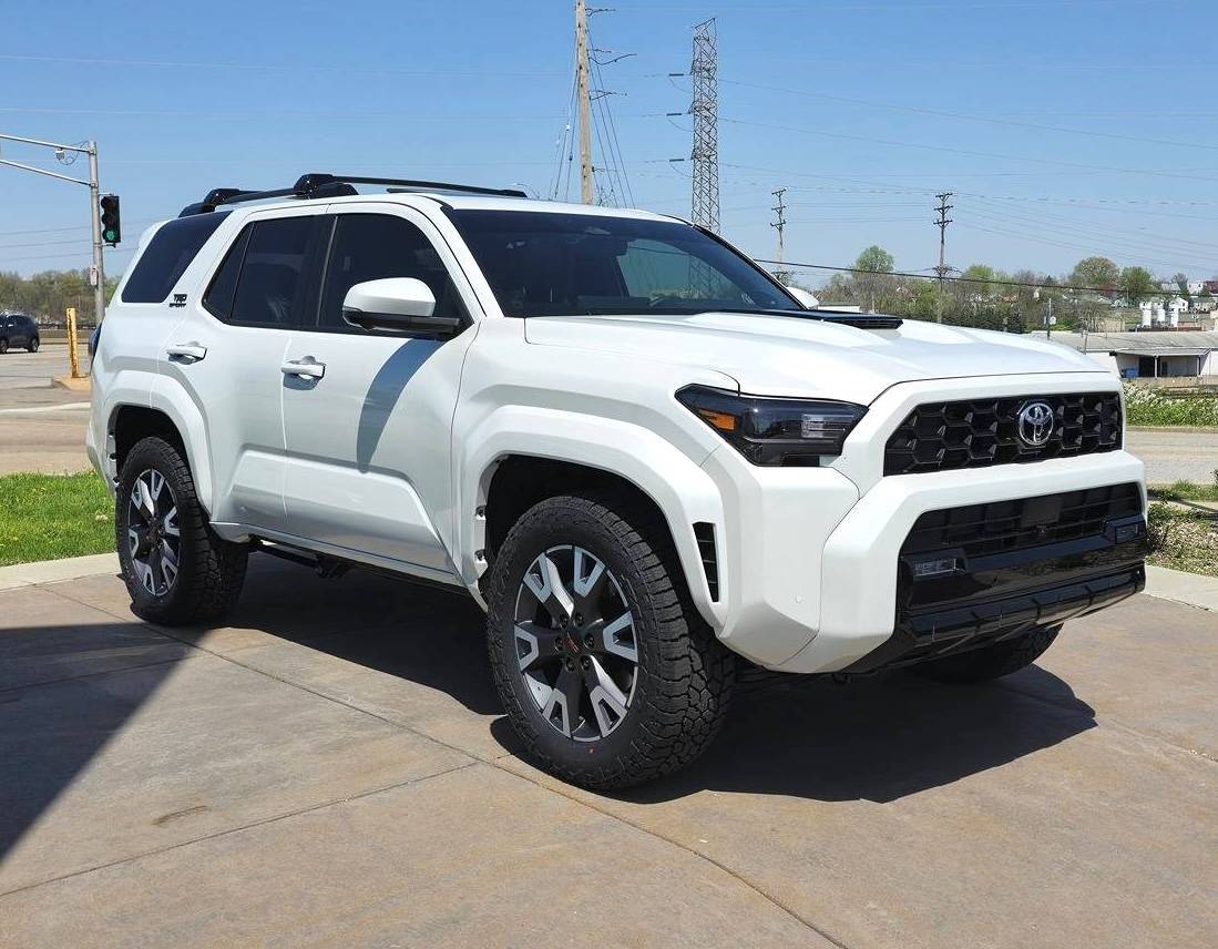

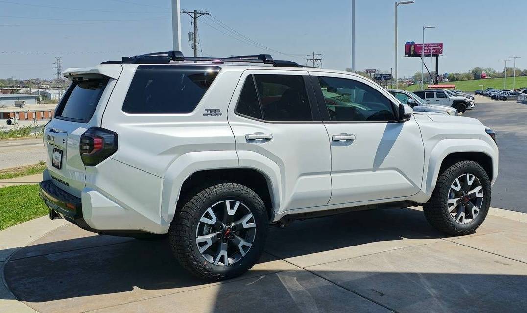

UPDATE:
Just got the tires 275/60/20 Falken Wildpeak A/T4W put on today.
2025 Toyota 4runner TRD Sport 20" wheels on bigger tires: 275/60/20 Falken Wildpeak AT4W Tires (275/60R20) d-sport-275-60-20-falken-wildpeak-at4w-tires-3-
2025 Toyota 4runner TRD Sport 20" wheels on bigger tires: 275/60/20 Falken Wildpeak AT4W Tires (275/60R20) port-275-60-20-falken-wildpeak-at4w-tires-5jpg-
2025 Toyota 4runner TRD Sport 20" wheels on bigger tires: 275/60/20 Falken Wildpeak AT4W Tires (275/60R20) d-sport-275-60-20-falken-wildpeak-at4w-tires-1-
2025 Toyota 4runner TRD Sport 20" wheels on bigger tires: 275/60/20 Falken Wildpeak AT4W Tires (275/60R20) trd-sport-275-60-20-falken-wildpeak-at4w-tires-
2025 Toyota 4runner TRD Sport 20" wheels on bigger tires: 275/60/20 Falken Wildpeak AT4W Tires (275/60R20) 20250408_172225-
2025 Toyota 4runner TRD Sport 20" wheels on bigger tires: 275/60/20 Falken Wildpeak AT4W Tires (275/60R20) 20250408_172417-
2025 Toyota 4runner TRD Sport 20" wheels on bigger tires: 275/60/20 Falken Wildpeak AT4W Tires (275/60R20) 20250408_172309-
2025 Toyota 4runner TRD Sport 20" wheels on bigger tires: 275/60/20 Falken Wildpeak AT4W Tires (275/60R20) 20250408_172400-
2025 Toyota 4runner TRD Sport 20" wheels on bigger tires: 275/60/20 Falken Wildpeak AT4W Tires (275/60R20) 20250408_172341-

Those tires look sharp on the TRD Sport Premium! Congrats!
Question for you: Could you please tell me if the lug nuts are a flat black or black chrome color?
Perhaps you could please describe them so I have a clear idea of what to expect. I'm probably going to buy the Toyota wheel locks for my incoming Cutting Edge TRD Sport Premium but I'm not sure if I should get the Black Chrome color option to match the factory lug nuts or get the regular Chrome option which seems like I would need to buy a new set of chrome lug nuts also.

They are black chrome

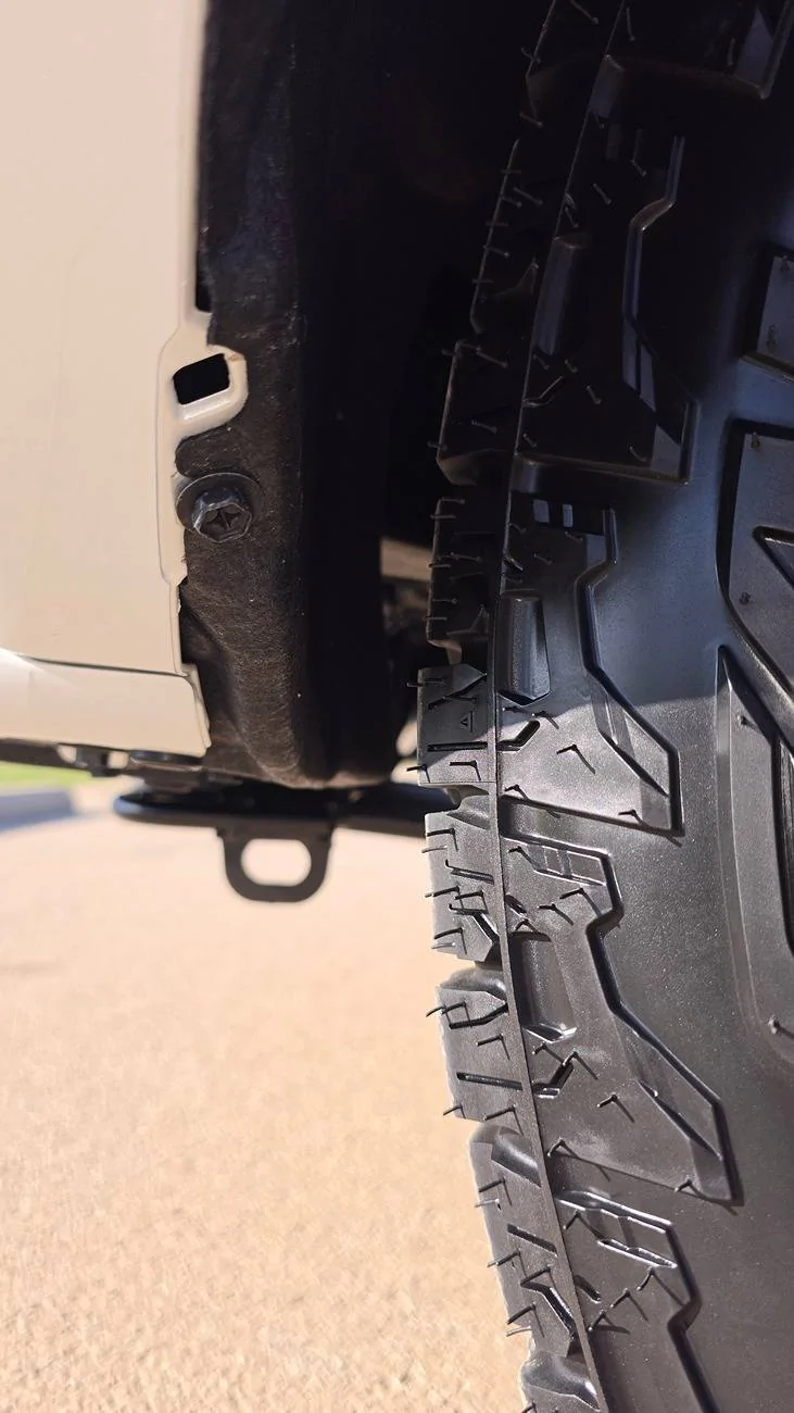

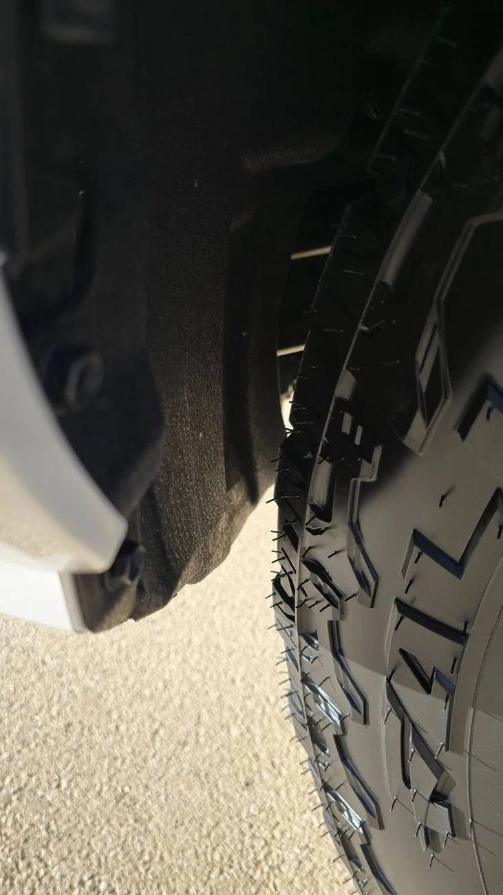

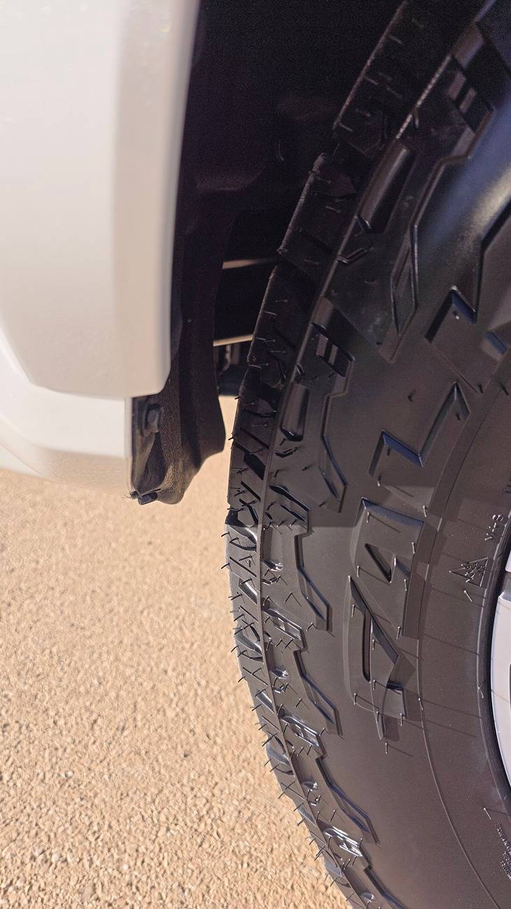

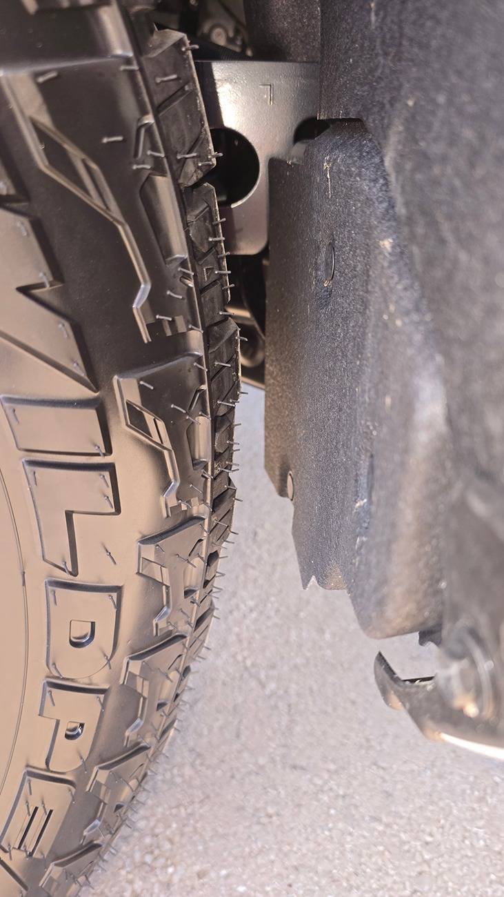

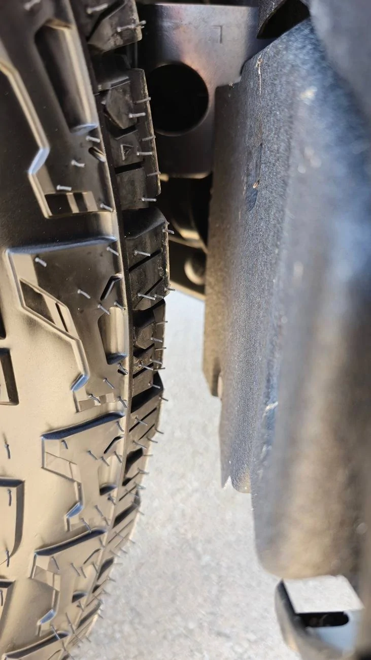

Hi, I was thinking about doing something similar. Is there any rubbing? Did you have to do anything or it just fits perfectly? Thank you!
ngfilla94
ngfilla94
Nathan
Jun 22, 2024
60
71
St. Peters, MO
2025 TRD Sport Premium
There is no rubbing. I will add photos later of how close the tires get. To be honest, I did not check myself. The dealer said the tech tested it out and did not have any rubbing, and I have not experienced any.

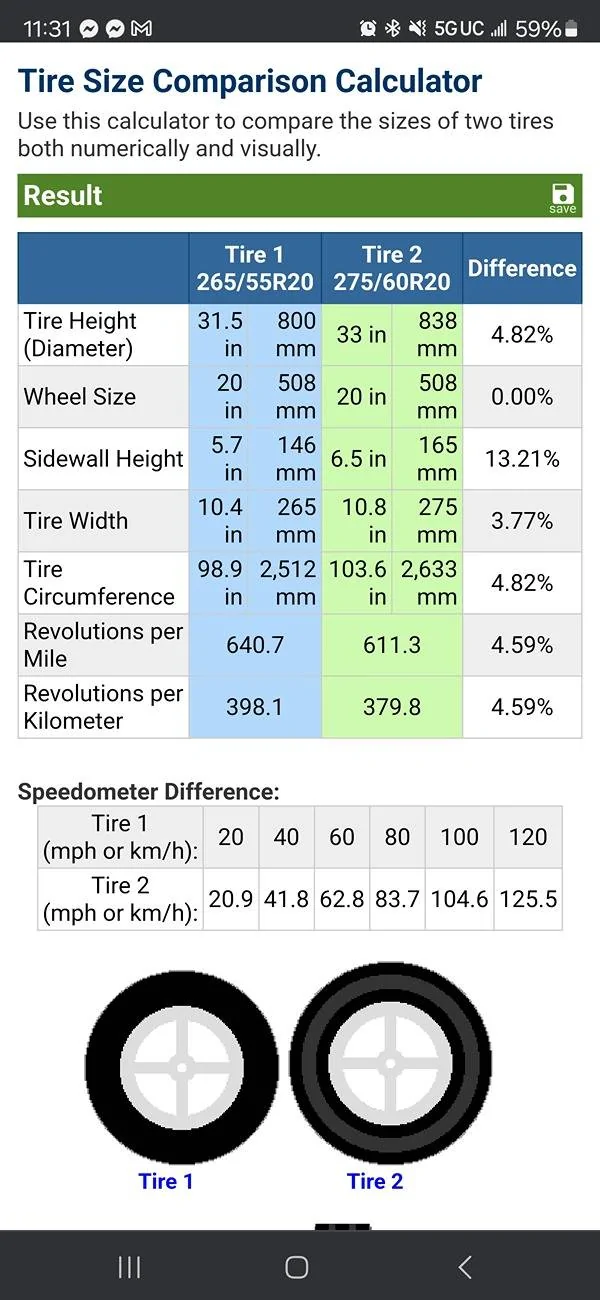

How does changing to the 275/60/20 size affect the speedometer & odometer?
Is it possible to correct the speedo/odo with OBD? If not, it's going to affect the ABS and transmission shift points and may be other things too.
