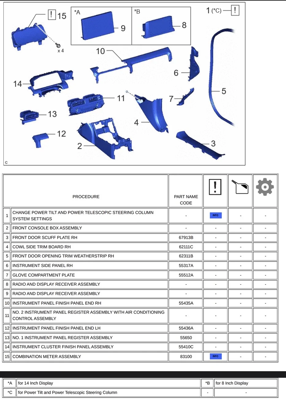

You removed your cluster in 15 minutes? Which trim pieces did you remove? Someone posted earlier in the thread that you had to remove the majority of the interior so I was hoping we could help the OP. Thanks,

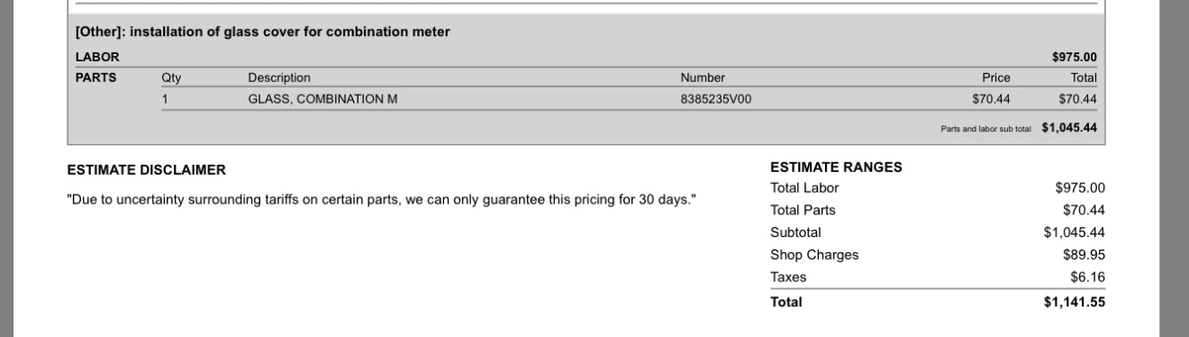

You are correct, it’s not the arm rest it’s the assembly around the shifter, #2 “console box assembly” is required for removal. Here is also the quote from Toyota to do the replacement.

Please elaborate on this, diagram shown earlier shows lots of work to remove it
Remove the head unit
Remove the long trim piece
Lower the steeringwheel
Remove the left air vent
Remove cluster
Remove cluster

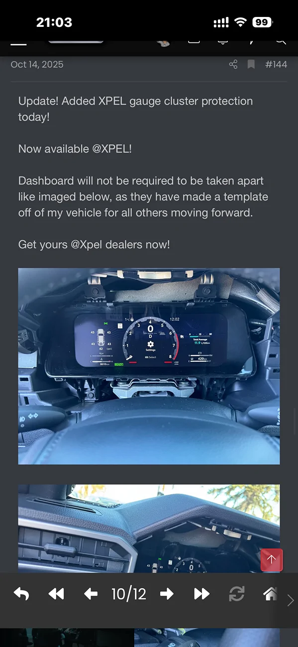

#144 of my build page
Cluster

Seen your build, it’s great. Not doubting you. Just saying some of us are more mechanically inclined than others, and I am fairly handy.
it is not as complicated as the diagram trust me.
