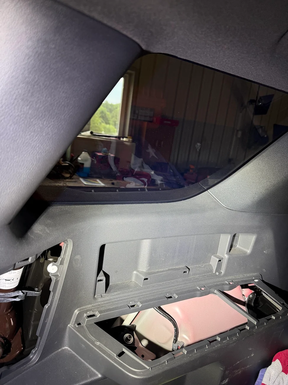

Looking to get access to the plastic under this window. Does anyone have any tips for pulling this panel underneath the window? I want to add some lights and run wire to it, so if I can have access to it, it would be helpful. Thanks.

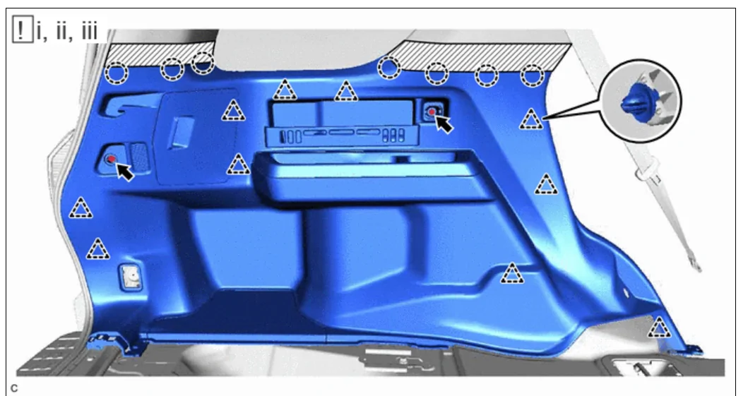

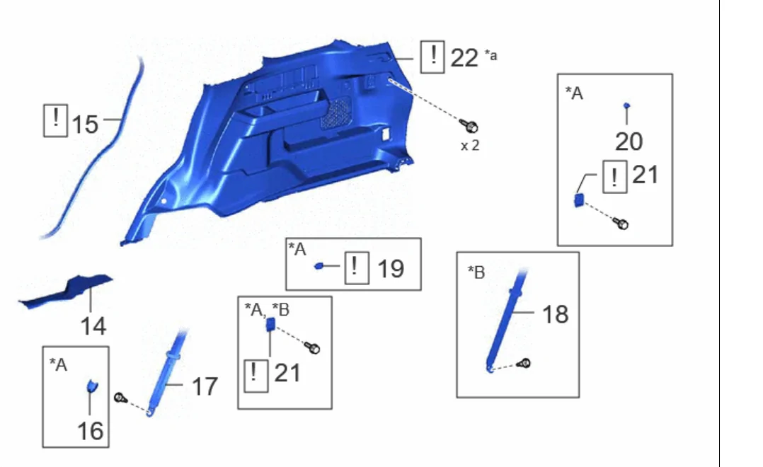

techinfo.toyota.com look up audio/visual and 'luggage speaker'
it has all the details on removal and installation of rh panel,
lh will be almost identical
it is called DECK TRIM SIDE PANEL ASSEMBLY
there is far more info and specific steps than
I can paste here. that Molle panel install guide
is pretty good too
