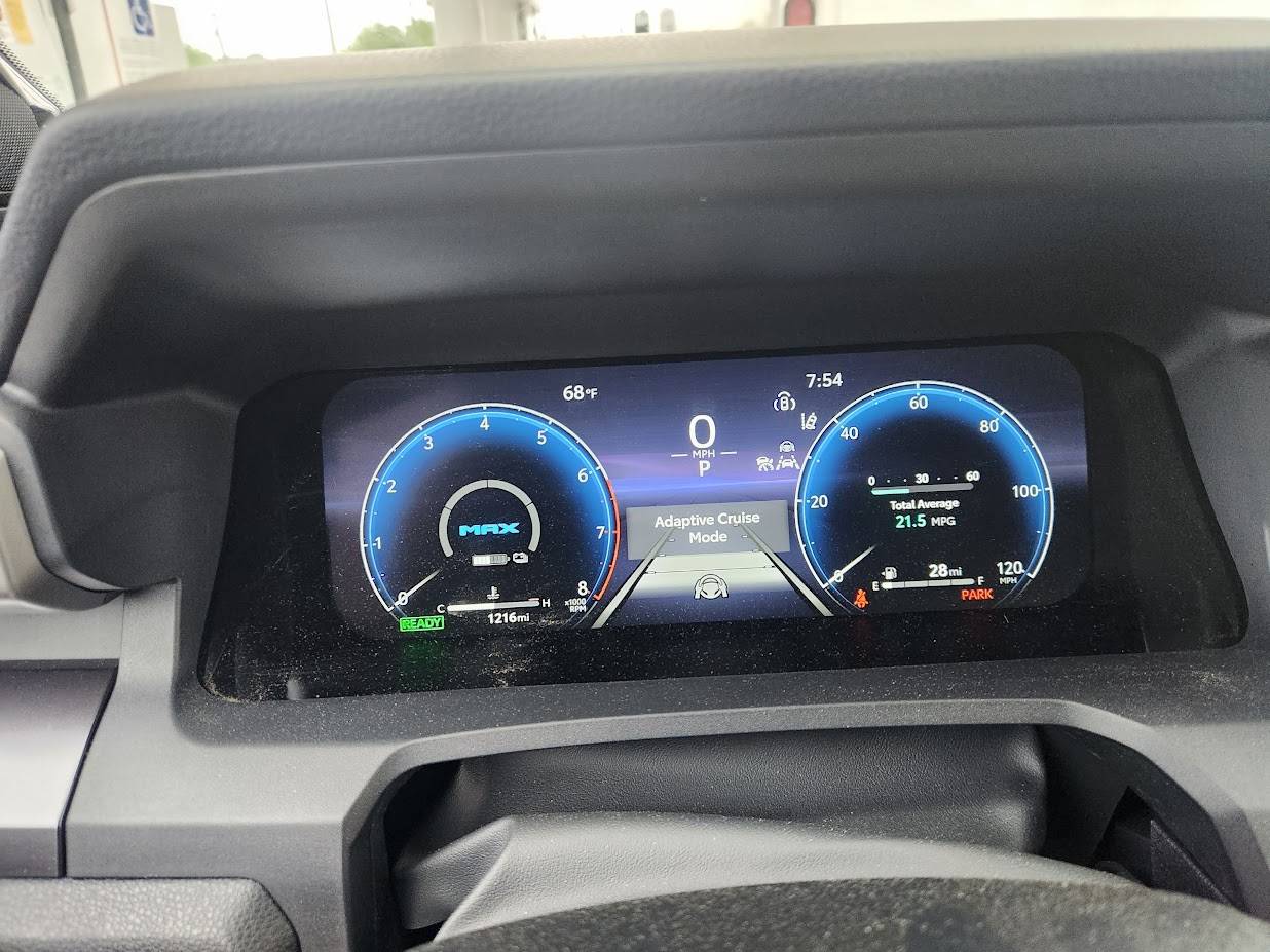

Serious question: Where the heck is the "fuel light" indicating you are low? Here is a photo of my dash before a recent fill-up. It clearly shows 28 miles to go with fuel gauge at about 1/10th of a tank.
2025 Toyota 4runner Gas Gauge and Low Gas indicator Accurate? 20250627_075422
And here is some real data (last two rows) that can be extrapolated to show that at "empty'" (0 miles to go) you could expect there to be about 2 gallons left in the 19 gallon tank. (The "actual" distance to go is calculated as (19-fuel added) * Tank MPG.

But seriously, where is the "light"? (I am fully prepared to be embarrassed at my ignorance and say "D'oh")

Indicates that remaining fuel is approximately 2.8 gal. (10.8 L, 2.3 Imp. gal.) or less Refuel the vehicle. this is on page583 of owners manual
MikeD
Jun 4, 2025
42
Thanks. The warning lights and indicators section (page 82 in my manual) shows the fuel indicator in the same spot as in the photo I posted - lower right above the fuel gauge. But for me that indicator is always there - with an arrow showing that the fuel tank door is on the drivers side. Perhaps that indicator changes color when the distance to empty equates to 2.8 gallons and I just haven't gotten there? I.e., in the 2nd to last row on my table if I'd gone 3 more miles before filling up would the light would have changed to red or amber? (Note that I put just under 16.1 Gal in on that fill and 16.2 would be 2.8 left in 19 gallon tank). I know this is a bit silly and I can easily find out by getting the miles to go indicator under 25... So thanks in advance for "illuminating" me.
Also - I think my question, the data I provided, and k9hiken's quote of the manual (2.8 gallons left) addresses fairly completely the OP question. (And if the light really is coming on at 6 gallons left there IS a problem)
