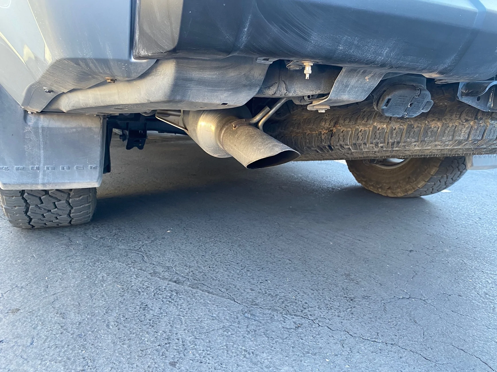

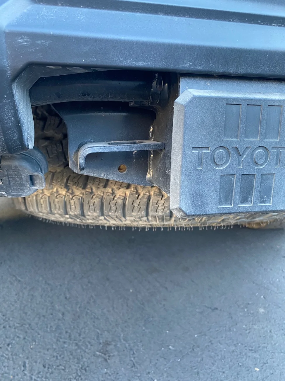

The shop mounted the valves on the bottom surface of the bumper (I’ll post a pic later today). There’s another spot near the hitch that looked promising and I’ll post that pic too. All in all I’m pleased with the performance, and the fact that it’ll work with aftermarket lift kits (future upgrade) is a bonus as well.

Pic one is an option. There’s two pre-drilled holes on either side of hitch. Pic two is my set up, left side shown
