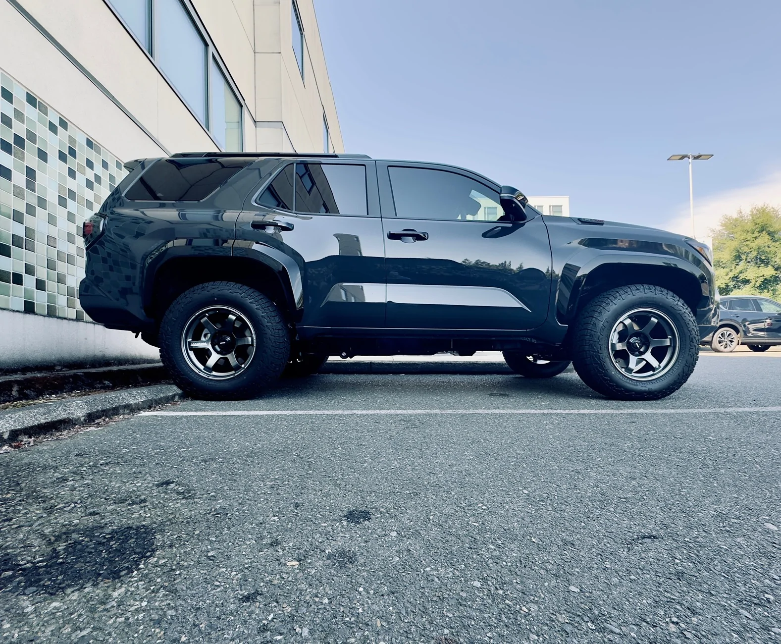

Great choice! Went with TE37 in gunmetal 18x9 offset 0 with stock tires. Definitely PPF the rear flares and bottom of doors. Otherwise expect those areas to be sandblasted by rocks.

I love it! I was looking at these but I was concerned about the 0 offset and rub. Are you planning on upgrading the tires? Looks great as it is tbh.

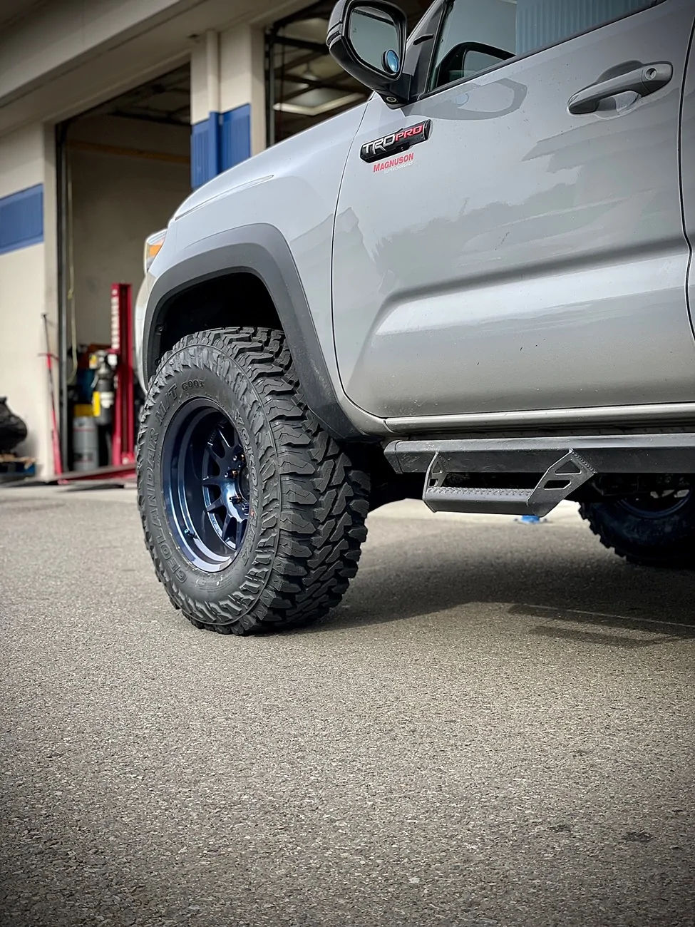

Thx! Nah… I went down that road before with prior builds. What you gain in additional trail clearance is not worth what you sacrifice. Acceleration, braking, handling, and MPG. Stock tires with 50 lb total rotational weight reduction with lighter wheels gains in all 3 areas mentioned before. 18x9 with 0 offset with stock 265’s has no rubbing issues whatsoever.
My Tacoma on bigger mud terrains below.
