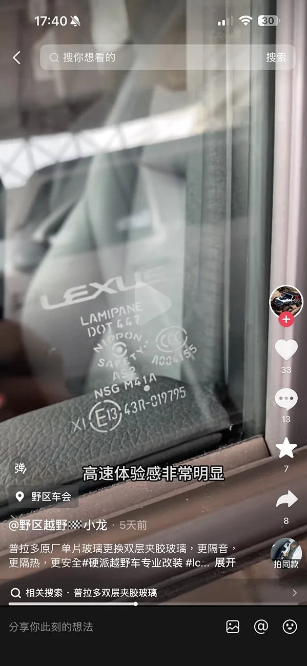

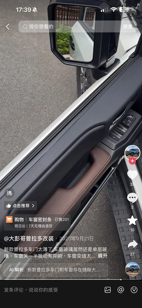

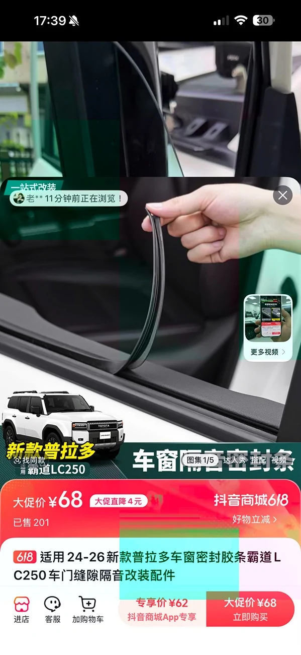

Upon checking CN Tiktok (as Toyota has factories in China making LC250), basically two potential solutions:
1. add rubber gasket to reduce the gap
2. upgrade the window glass to Lexus double layer type; it is thicker so less room for vibration/ resonance.
