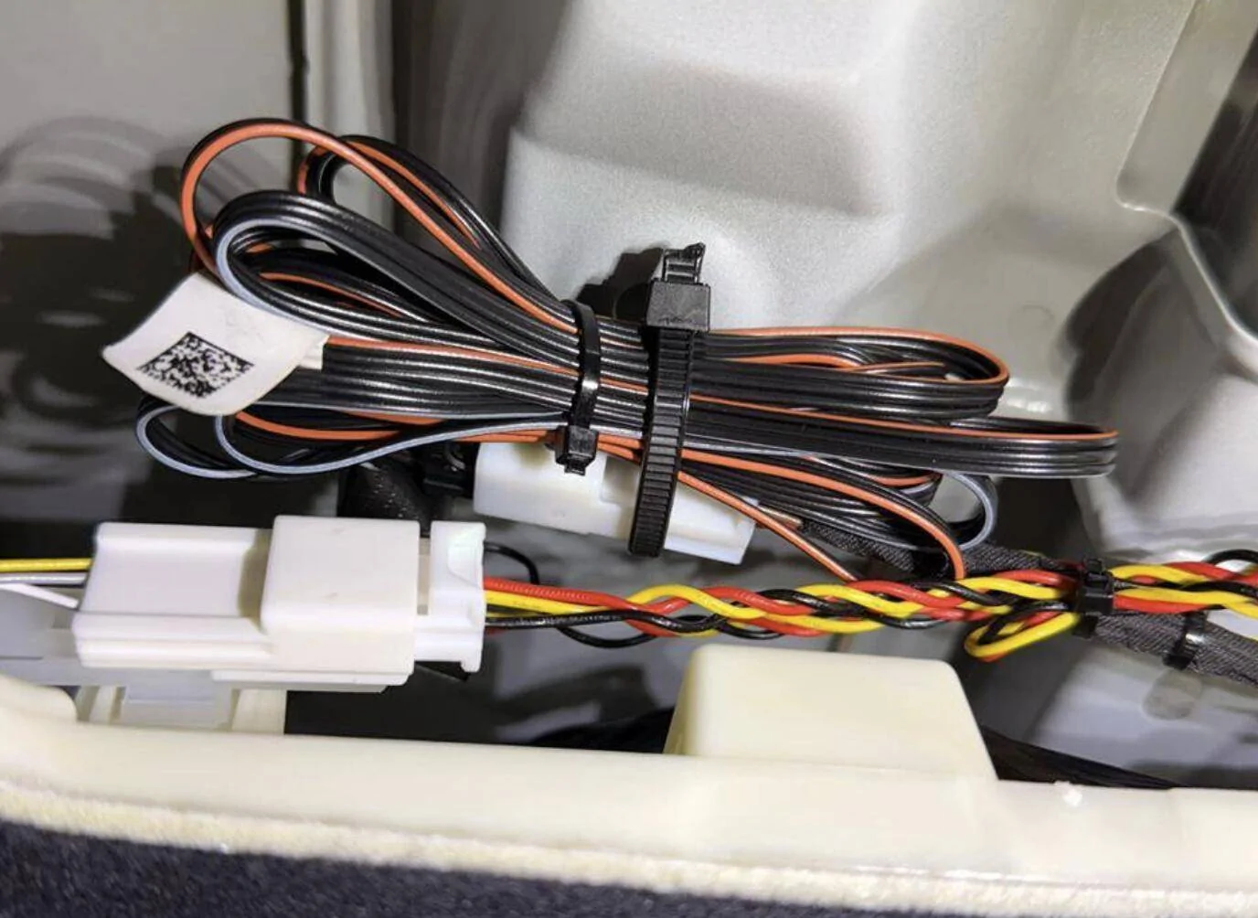

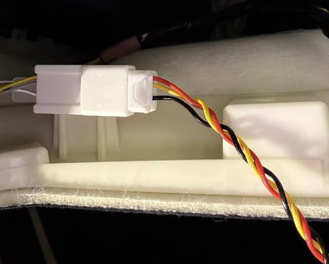

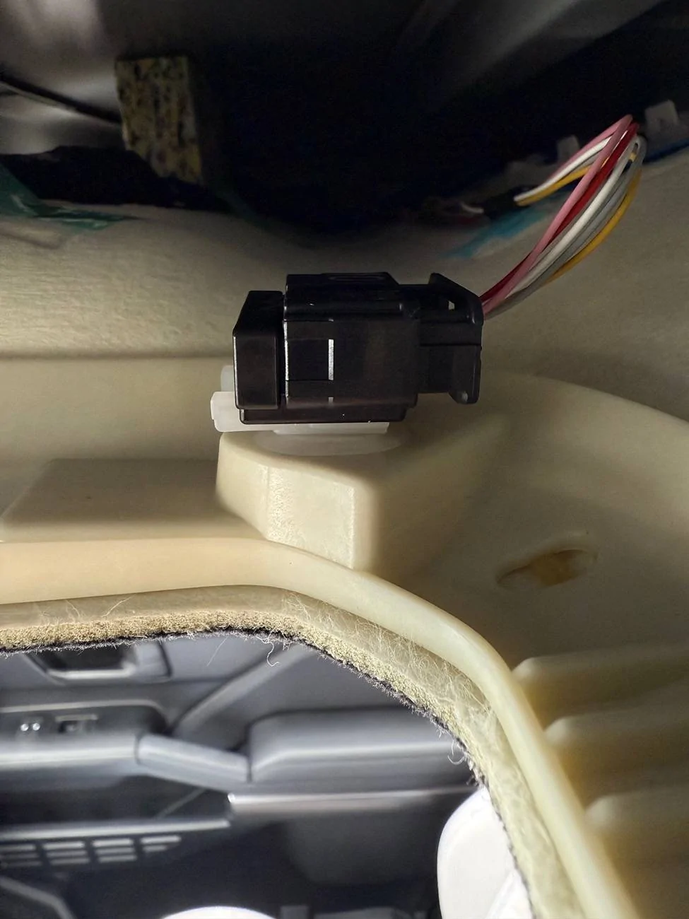

Found this cabe in my SR5 that seems to be plugged into nothing above the overhead console. That socket doesn't have any cables attached to it (Just seems to be mounted to the liner with a plastic clip as to not dangle around).
Could this be for digital rear view mirror? Any ideas?
(This is not the OEM dashcam connector, that is there too on the other side).

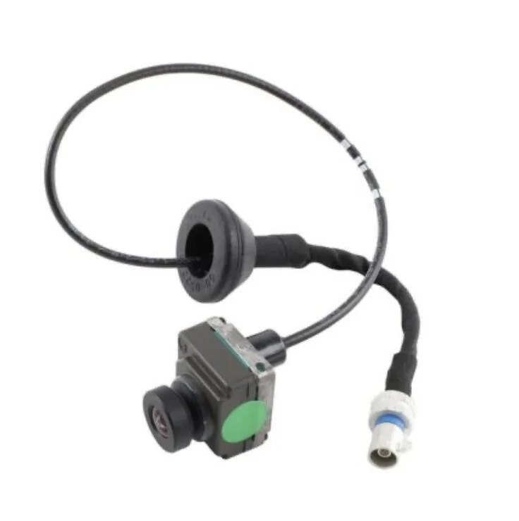

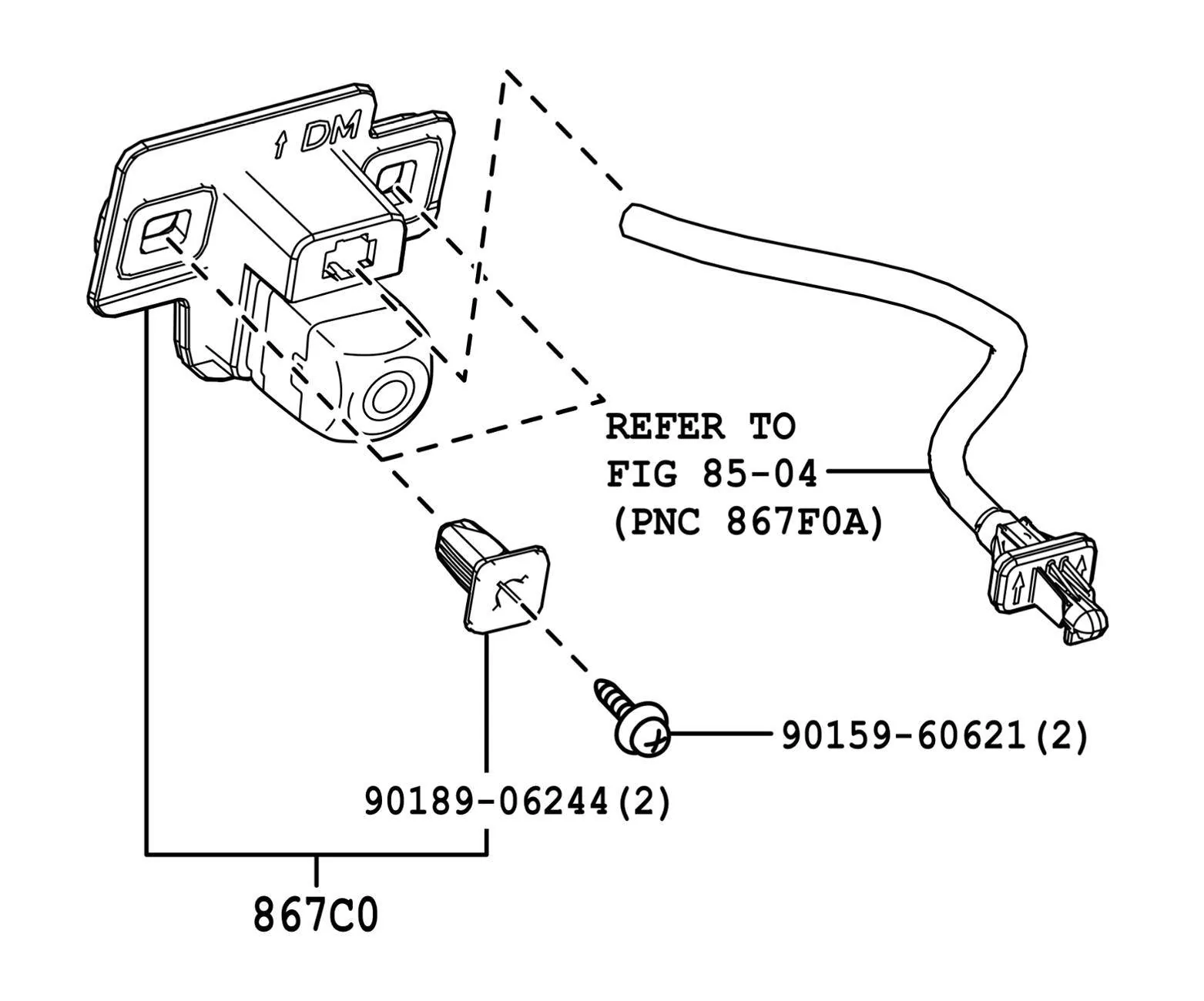

This is the original camera assembly.

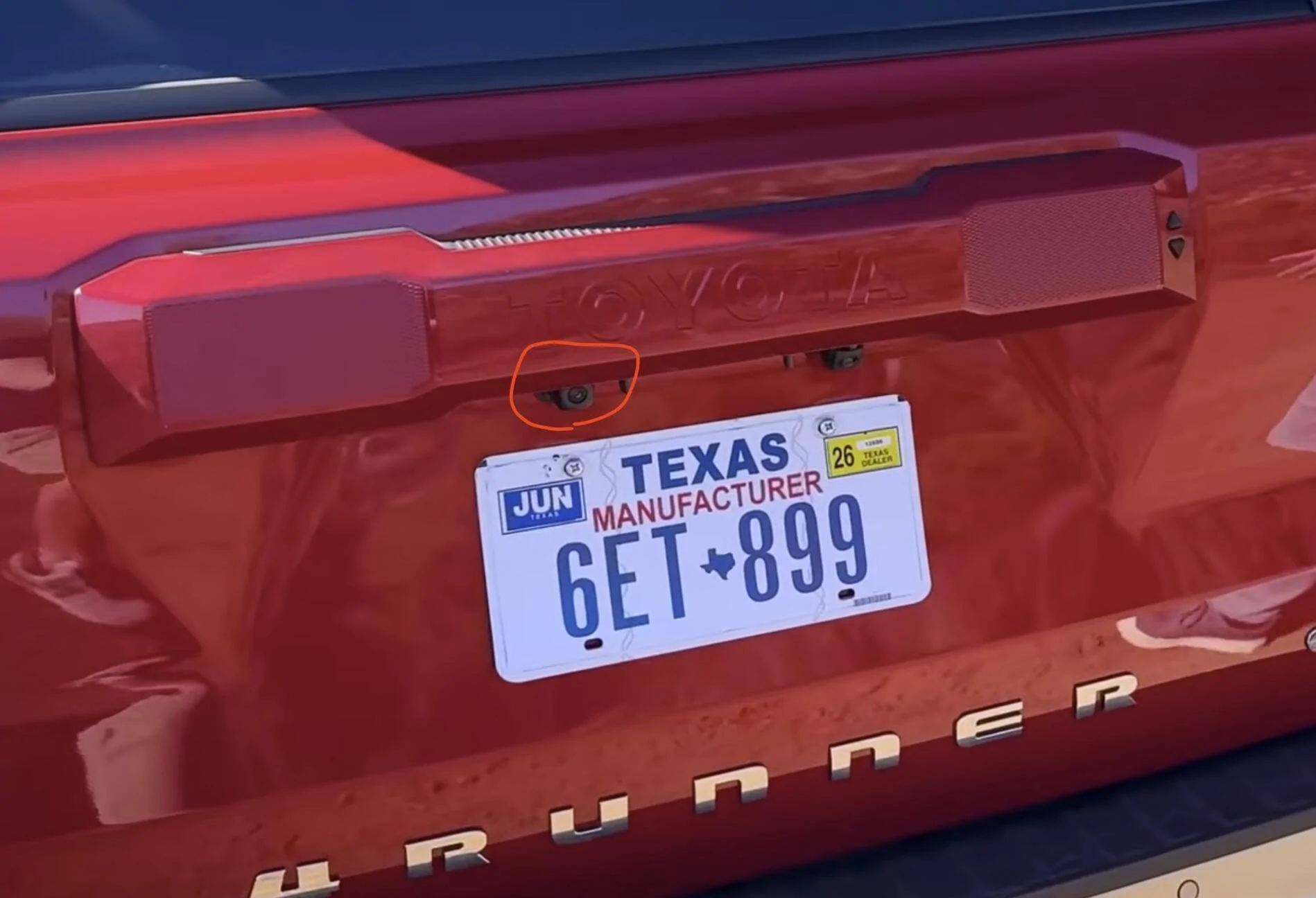

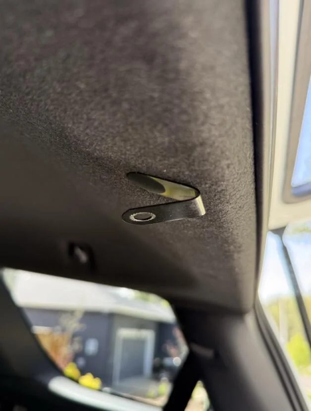

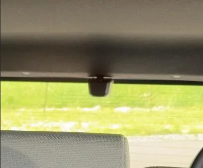

In the limited's you can see the camera here.
2025 4runner 6th gen Retrofitting OEM digital rearview mirror? 1745607131055-1y

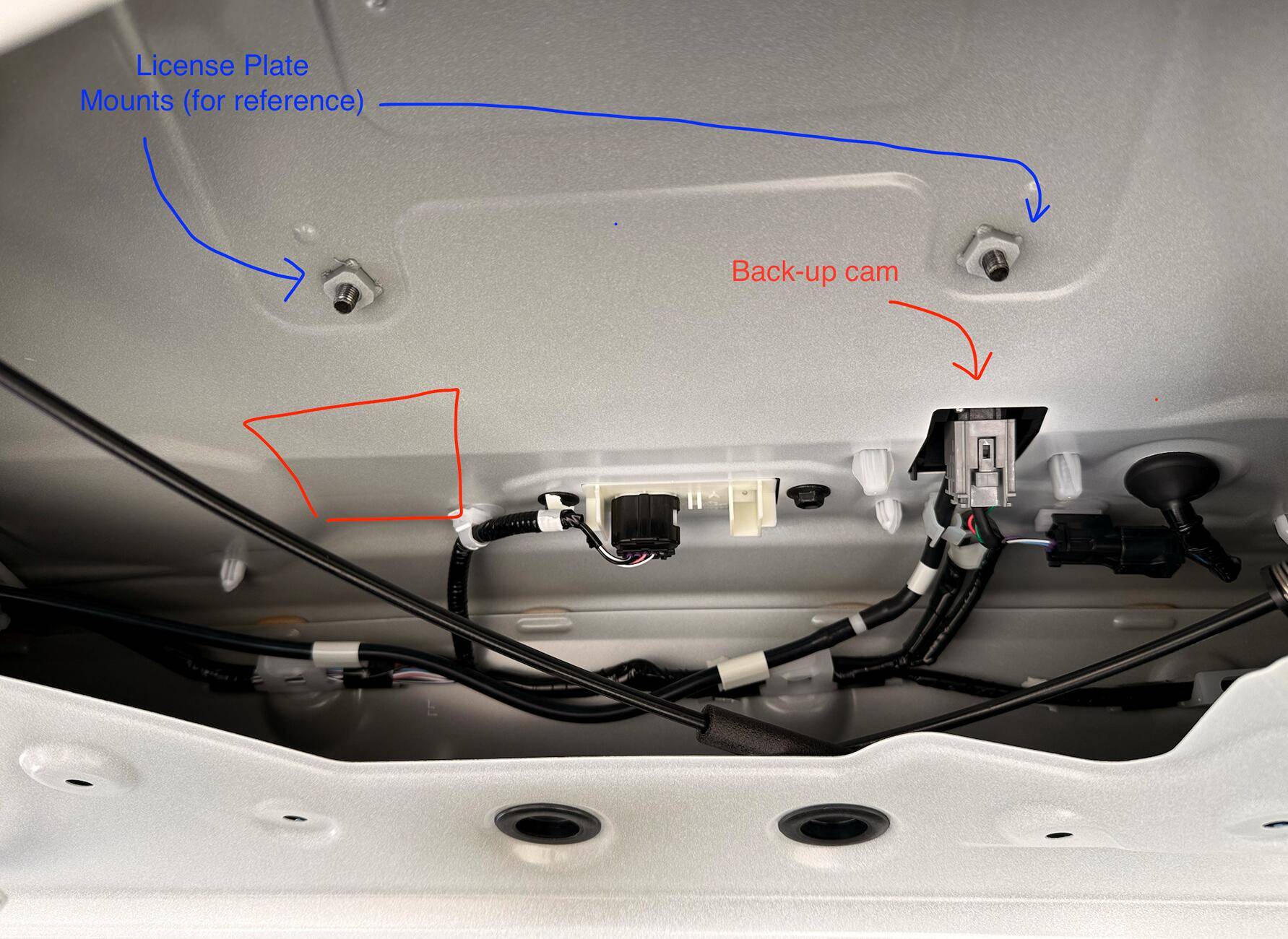

I took my back panel apart and I don't see even a hole there or anything....
2025 4runner 6th gen Retrofitting OEM digital rearview mirror? 1745607427690-je
I have not seen a higher trim (premium, limited, etc.) door taken apart but I would expect a hole here and some clips mounting holes too.
Did not see any obvious connectors for this either.
OEM retrofit seems like a dead end. (Which is a bit surprising, since I expected that this is an option you might be able to have the dealer install afterwards as the "tow package").

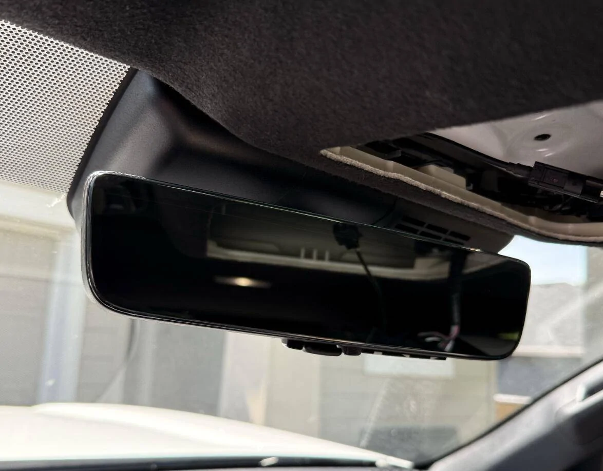

Progress Update:

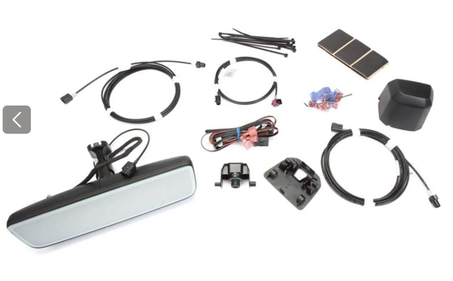

If I am not mistaken, Gentex is the OEM manufacture of Toyota's mirror.
I've order the GENFDM3LN...
They basically make a "Aftermarket" version of the mirror that they (very likely) also make for Toyota.
2025 4runner 6th gen Retrofitting OEM digital rearview mirror? 1745608637988-1n

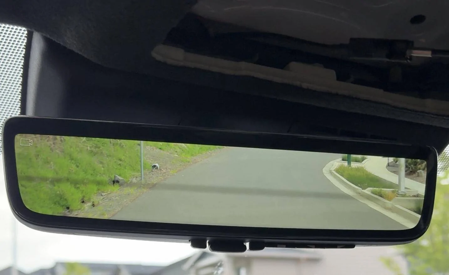

I've got the mirror installed and it basically looks flawless
2025 4runner 6th gen Retrofitting OEM digital rearview mirror? 1745608932026-q7
I'd say it is the exact same mirror just with more 'after market' connectors.
No homelink though :/
(hoping to get my garage door opener mapped to one of the poverty switches).

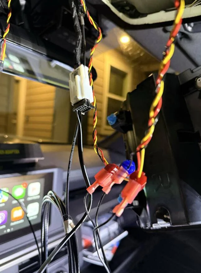

Connecting the Mirror
My goal was to not mess or modify any of the original parts or wire harnesses so I also ordered the Dongar pro and tapped into the 12 V (ignition) from that adapter. I am planning on adding a dash cam too so it worked out.
You could also just top into the wires that go to that Toyota OEM dash connector.

Works well of far...
That line is there because I don't have the angle of the camera sitting well. More on that later.
2025 4runner 6th gen Retrofitting OEM digital rearview mirror? 1745609439410-rj

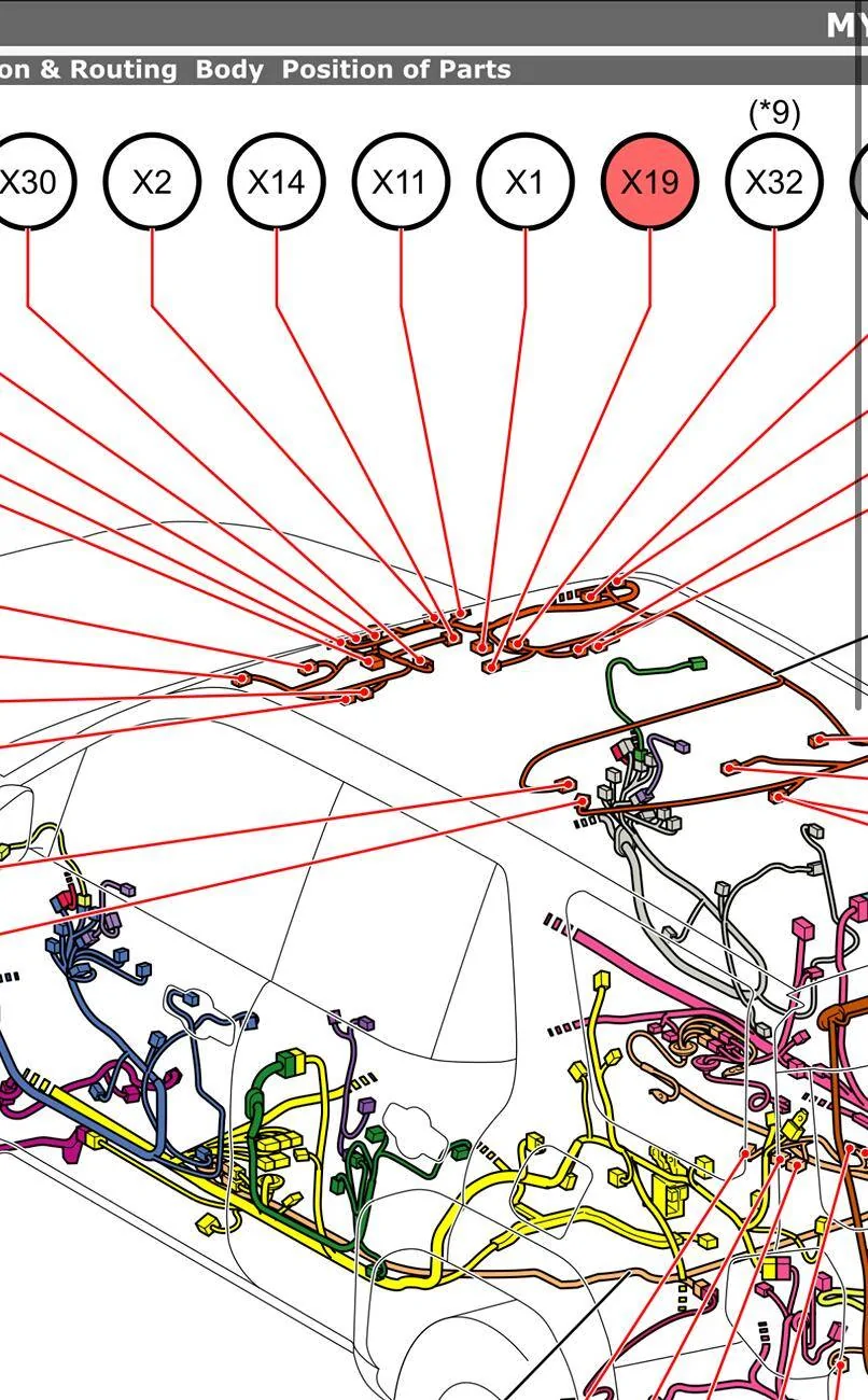

If the strange connector you found is #X19 in this diagram, Toyota says it’s a noise cancellation microphone? There's also a harness in that area for the sunroof ECU, and just some other junction connector?‍♂
