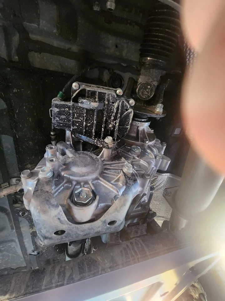

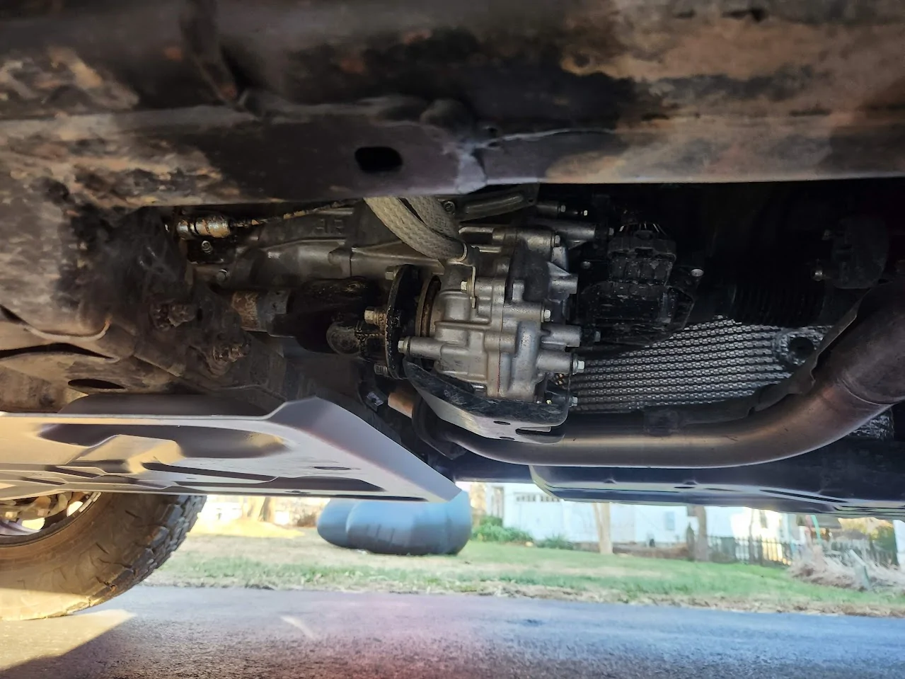

I got to wondering about your question and so took a photo of my actual transfer case (on TRD ORP hybrid) which has its own little skid. I don't THINK that is what you are referring to but it does highlight that Toyota refers to the "transmission/transfer case" skid plate both ways. Here are the two part numbers you referenced in OP from one vendor with the different names -and very similar but slightly different photos:>): Elmhurst PT228-35248; Elmhurst PT228-35247
I have no idea if your SR5 has this transfer case mini skid but I've seen it on TRD PRO and my ORP (see photos below)- and from this video of TRD Sport non-hybrid it seems like that mini-skid is missing 4Runner underneath- hence me wondering if that is what you are actually looking for, given the naming confusion from Toyota on the skid that fits between 2nd and 3rd frame cross bars - which is what you see in the bottom left of first photo below. )

Yes thanks for the images,
I do see the hybrid does have a difference in the step down in the transfer case plate.
Looks like in the photo the hybrid version has two significant step down areas, and the non hybrid has a very shallow step down with just one significant.
My orp comes with a front skid plate made out of some type of poly plastic, but there is no transmission plate.
I do have a small metal skid plate over the electronics area of the tail end of the transfer case near the drive shaft.
