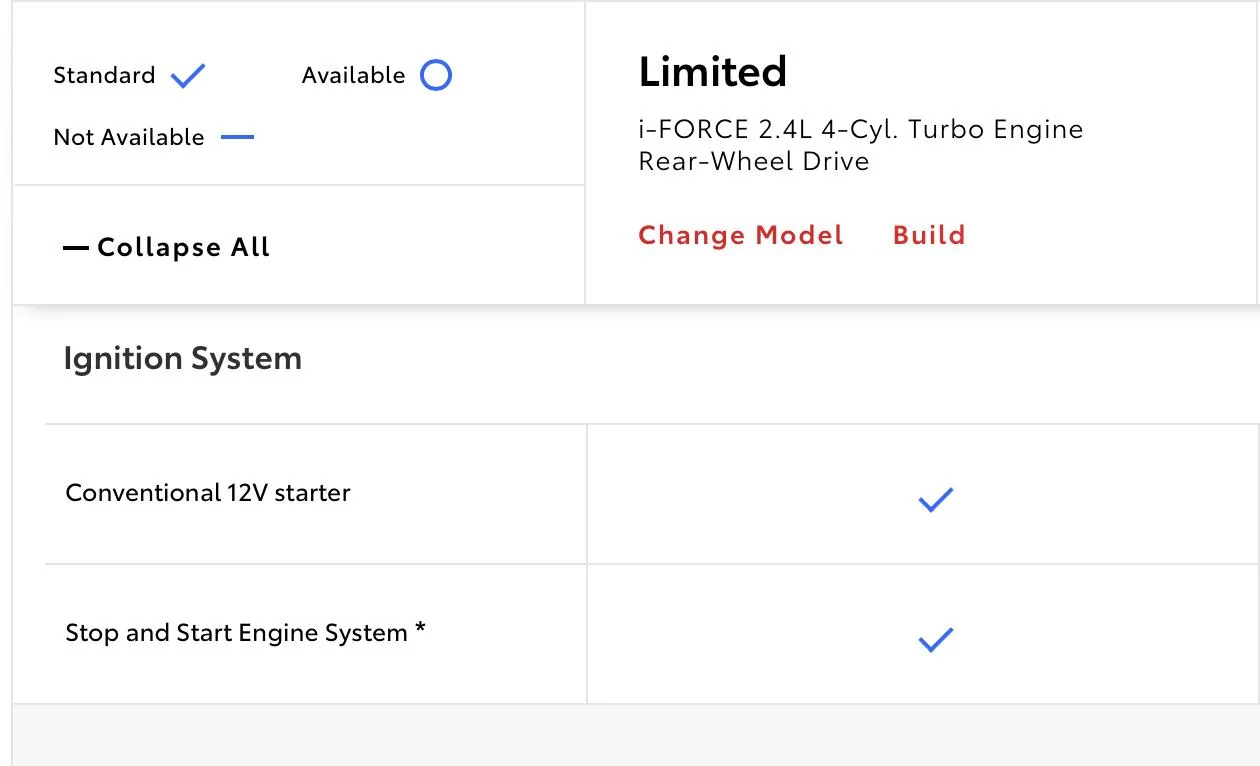

My understanding is that TRD Pro and Trailhunter will not have the start/stop feature. Anyone hear differently?
Or, is it all Hybrid runners?
As we've seen, the online specs aren't very accurate. I imagine all the hybrids have stop/start. The manual makes reference to this as well.

Nope. I don't know why people think implementing Auto Start-stop (ASS) was just a simple matter of adding a 0 mph detector and shutting off the engine and calling it done. There's way more to it than that. It required some degree of redesign of the starter system, the voltage regulation, the battery, the HVAC system on both the heating and cooling sides, the automatic transmission, the brakes, and cam/crank timing to make restart instantaneous. And a lot of computer monitoring of various sensors for all the situations where the ASS system will either not be enabled (intentionally) or will automatically start the engine if sensor readings drop below a threshold.
Anything that requires pumps, hydraulic pressure, or vacuum relies on engine power (i.e. power brakes, transmission, heater, AC, but not power steering since that is electric now) and it takes a second or two after restarting a non-ASS system for those to build up again. That's too long and it needs to be instantaneous for ASS.
Specific to the starter, it had to be re-engineered for much higher longevity** and to account for the scenario where you're rolling to a stop at a red light at just the instant the engine is about to stop, the light turns green and you hit the gas (if you've ever turned the key on while a car was already running and heard that awful noise, that's essentially the scenario). For this they designed a new tandem starter with 2 solenoids vs conventional starter. It's more complicated than that but that's the main idea.
** Specific to Toyota (this is taken from a video by Car Care Nut, a long-time Toyota mechanic, explaining Toyota's ASS), the new starter for ASS systems is designed for 384,000 stop-start events (to put that into perspective, 365 days per year x 20 years x 50 start/stops per day = 365,000 so it ought to last over 20 years even under pretty intensive daily driving). Also, the computer counts all start-stop events over time and displays a message to replace the starter when it hits the longevity threshold and it disables start-stop until that is done. With non-ASS cars, it's just a crap shoot. So you don't have to guess at when it's time to replace it.
Long story short, there's no justifiable worry about the starter.

The hybrid motor does the engine starting almost all of the time. The starter on the hybrid is only there essentially as a backup (very cold temps, for example, where the small starter motor has a smaller electrical load requirement than the larger hybrid motor).
