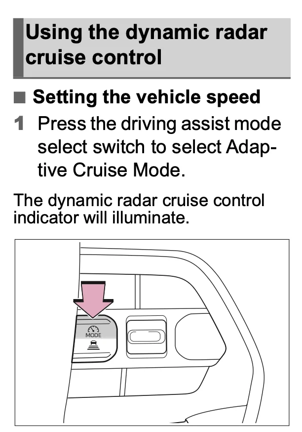

If you have Dynamic Radar Cruise mode engaged which I think you do and you are approaching traffic in your lane your speed will drop to keep the appropriate distance between you and the guy in front of you. This is totally normal. Click the toggle on the right hand side of the steering wheel to get to normal Cruise mode and this behavior will go away.
2025 2026 4runner 6th gen Cruise Control not maintaining set speed Screenshot 2026-07-24 at 10.46.36 AM
I know what you’re talking about, however, it is not engaged at the time in the video. You can see that it doesn’t sense a car in front of me but it’s still decelerating. I’ve also tried with normal cruise control, and it does the same thing not being able to maintain speed it just decelerates.

it looks engages. you can tell by the two Blue lines between green lines.
I would disagree we can see there is nothing being sensed. We can see what you see but you have the center area with mic open so we can’t see what the cruise control is seeing.
Agreed, the two blue lines indicate that radar mode is active.
Shoot you might right, I was expecting to see a vehicle but the blue lines also mean it is engaged. However, the car is not putting any pressure on the brakes, it just decelerates like normal when you take your foot off the gas.

does it do it during normal cruise control mode?
just push up on the toggle switch twice to switch to normal cruise instead of radar cruise.
i never run radar cruise control. everytime i start the vehicle i switch to normal cruise control mode even if dont even use it on that trip.
Yeah tested with both, here’s another video of the issue and both modes:
